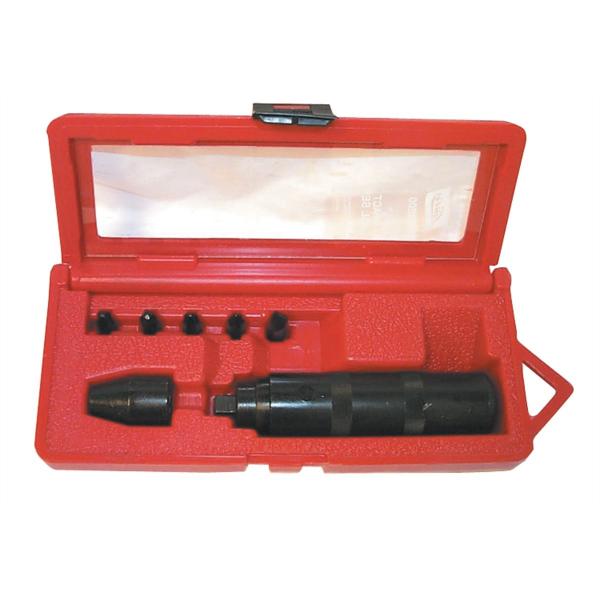

I bought one from Harbor freight, electric, been happy with it. I abandoned battery powered anything since I am a weekend guy and I never have a battery charged when I need it. I will say my kids bought me this : 1/2" Hand Impact Tool - Lisle 30000 and it has really been helpful.
I have one of these hand impact drivers, but hadn't equated this with an impact gun, oops. I find the hand impact driver invaluable for those little brake disc screws! Happy to give my hub hearing a go with it, see what it can do.

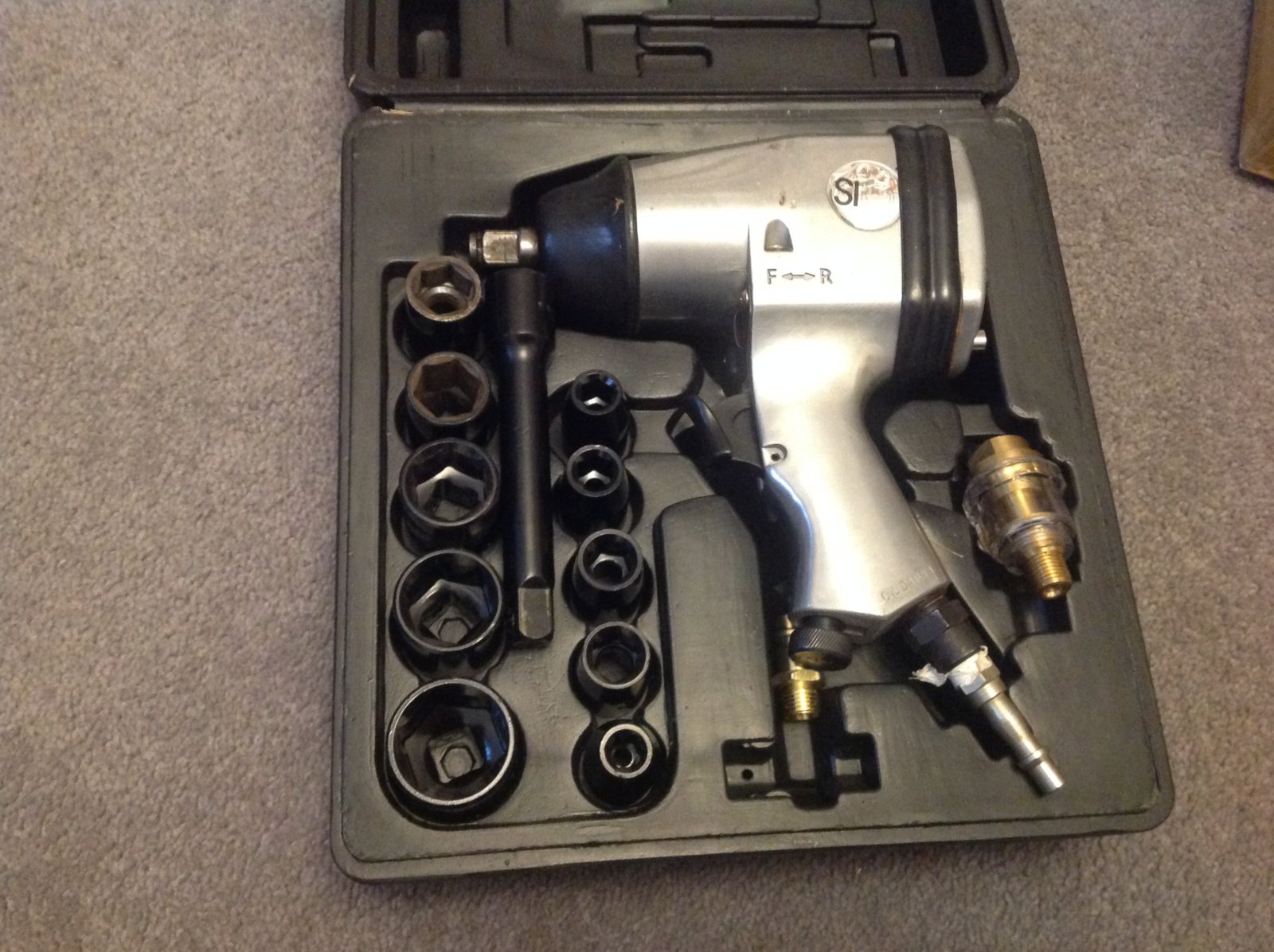

...as the air gun I've bought is not up to the job!!
Actually, I suspect the air gun is fine, but my compressor is just not man enough to supply enough air. IMG_0949.JPG
I bought this SIP gun lightly used from eBay, and it will whizz a wheel nut off, but only just. I've had to use a very short air line, and my compressor can only run it for a few seconds, so it's not the convenient option I'd hoped for...
It is spec'd to run at 90psi, and my compressor does 110, but quickly falls off to 70-80 as the receiver is not large.
Think I will try a corded electric gun next. There's a Draper gun rated at 480Nm
