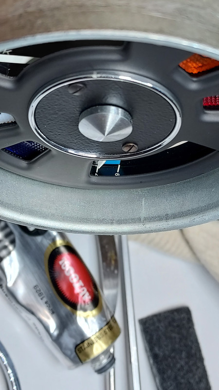

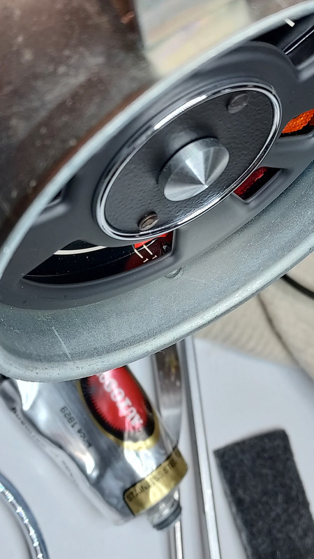

Hi I bought a 1970 2800cs project and am new to older BMWs. I just got it running after 10+ years but concerned it might be running too hot.
1. What are the actual temperature ranges in degrees F/C that correspond to the RED zone on the BMW gauge? In the shop it’s running just under the red. (I’ve installed a temporary manual F temp gauge to check it since no idea if the cluster one is working).
2. What numbers are the normal range running temps?
3. What numbers are “worried” hot but can still drive?
4. What number and above is “stop car immediately” hot?
Much thanks!

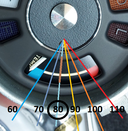

I vote clogged radiator, gauge should never, well almost never, go above 3:00.
Chris, I replaced the new (but wrong) 88 thermostat with a 71 and then bled using a technique posted. Still no go. I think youre correct about a bad radiator. See my post about cheap Champion radiators and if they fit. Thanks for your suggestions.
Concur with opinions here.
Mine always ran at about the 90 degree position marked on the photo above and never went higher. Yours should be about the same.
