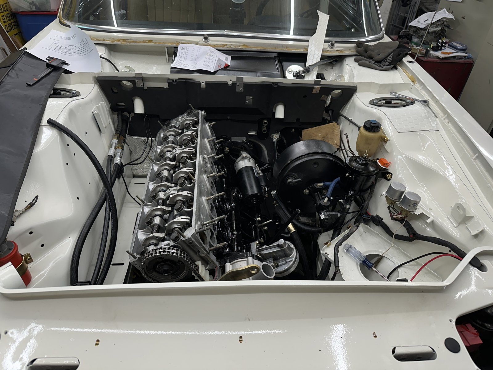

In my "winter" project that is ongoing...I did purchase from CS-Werk and did prime and paint their product.
