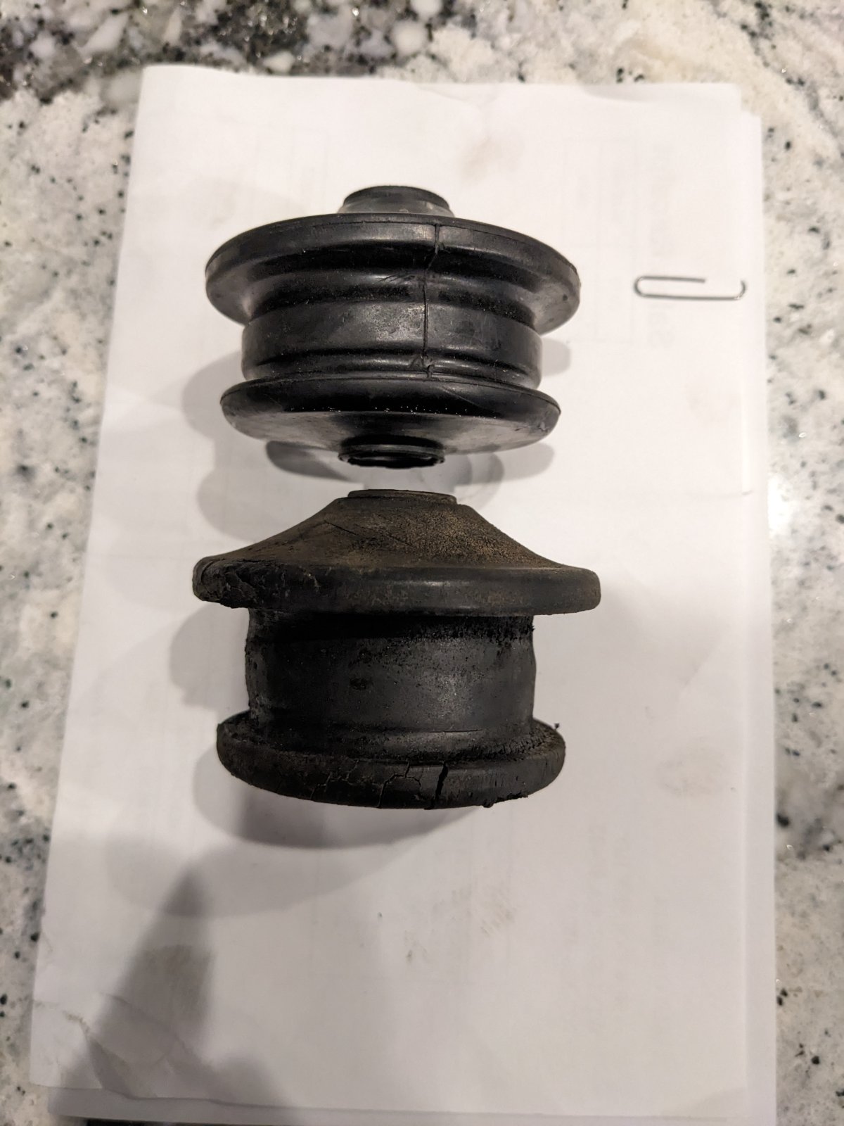

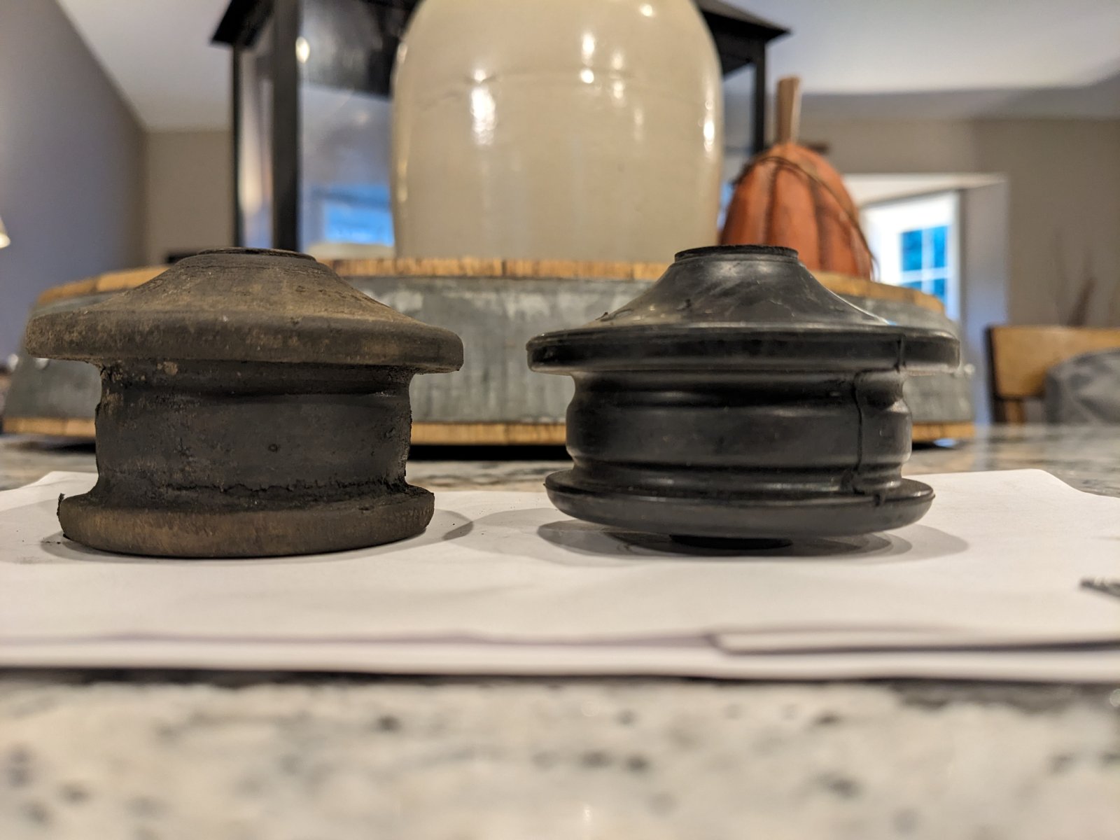

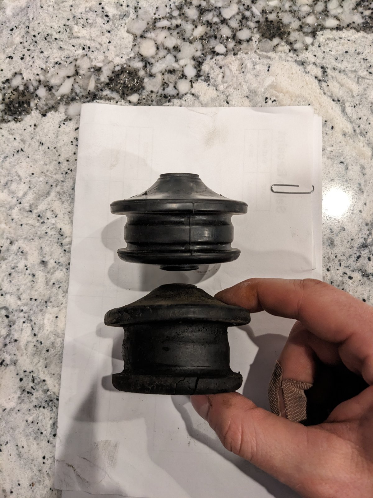

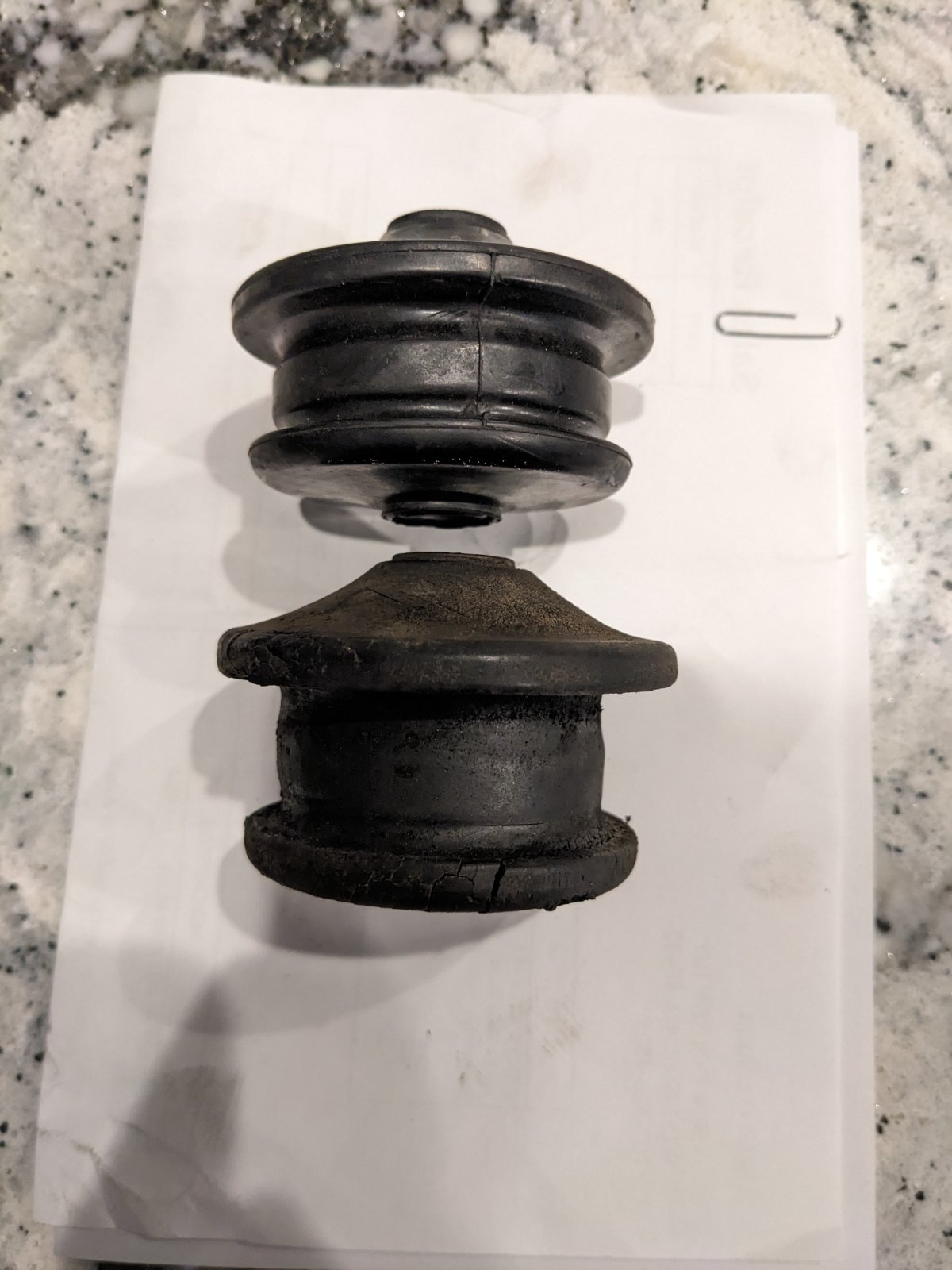

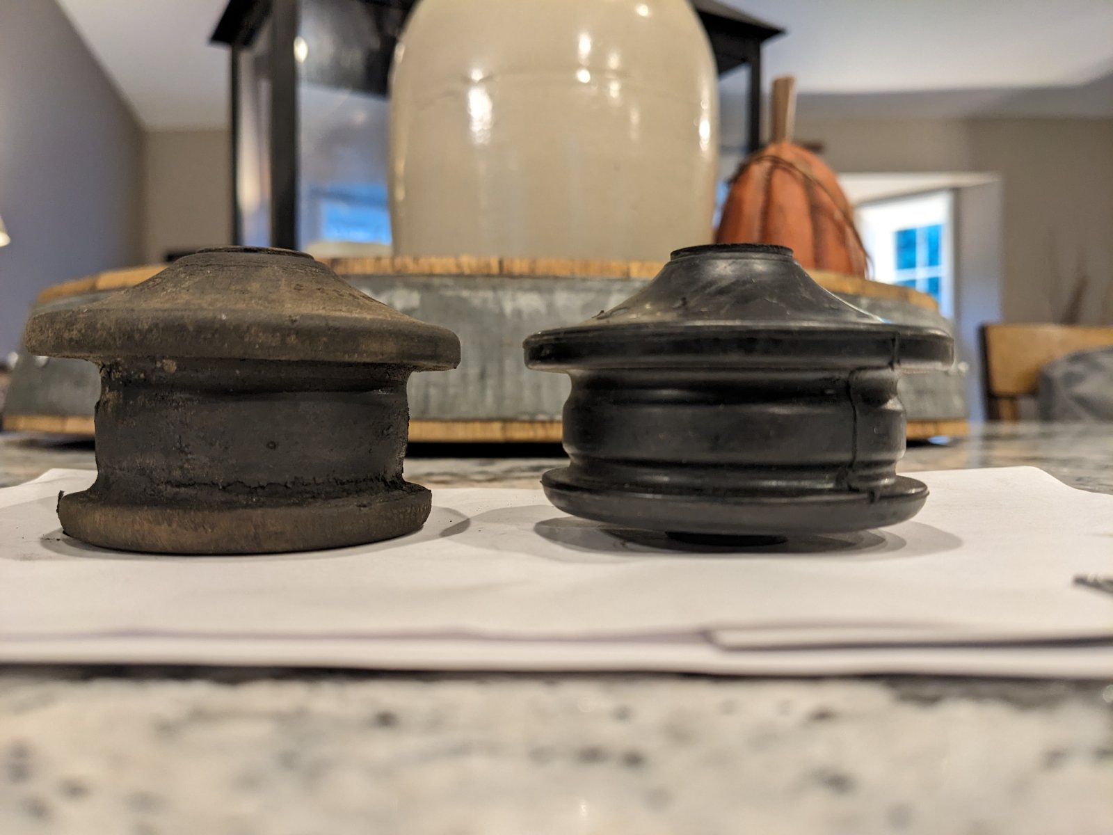

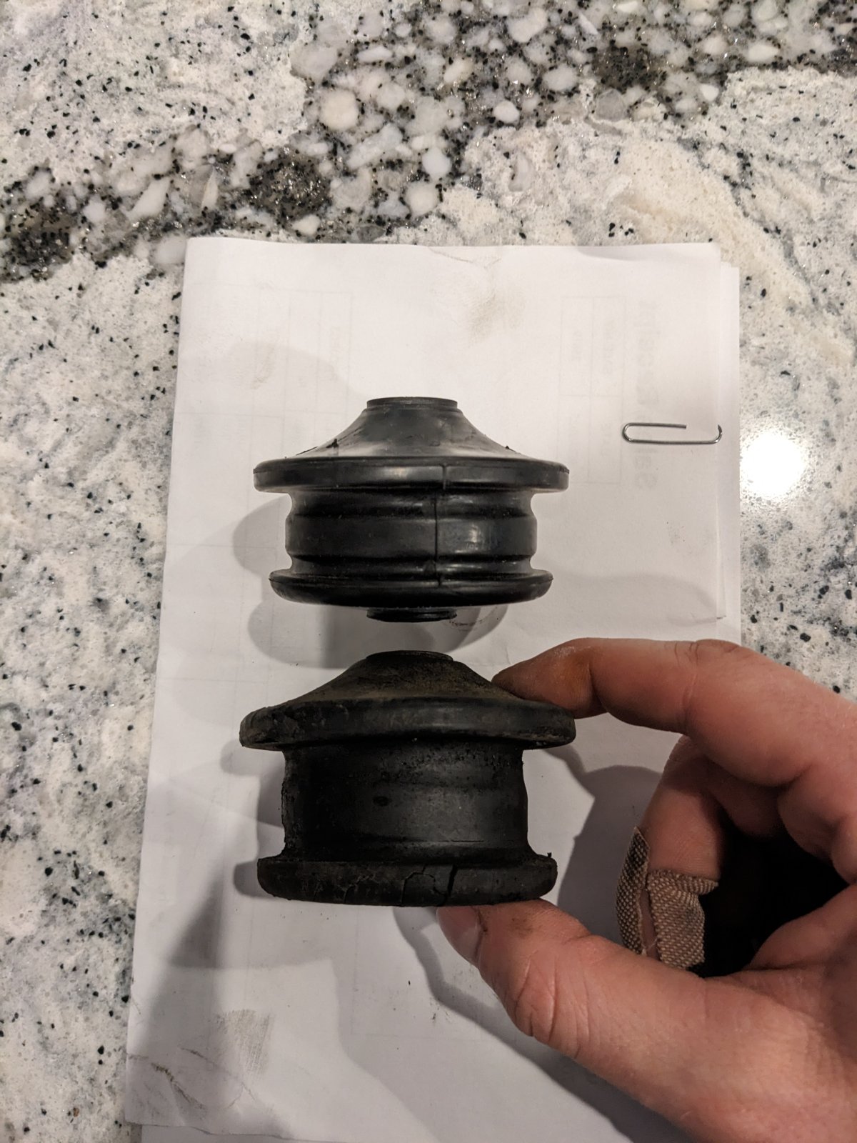

Hey folks, so have have fully disassembled the front suspension and steering components, and have pressed out all the bushings. I am ready to reassemble and press in new bushings.
Was going through all the parts I have ordered to complete the job and have a question regarding the front tension rod bushings. The ones I was sent don't seem to be the same size as the ones that were on the car. The diameter and circumference are the same but the thickness is off by a few cm.
Will these work? I ordered part number 31121123552 from an eBay seller selling NOS replacements.
Alternative bushings can be sourced from Bimmerworld for 2x the price but look like the ones I had in the car previously.

Did you buy from Lenny in Windsor?
If you did- they are correct.
That's Lenny- good guy. We buy lots from him.
Lenny is auto italia and he is in Windsor.
Got it, thanks @sfdon. I hit him up to see if he could have sent me one of the Maserati bushing sets by mistake.
If anyone else has any comments or thoughts on fitment of the replacement bushings please LMK.

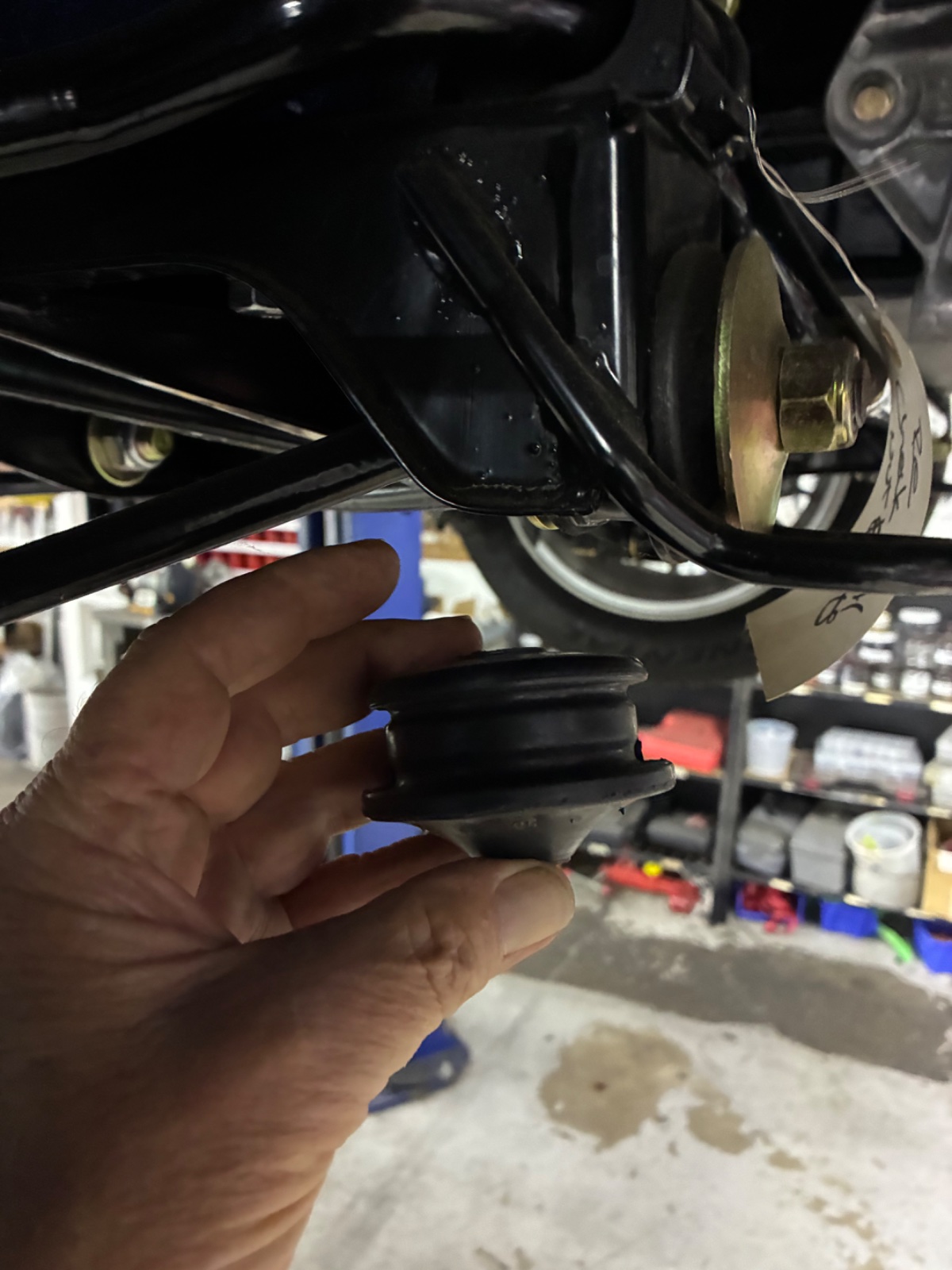

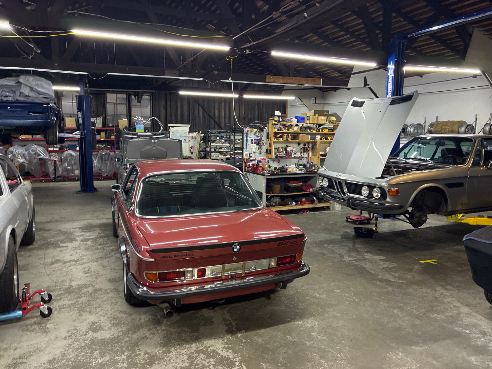

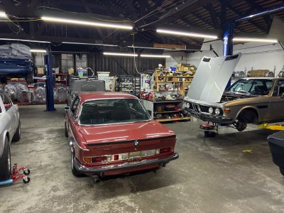

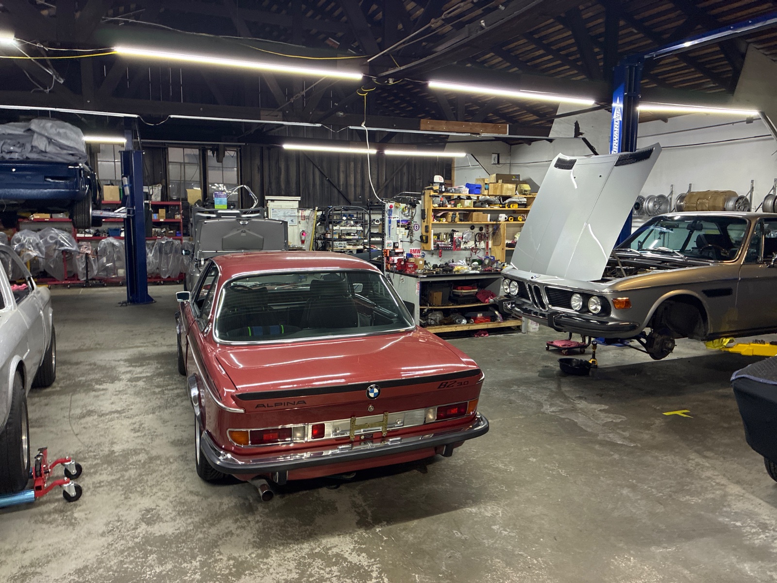

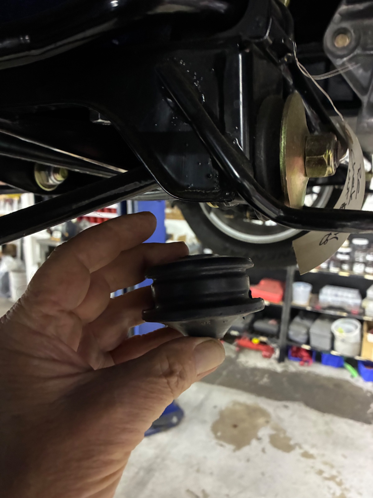

It's the correct bushing. I have a box of them here.
We install them every month.
Excellent, thanks mate! Nice looking shop you have there, and even nicer looking cars.

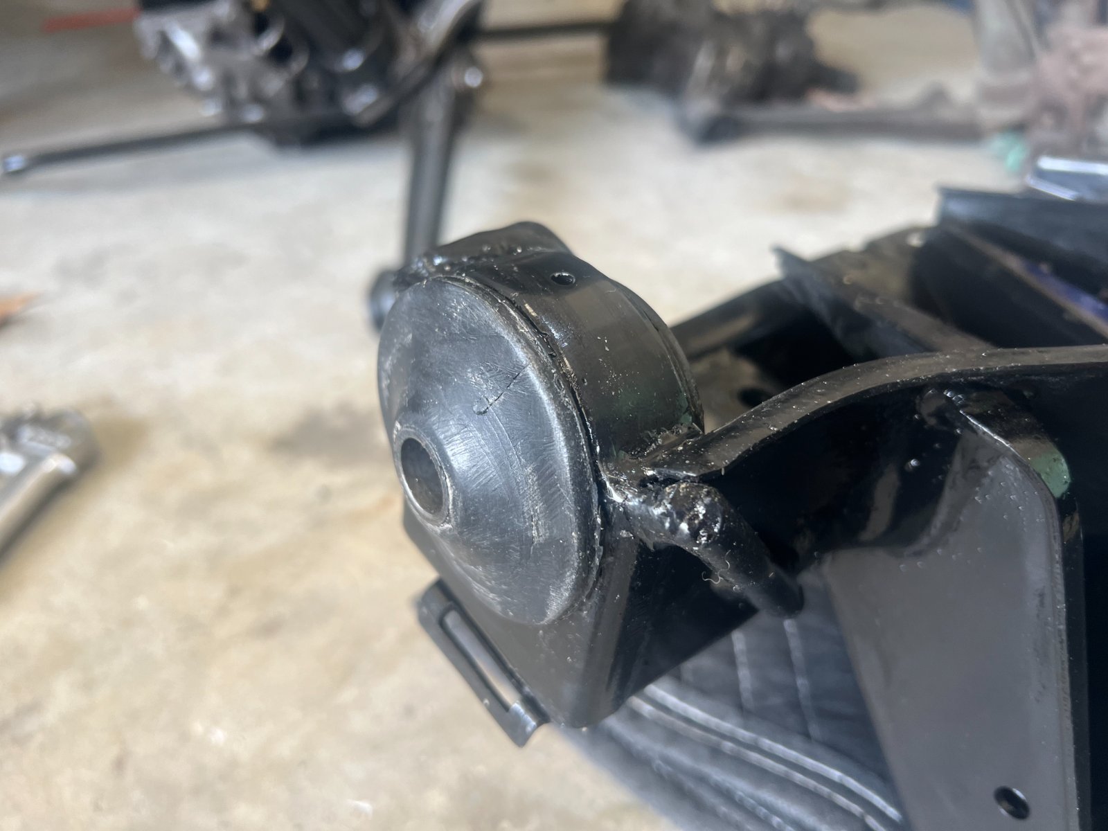

Man..I had much less fun installing mine on the garage floor..lolol. I just realized that it looks like a PO must've cut the loops off of my sub..
I think there is a source for new front tow hooks, i think US based, should you desire them to be welded back.
I can just weld some on. I welded on reinforcement straps on the lower portion of the bushing carrier, too. Such a thin piece down there. Mine was all smashed from the PO..he probably smashed the loops, too, and just cut them off..You can see the stubs...:-/
