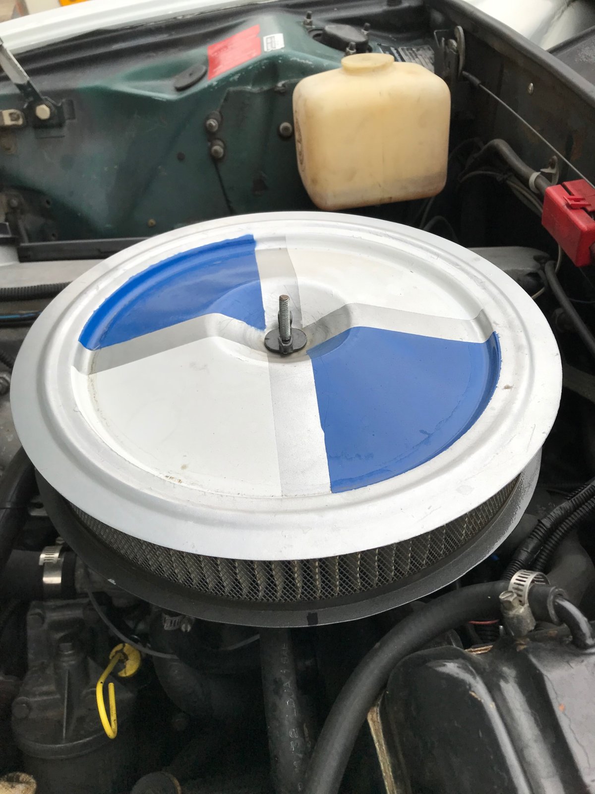

Sounds great. Are you using an enclosed air filter housing (ala something that came on the 630 CS with that carb/manifold design originally), or is it an open air filter? I'm thinking it sounds like that latter.
It's the air cleaner from a Chevy truck cut back to open the element with a roundel painted on top.
