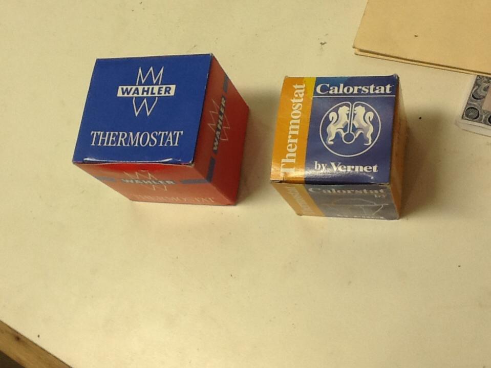

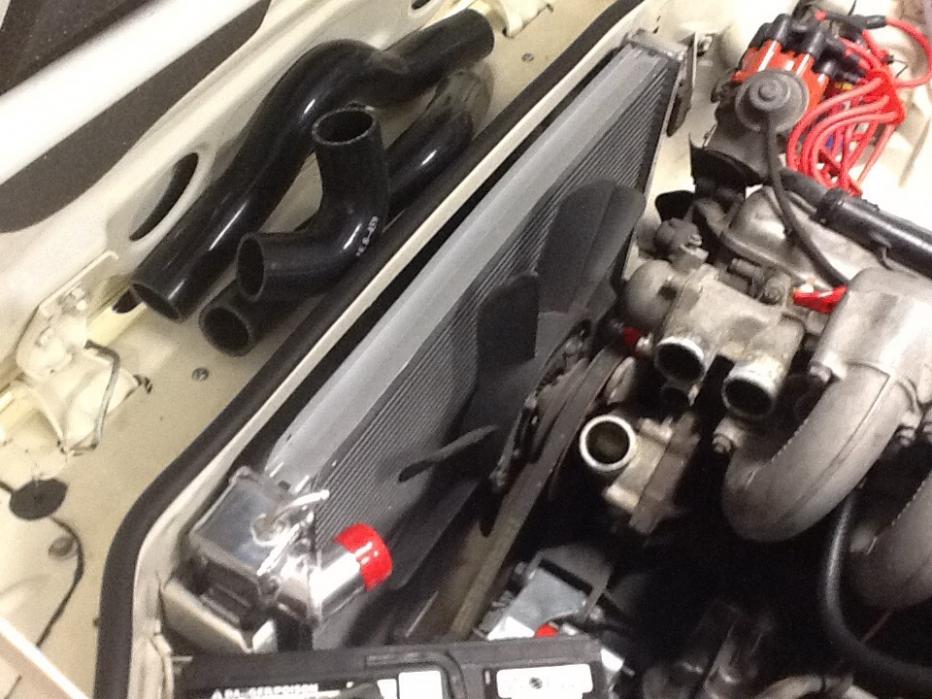

I bought both the 71 degree and 80 degree for my fuel injected '73csi; I am curious why they list both for my car?
Swapping out radiator now -- looks like you've got the same Ireland Eng. radiator I bought. You have webers and I have D-Jet -- could that be the difference? D-Jet need to run cooler?

t-stat
do not run a 71 degree t-stat on a csi... your cold start circuit will never close causing a lean run condition... Install the 80 degree only...

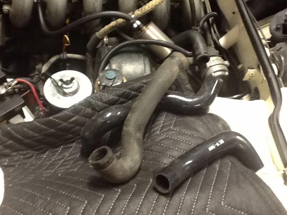

Ok - thank you! Do you think I should try locating a shroud? And the hose kit from Ireland: the two hoses down to and out (below intake) and up to overflow don't fit. Does this problem sound familiar? Does this D-Jet system cause a lot do confusion on parts orders?

Hoses
The Ireland kit is more than likely for carbs than an injected CSI... Call Ben @ LaJolla and get the right parts the first time... They usually have everything in stock... The CSI uses a number of specific hoses not shared with the CS...Change your aux air valve hose while you're in there...

I will call LaJolla. Thanks. Aux air -- those little 3/4 inch looking ones? I need a manual...

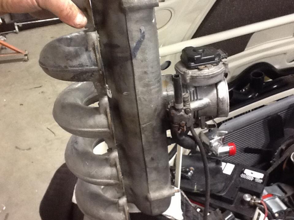

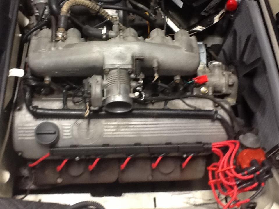

I can see I won't sleep until every rubber item has been replaced. Removing the intake might help, but wondering what gaskets I'll need to order is stopping me from making this room. I want to dig in! Go for it?
I have been measuring up all the inside diameter dimensions of tubing, and creating a list for another order. The injectors look to be inseparable from the hose supply. Wonder if they come with this piece of hose? Also, wonder if I can just get a new injector rigid rail/manifold? 1/4 inch rigid looks pretty crusty like everything else.

Also, since I'm so far off topic: what the hell, man! This brake booster set up is bigger than - it's a thousand cc block! I'm sure there are blogs on reducing/swapping this giant set-up...
No ideas on the injectors. Mine doesn't have them.
The brake booster is indeed massive. Common swap is the one from a 2002. This forum has a ton of info on the swap.

Well, I'd sure like to toss that huge-ass chunk of steel right now, but already today I've removed my intake in anticipation of swapping all rubber underneath the hood, injectors, starter, and maybe more. If I start digging into the brake system before I get this back together, I'm afraid I'll then goto the -- well, why not?
I think I'm going to start reading about the TII booster swap - after Duke loses to Wisconsin.
