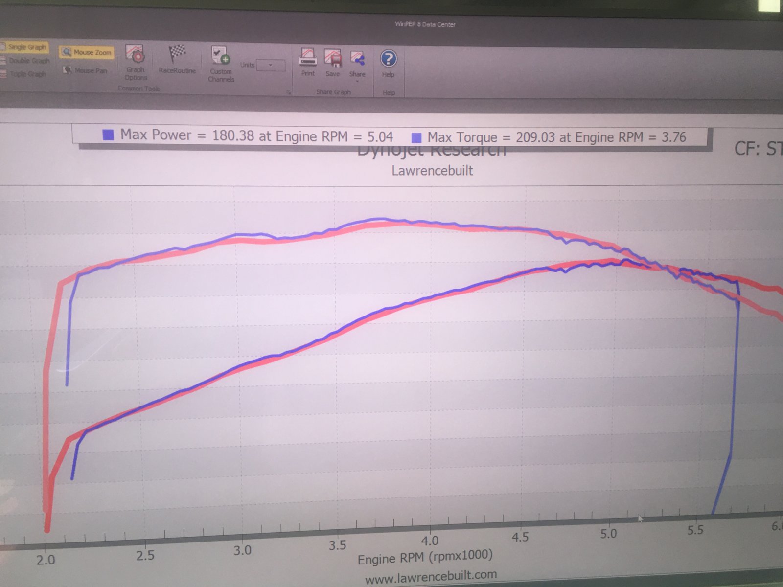

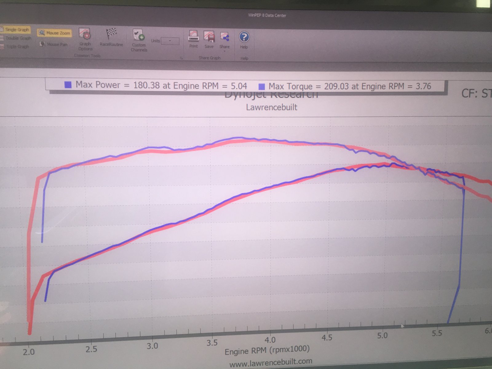

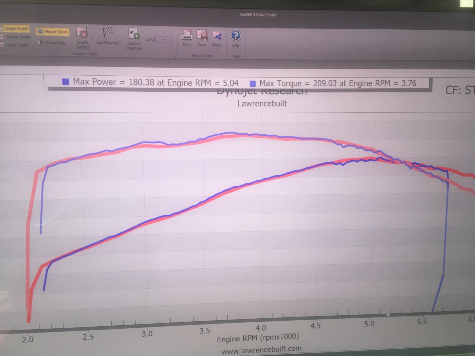

How much would you say the gain is compared to small tubes? And where in the rpm register?

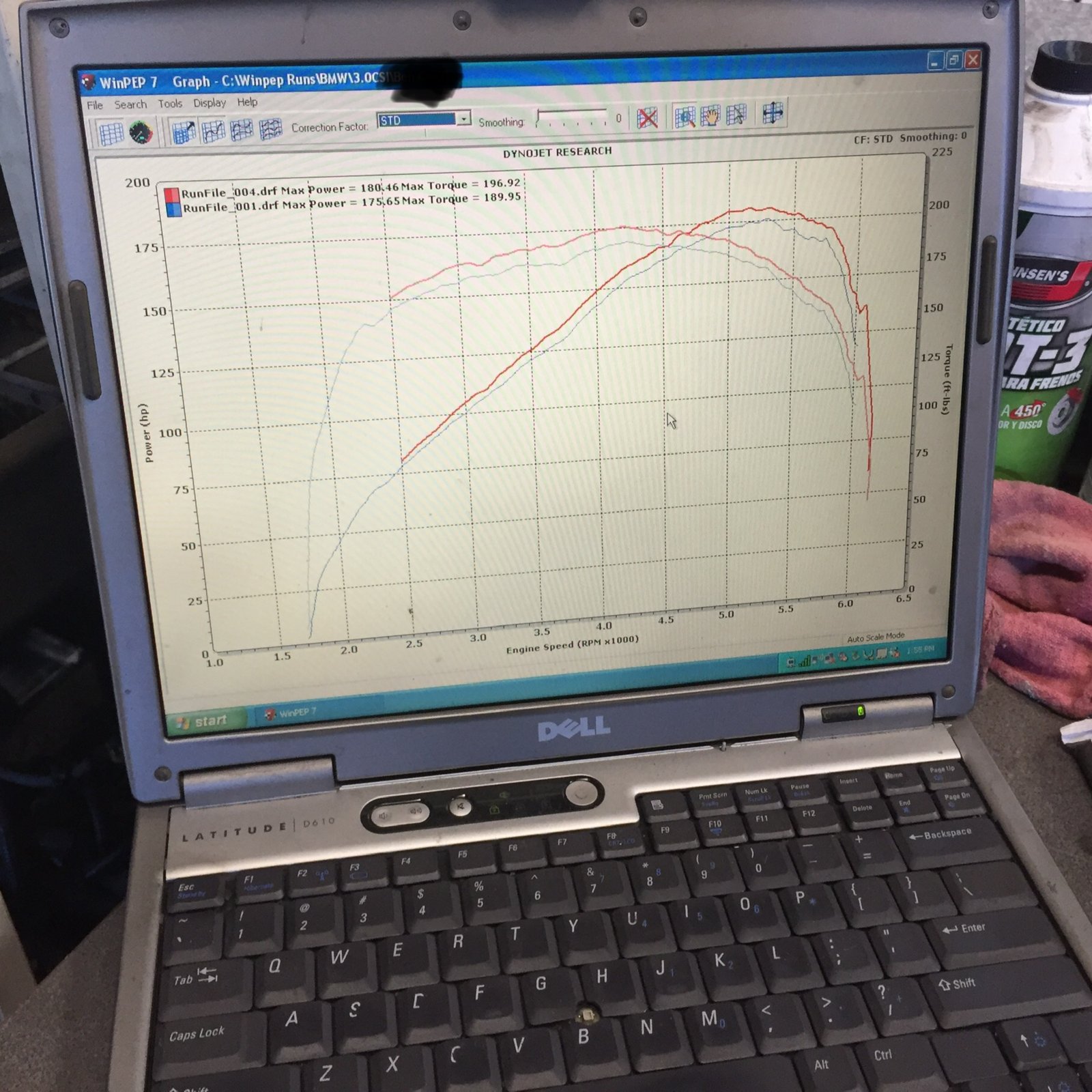

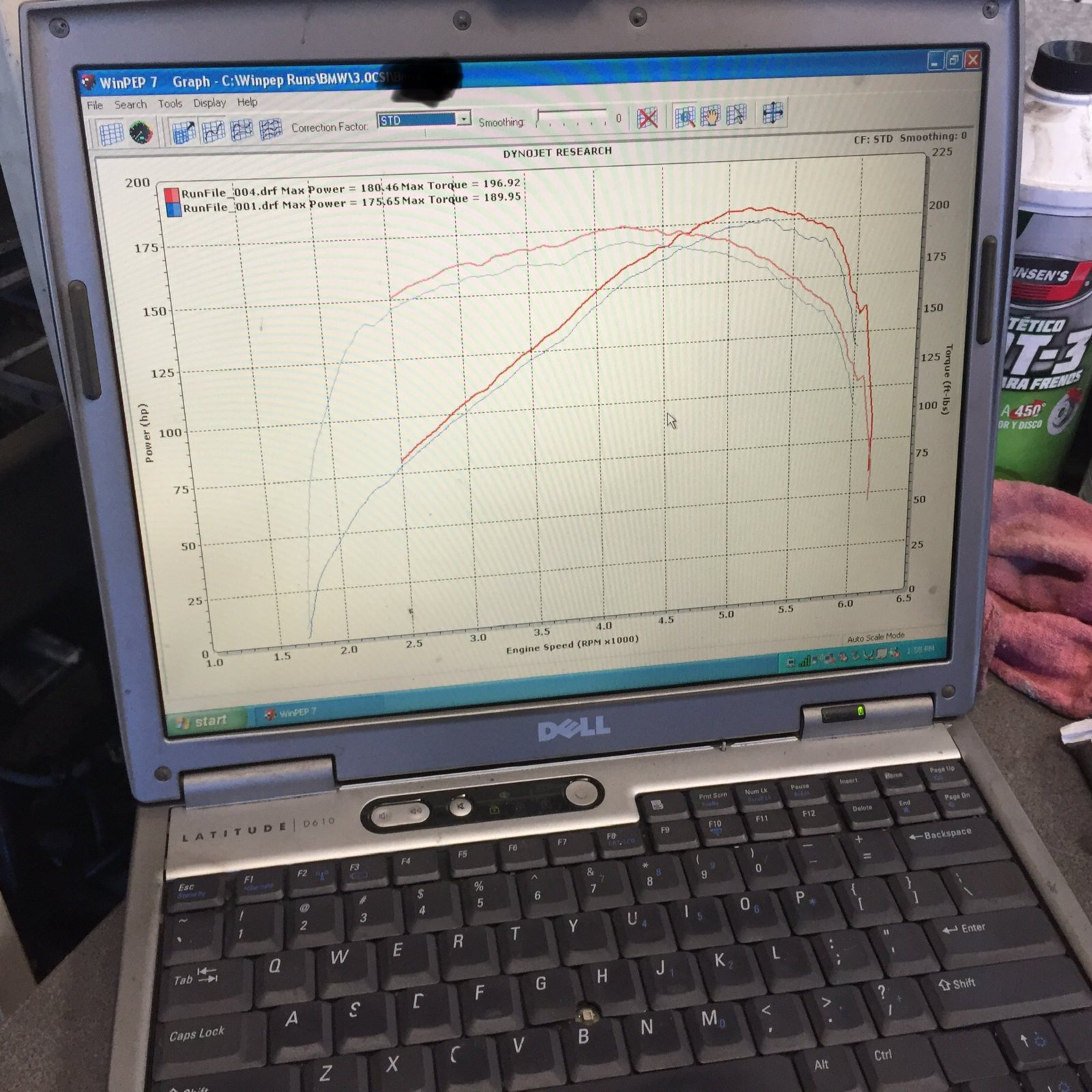

For the Dyno Guys out there...
same engine.
M30 b34 euro spec 10:1 compression
schrick 282 cam
same dyno.
Small tubes.
bottom line is exact same horsepower
increase 12 lbs torque
25 lbs increase torque at 2500 rpm
torque curve, hp curve big change with max numbers much lower in rpm.
