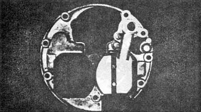

Title is per the [FONT=Arial, Helvetica, sans-serif]Zenith INAT 35/40 carburetor references posted in this forum. [/FONT] Does anyone know what advantage this has over the non-vented form? I have one vented (like below) and one not vented on my 72 E3 (original owner has no idea who did this) and have bypassed all the emissions stuff. I assume venting is a non-issue because of this but have 3 donor carbs so can easily swap the non-vented to vented if need be. Comments welcome.
They're all vented, but the one with the extension was on later cars and a recall for the earlier cars. It's meant to dump any overflow fuel from the float bowl into the carb throat instead of overflowing out into the air cleaner and possibly out onto the engine, which could cause a fire.
Thanks. Figured it was safety or emissions and nothing to do with performance. Actually had that issue happen.
