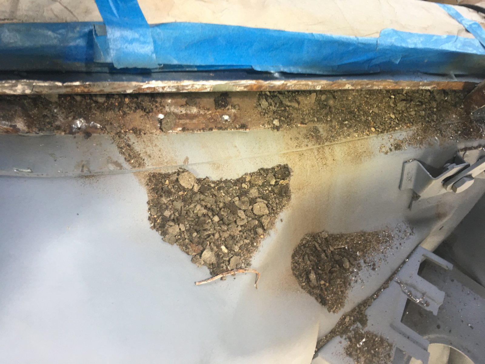

The client noticed this little piddly rust hole
sfdon
8,771
5,248
sfbay area

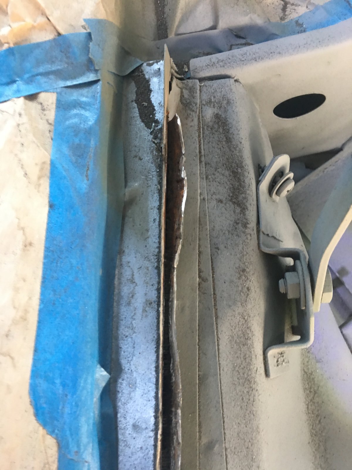

On the top of the fender. Since it was the smallest strip of sheet metal and cheap and available from Walloth - why not pull it out and replace it?
You're absolutely right. I would tear it out as well.
Sandblasting a car and then leaving the brown between the seams make little sense (to me), especially in the sensitive fender area.
But I can understand that an owner leaves it there. I think the rust will take a good ten years before showing again but then it might be through to the bottom.

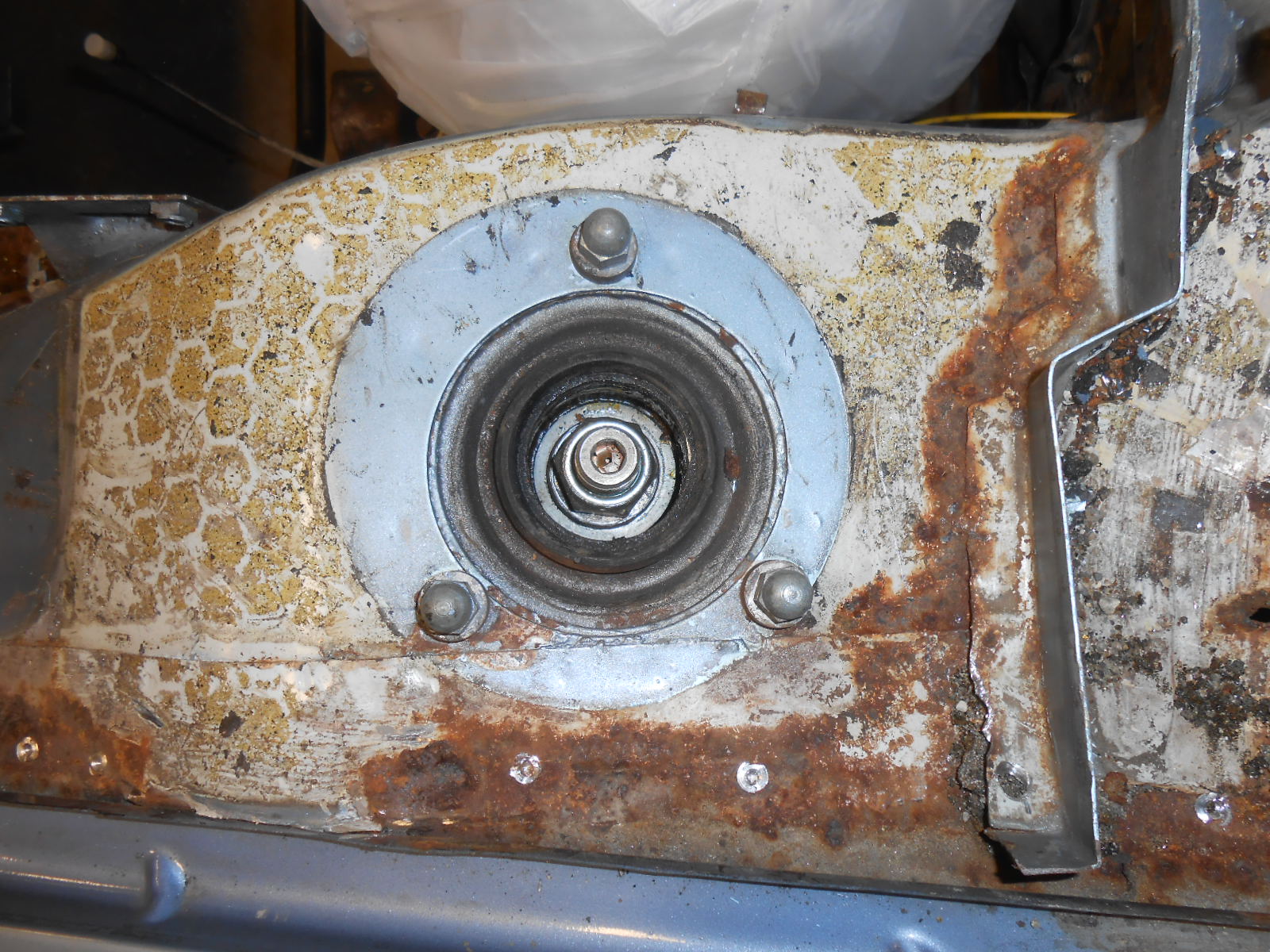

I’m starting to realize why my car is so difficult to push around on dollies!

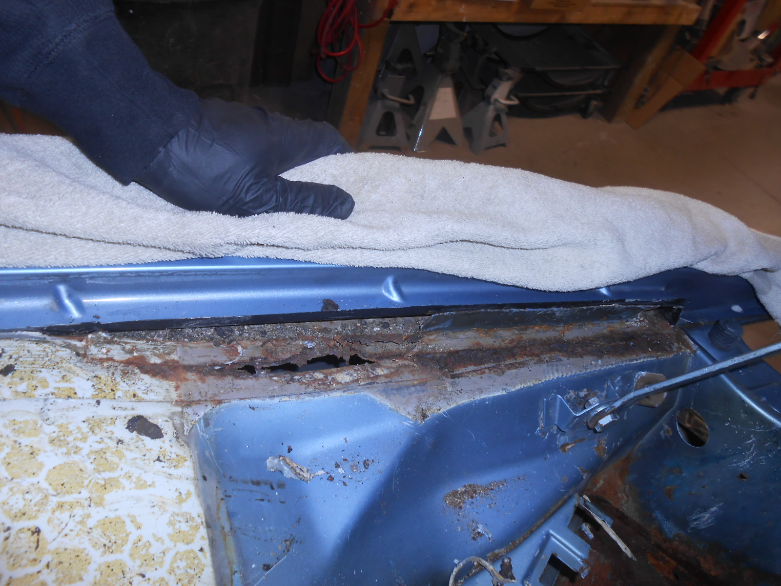

My car was perforated there under the seam sealer and fender insulation. VSR repaired it over the winter of 2015/2016.
