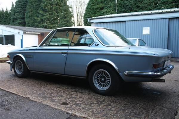

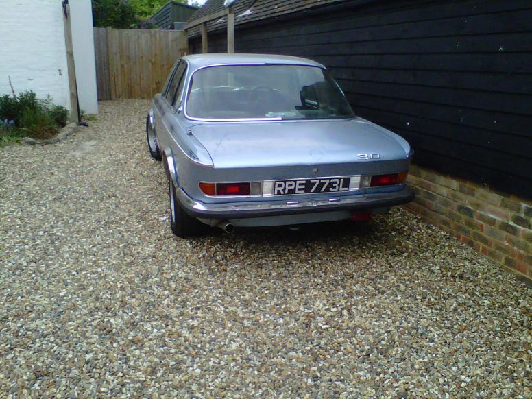

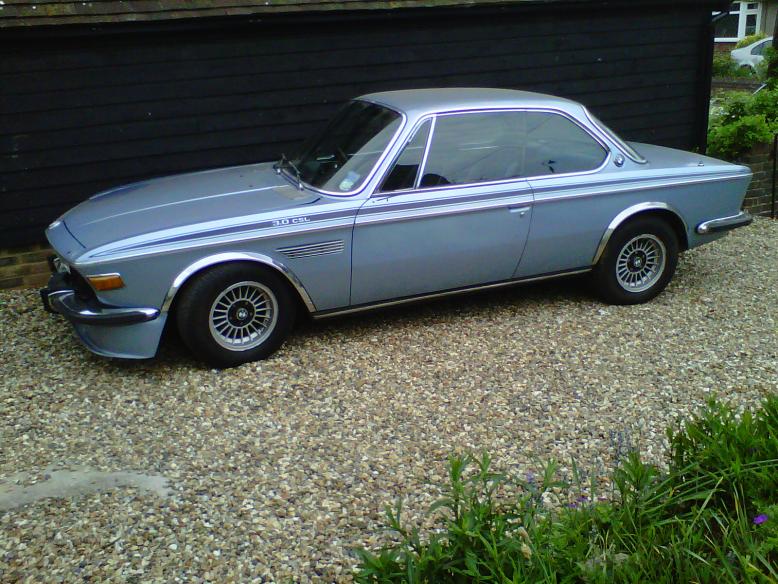

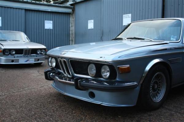

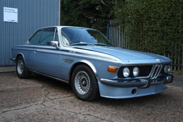

hopefully you will all be able to see these pictures.
