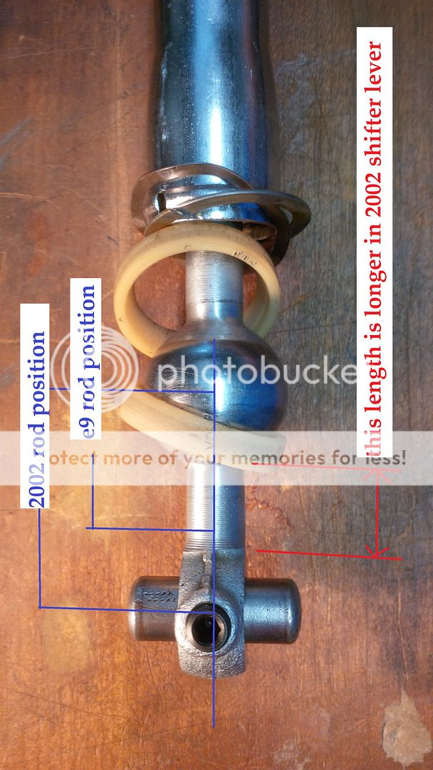

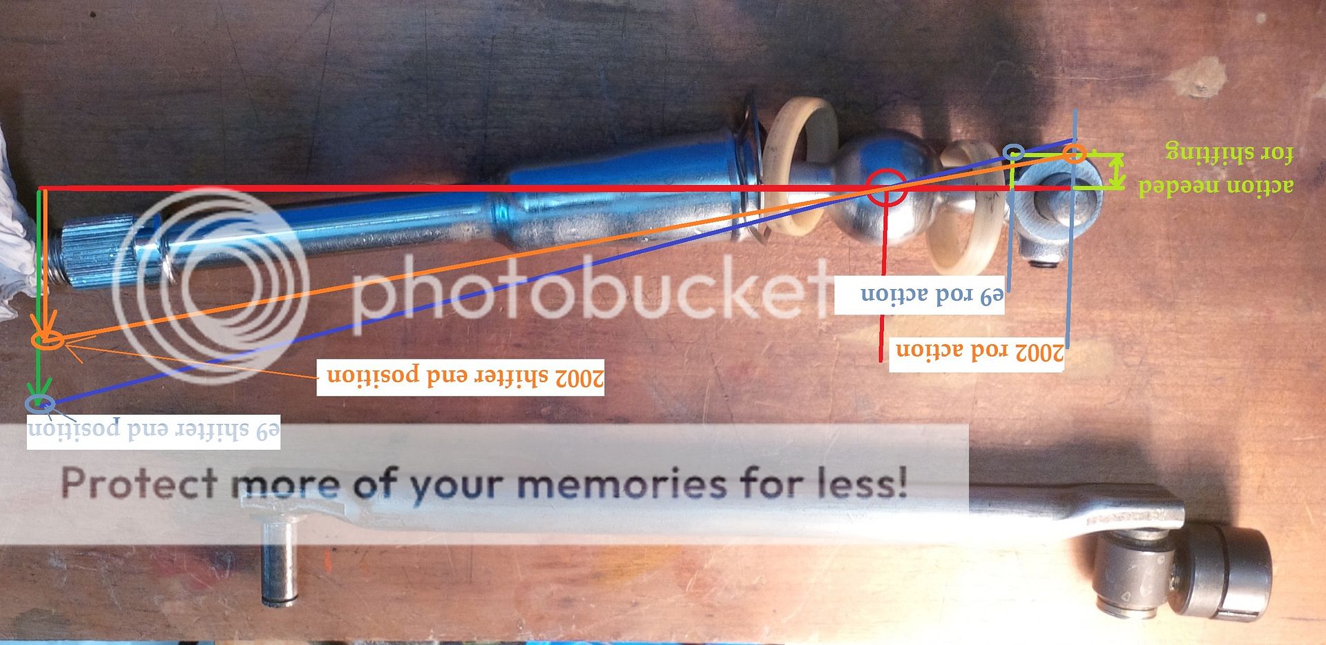

here is it,
looks good, fits`perfect on a stock 3.0 cs 71
crucial is the type of shift rod, mine is not like the one in the picture, i have a sort of "Y" bar that Works perfectly in this 2002 shift lever
thank you Mo,
ps, sorry for the photo orientation
the shifting now feels more like a precission joystick ,...so short,
i have not tried it on the road yet, but seems to me very "quick", besides you are far away from the console boundaries, which is good

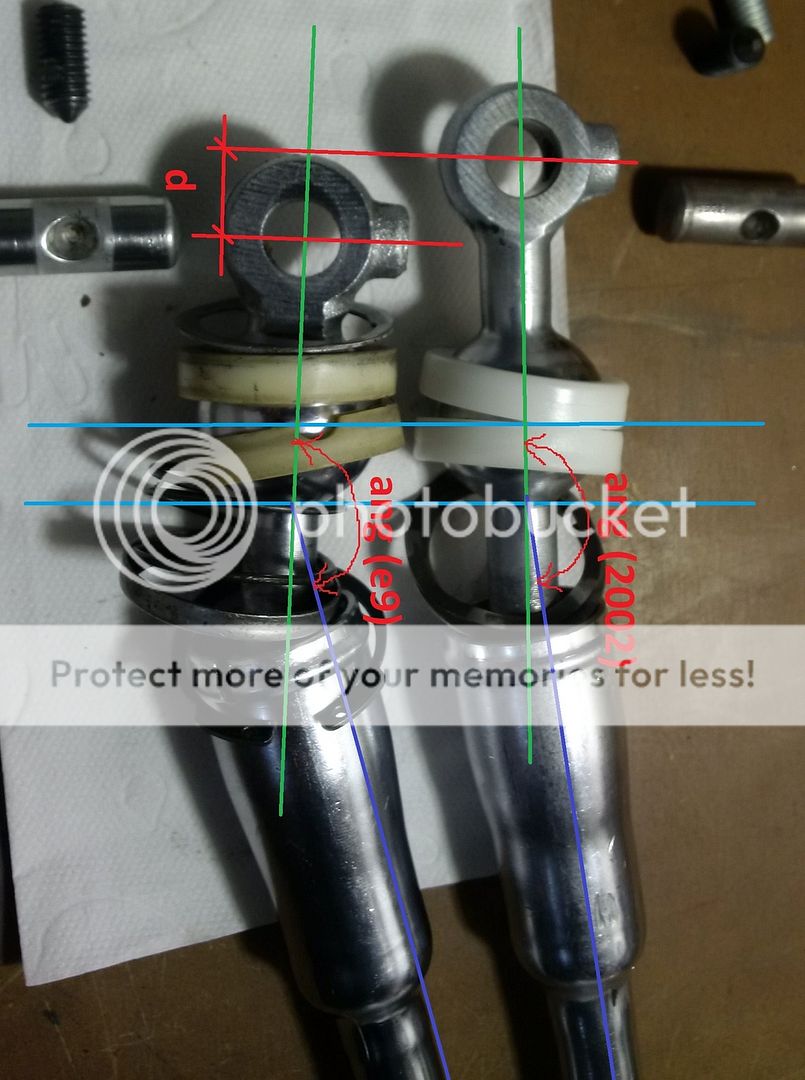

by the way, i found the lower bushings in this state:
one was missing, and the other,...yeah the "scary thing" pictured above, replaced them with new ones, ...wow, ammmmmmaaaaaazing
must do !:wink:
clean as much as you can, it is a dirty job (at least underbody job is)
replace all the rubber, nylon elements, place a dab of MoSi2 grease in the pin and in the holding cup, use a bit of loctite to glue the threaded pin
BTW, the final configuration of the assembly should be like the original one, so you should reuse the spring, ring cup, and so on...

After reading your comments and going over the link article you posted I think I found the explanation of why there is such a big difference in shift feeling between my Cs and my Csi.
In the CS you're really shifting with those "long troughs" as described by Mo, the CSi shifts much shorter and quicker. No idea if this has anything to do with how they left the factory or that a short shift system at some moment in time found its way in to the Csi.
