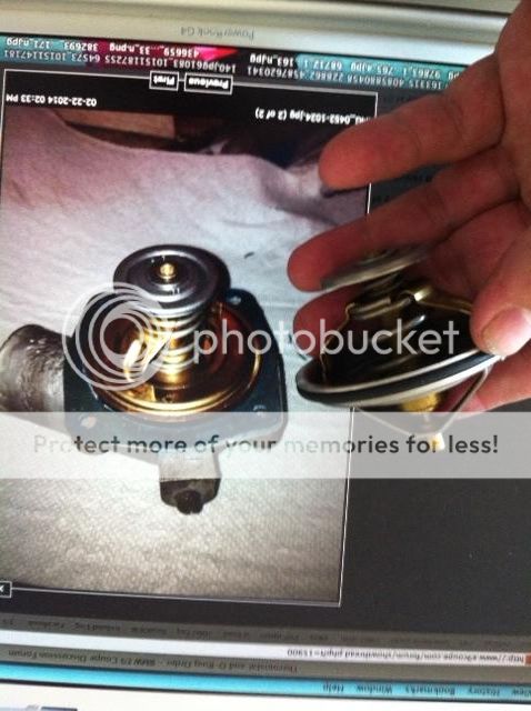

Barry, it's a bit of a Frankenmotor, a 3.2 from a 533i but with an L-Jetronic injection system from an E12 528i. The thermostat housing was from the 528i. It uses the thermostat on the left in the pic, which is the "newer of the old style." The "older of the old style" is on the right in the pic. But, from what I can tell, both of these thermostats need the O-ring between the thermostat and the cover, not between the thermostat and the housing.

The last time Don and I saw each other he looked at my thermostat housing which is stamped 86, and said I need to match the year of the housing to the thermostat, of corse thats a no brainer.
So are all housing the same? as in the depth of the bottom sealing ring of the stat... and the 2 O ring flanges.
Here s mine for my 1986 b34... The O ring flange is the opposite of yours.

I'm hesitant to believe that the OEM BMW parts diagrams are incorrect in regards to thermo gasket placement. As referenced by others and Sfdon above, it likely changes by year and thermo-housing design. The only evidence of a "leaking" themostat gasket would be a much longer warm-up period. Incorrect gasket placement should not induce overheating, as it would not prevent the thermo from opening. My 2800's thermo gasket is positioned per the parts diagram--aft of the thermostat in the groove. Warm-up period duration is normal vs. other cars.
