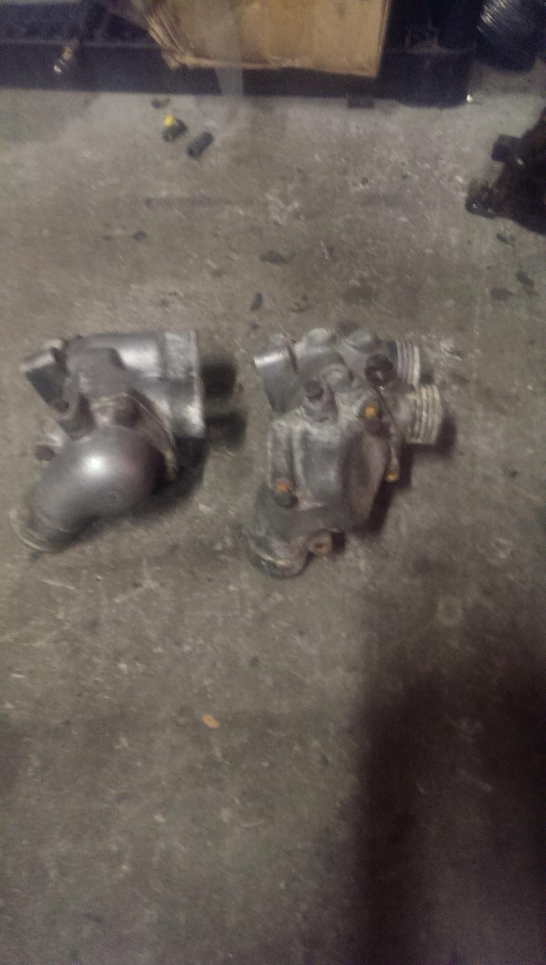

Mine has a crack. Part number is 11531714861. Is there any other cover that can be interchanged? That from a e23/e24 looks almost identical other than bolt length. Thanks.
One exception- motronic cover will fit if you order the 1982 633 lower radiator hose.
