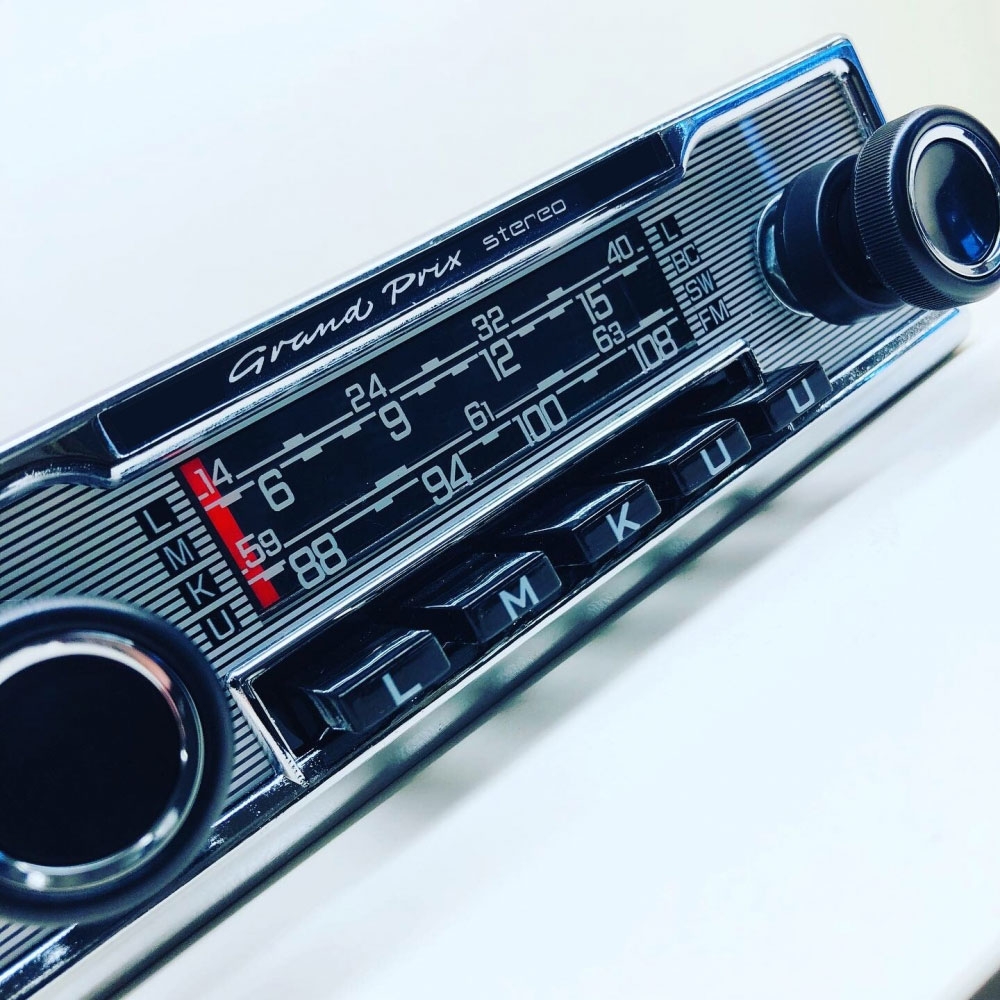

Find yourself an original Blaupunkt Frankfurt AM/FM STereo (about $300-400) or a Becker Europa II or Grand Prix w/stereo (a little more $$$) and get the guts converted to accept an input jack.
Fits like this:

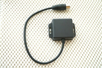

From there, you can put any cheap bluetooth adapter in there. E.g. here you're using the AUX for the input jack:
The latter already includes bluetooth. No need for a sep BT adapter to the input jack to go through.

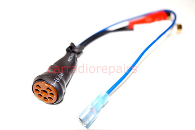

I have a Europa II w/the external amp too where you have options to connect to an external amplifier.

which modern power amp are you using? I couldn’t find one with sensitive enough inputs to work with this adapter without the old becker amp still in place
