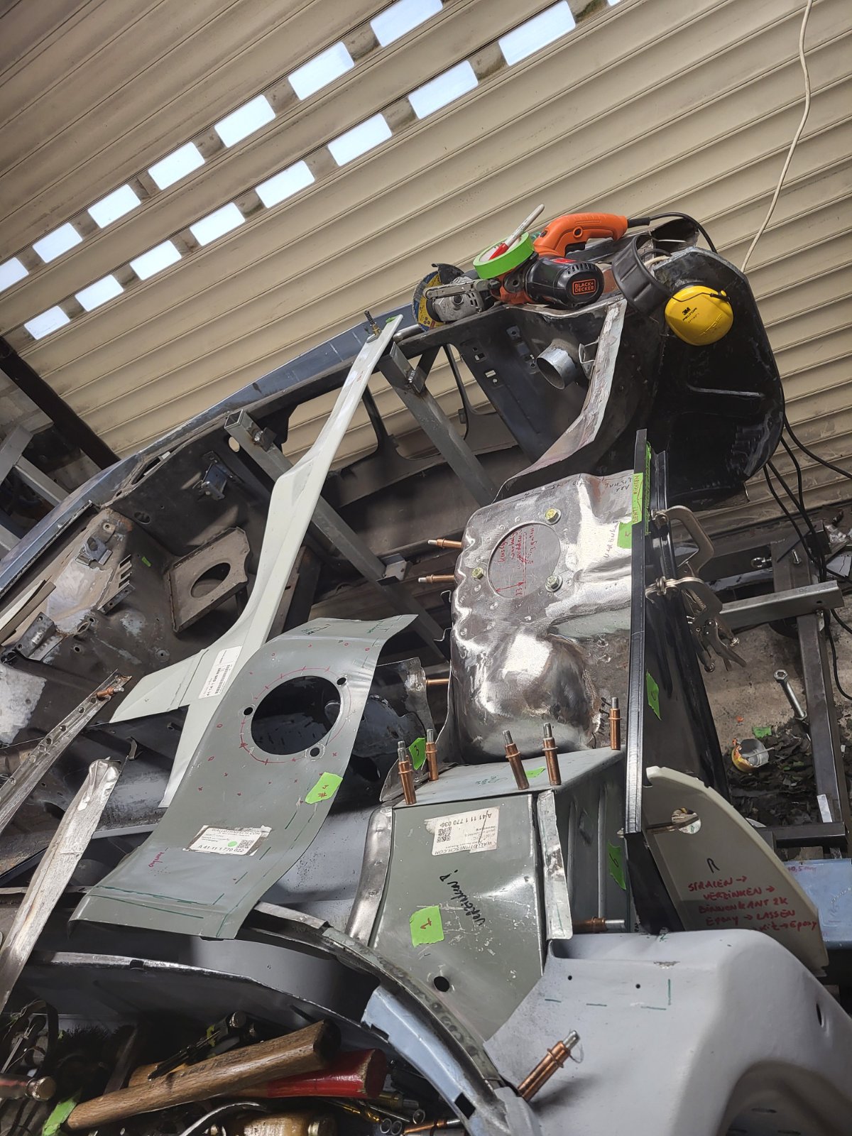

I drove it 4 years, year round, but I already had holes behind the fusebox.
When you replace a panel, it doesn't matter if it's 10% gone or 50%. So I drove it untill I feared it would fall apart going over a speed bump.
Now i just took it apart myself...
