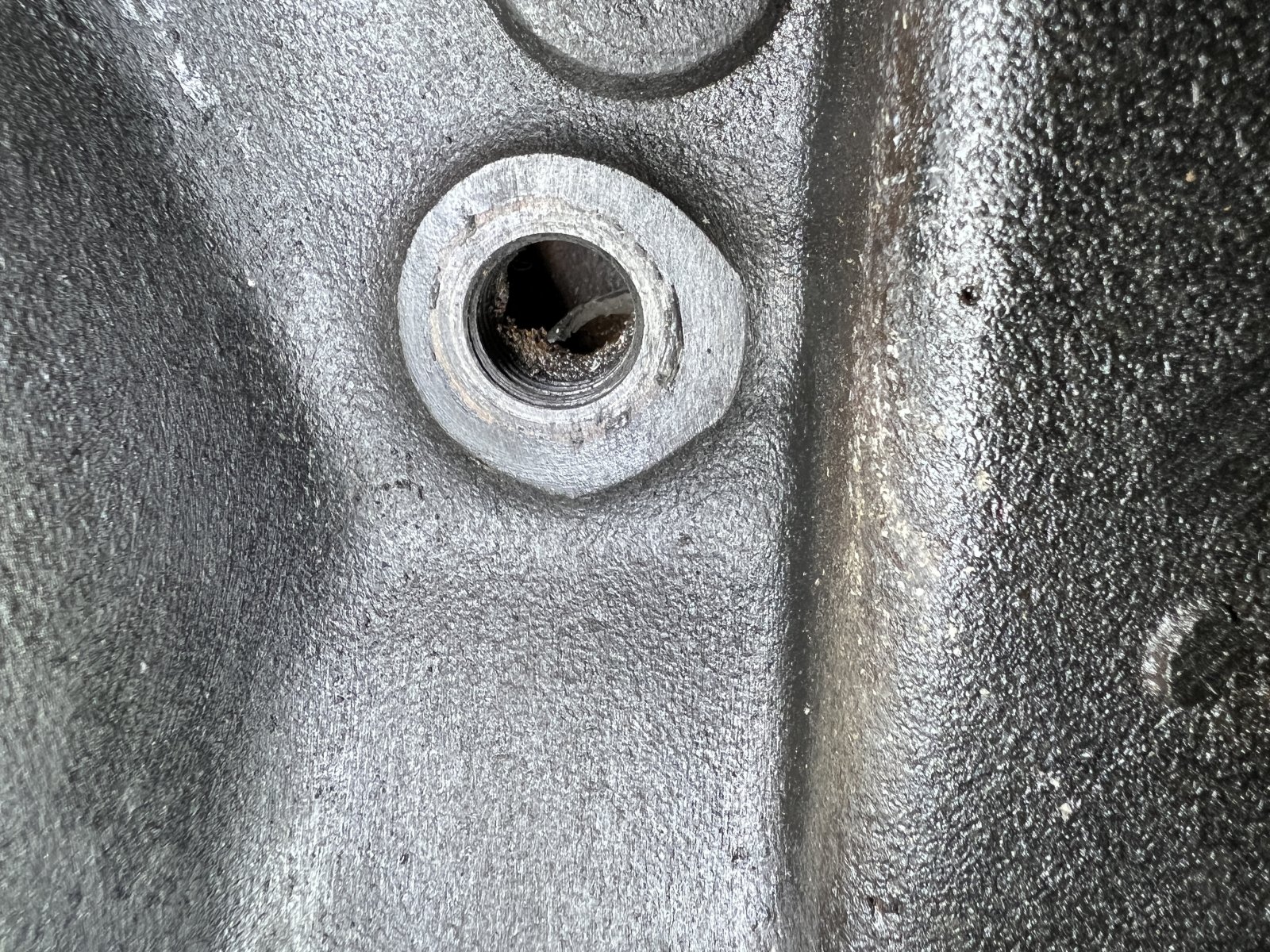

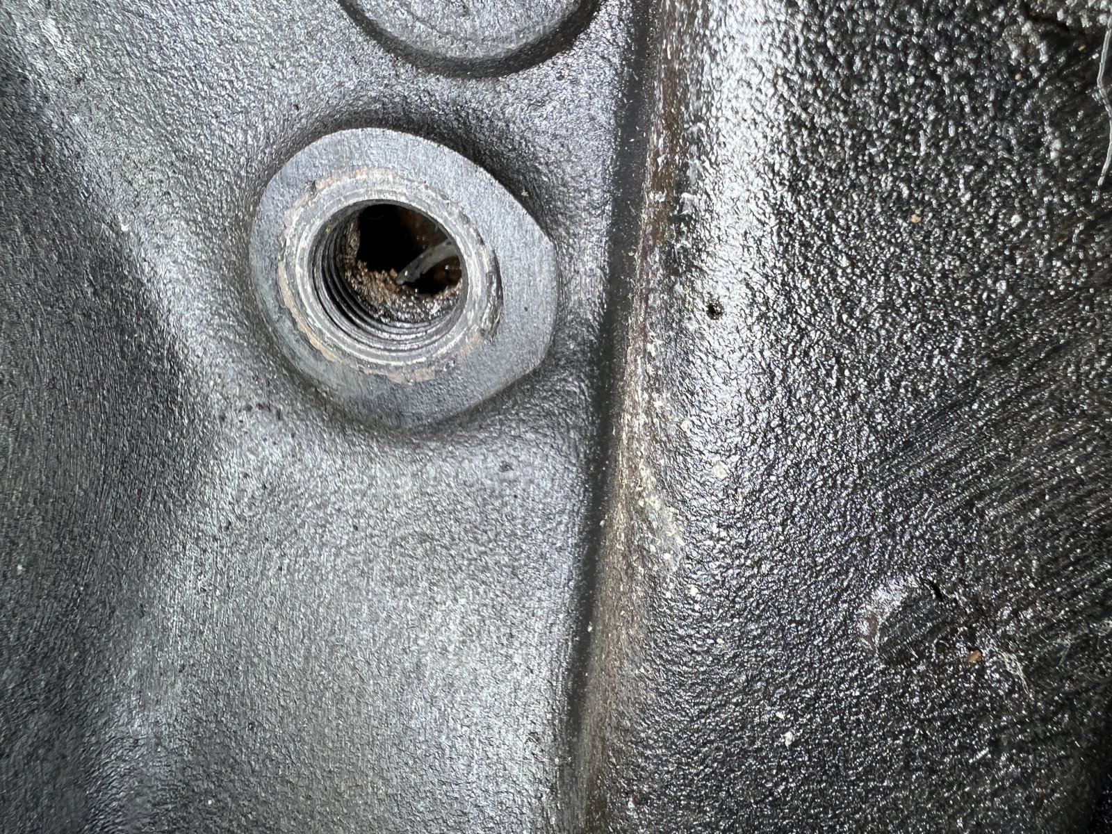

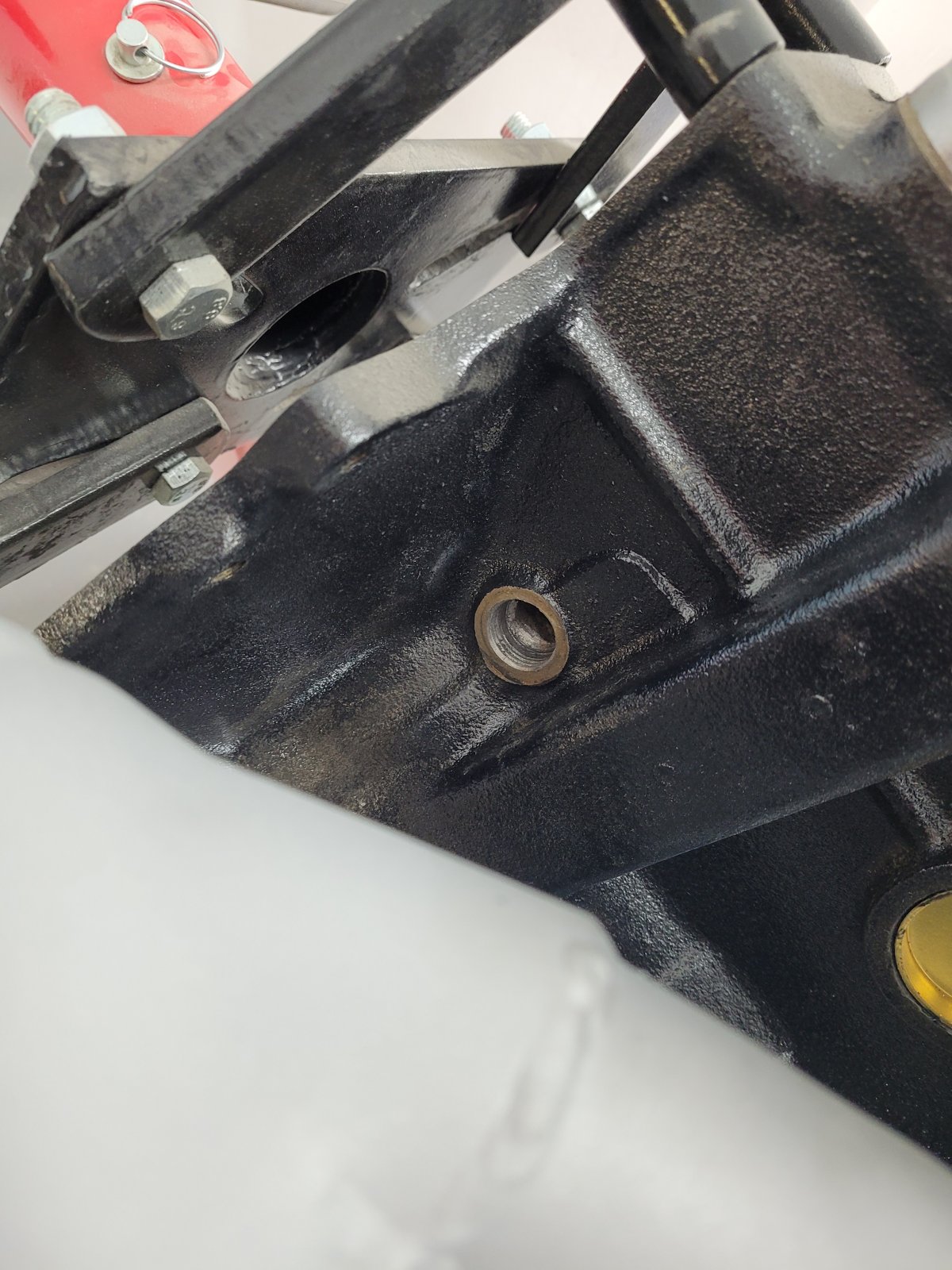

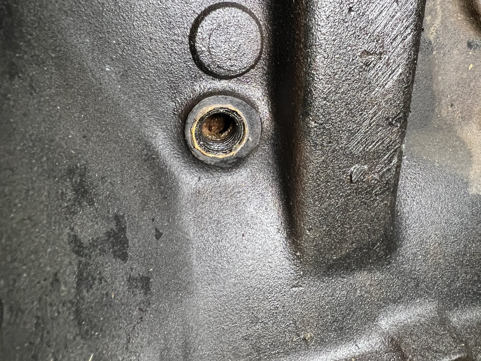

Threaded Port on Side on Motor??

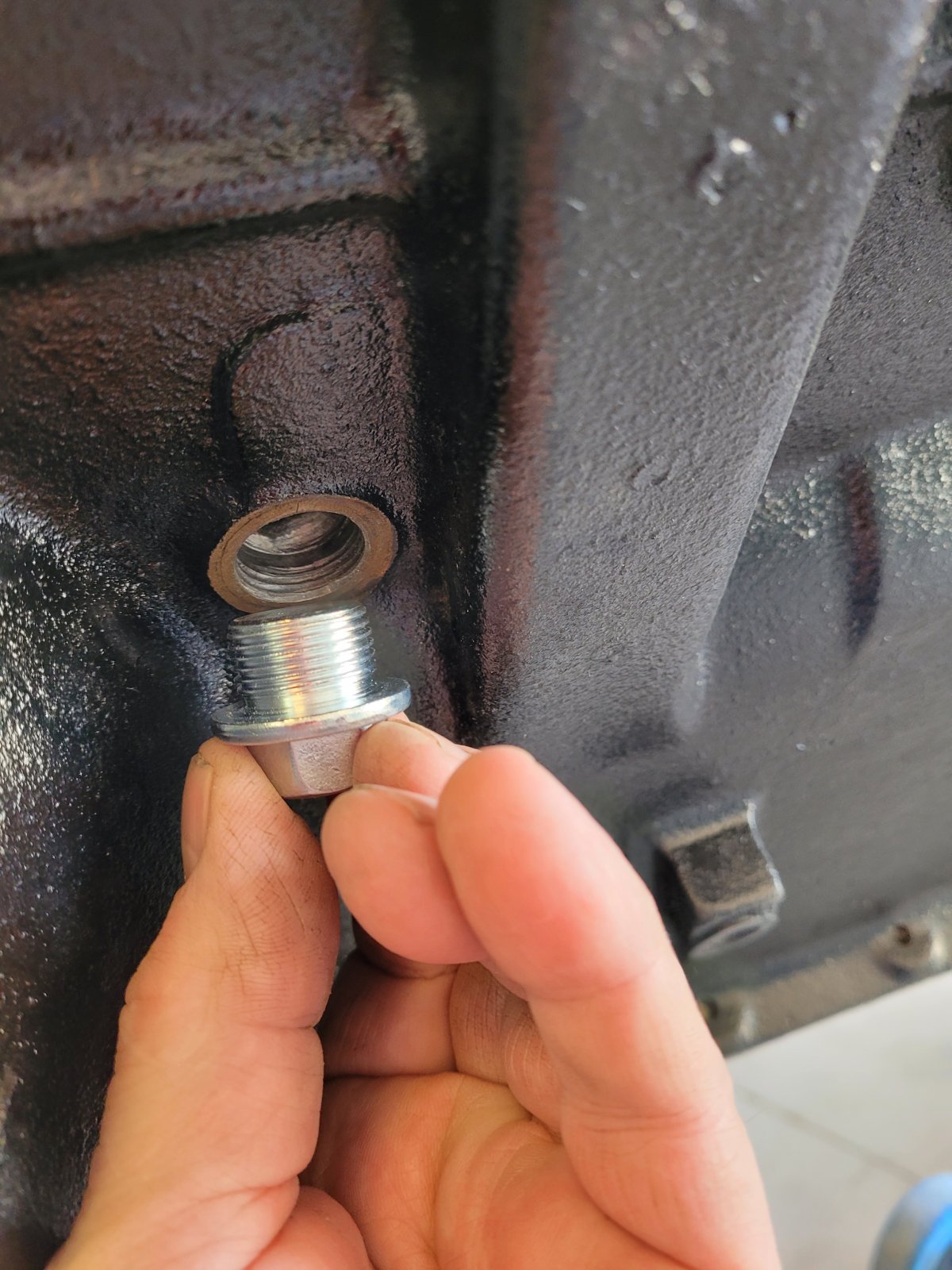

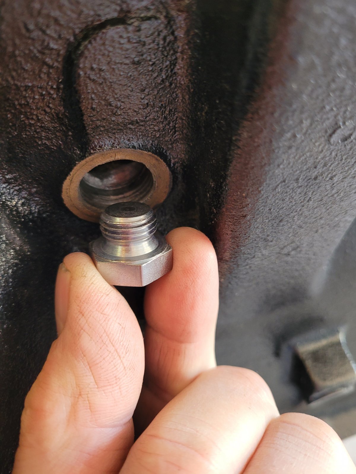

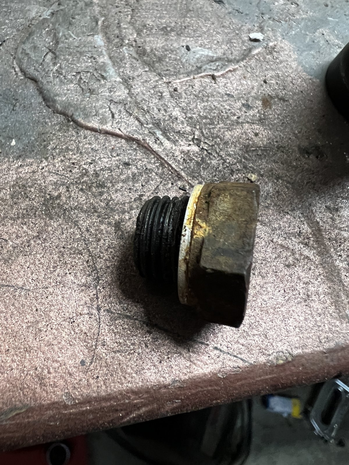

I cranked up the lathe and cut some quick treads on some scrap to see what I could figure out, 3/4" stock at 13 thread per inch, runs right in, needs to be more like .850 diameter material. Some obscure thread, plug, what ever, who ever used. Worst case I make a plug and move on. The motor is going in the car today regardless.
