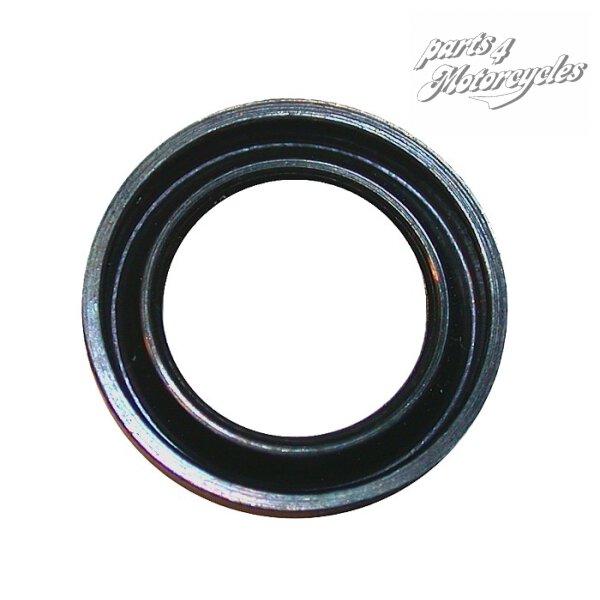

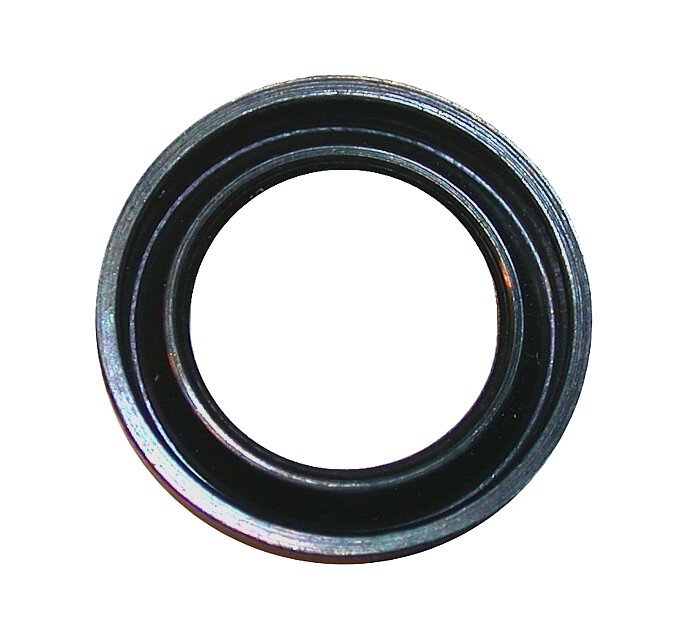

Hi All - its been a while, but I wanted to report that the Mikuni seals TomHom directed me too worked. I was able to properly set my idle once these seals were installed.
Also, Chris Kohler was looking at a Weber part he sourced locally and I think he had good success with this. If you want to go that route, please double check with Chris.
Again - this is for an M90 throttle body.
