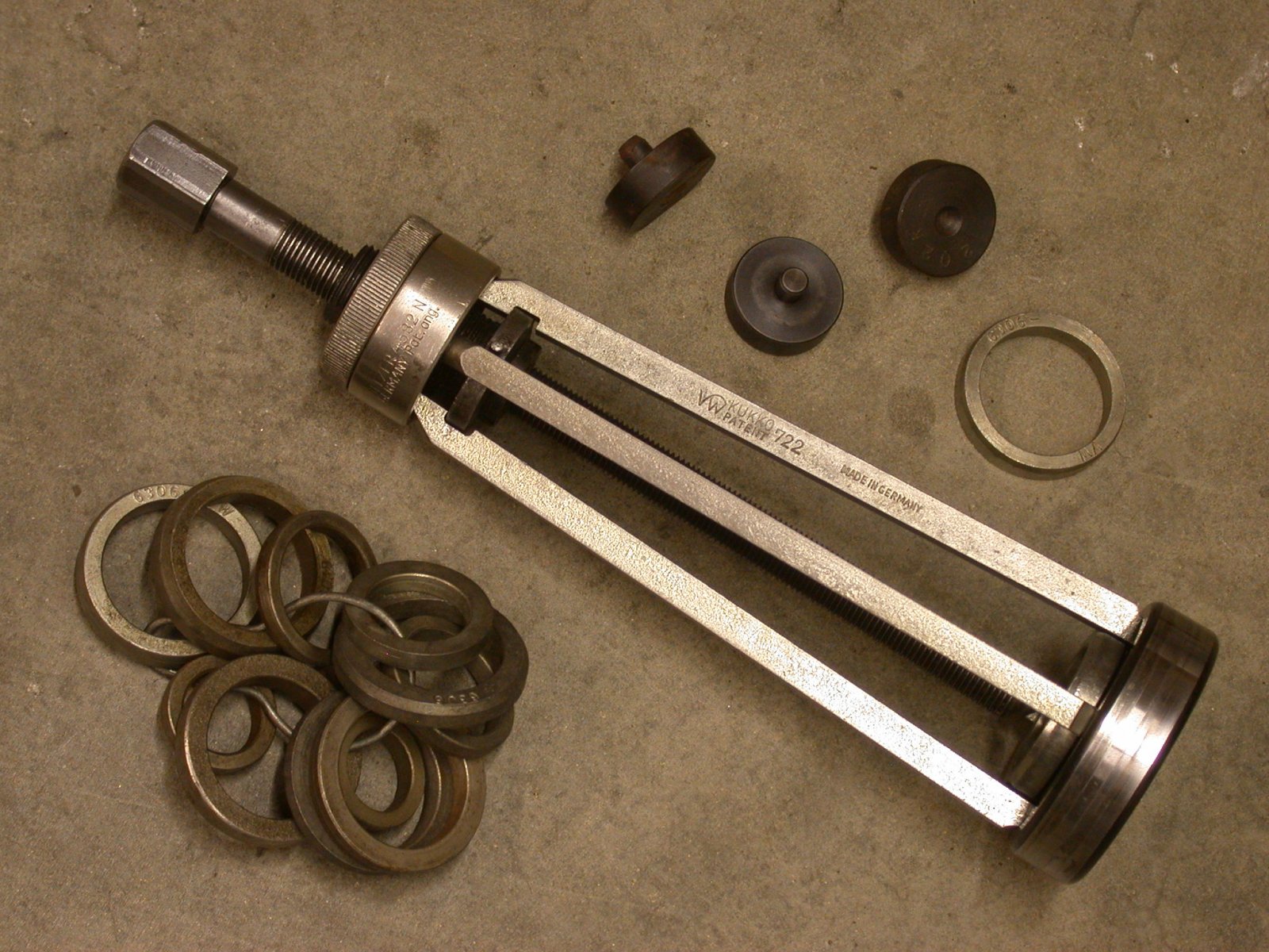

I use a German KUKKO 70-series puller (below) for the 6306 ball bearings on early Porsche rear axles.
A 6306 bearing is pictured on the tool.
I haven't used it on a BMW transmission, but I suspect it should work equally well... Don?

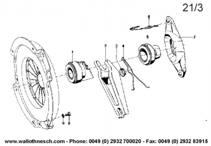

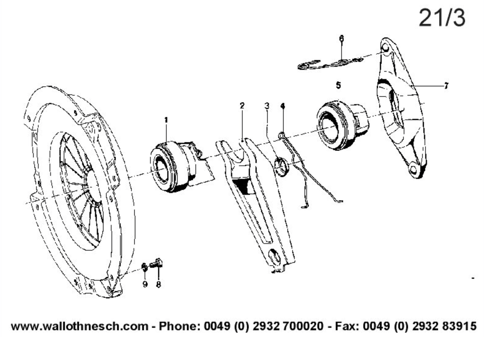

Below are the bearings I am referring to (1 and 5) that my mechanic calls "Thrust Bearings". And he asked me to check if any special BMW tools are needed to remove. Sorry if I wasn't clear before.
From my investigations, these are the two bearings that cause the transmission noise issues when not in gear, ie stationary at traffic lights in neutral.
I will buy part 1 below which is available at W&N, but seems part 5 for pre 73 CSLs with 4 speed is NLA. Anyone know where to get part 5? or is this unimportant to replace? (RealOEM dont even list the part number for part 5 for some reason)

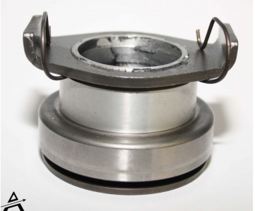

Mal, those are clutch release bearings. One is part of your clutch system.
It will not cause transmission noise, but might create noise itself when engaged, i.e. when you depress the clutch pedal.

Stephen, other cars often have different clutch arrangements. Some have the bearings attached to the clutch plate, and are always in motion with the engine running. For now, Mal has indicated that the noise does not go away when the clutch pedal is depressed, as your noise did.
Mal has now identified the bearing that his mechanic wishes to replace- the clutch bearing, and not a trans or gearbox bearing- although the issue is still being described as "transmission noise". More detailed information on when the noise does or does not occur would be helpful to diagnose the issue...

The "Old Pro" taught me that the clutch release bearing can be taken apart using two opposed screwdrivers, and the grease cleaned. If the balls and race are not dimpled or scored, regrease, reassemble and on you go.
On the other hand, you have to remove the trans to get at it, no small endeavor for the one-guy-in-a-garage private owner, so you want to measure your chance of success against having to do it again. Look on the bright side, though: once you've done it, you'll have all the tools and setup to do it in one-quarter the time, next time.
You're going to have to remove the trans to access the bearing (which should be cleaned and greased once you're in there anyway). At that point though it would be nice to have another new release bearing on hand, I wouldn't install unless the old one is demonstrably in poor condition.
