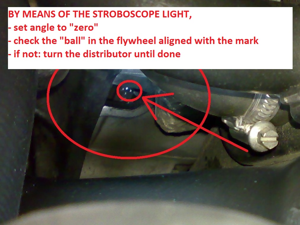

positive point on the flywheel marks is the existence of the BALL (o) that marks the 22 deg BTDC that you need for the correct ignition timing
so try to get that line of sight, for gods shake
and additional feature of the modest and good timing lights (not sure of the cheapo ones) is that you can settle the deg in the gun, this will allow you to use the front wheel pulley mark
- when you work with the ball you must set the advance deg in the gun to zero, this way the ball rules
- when you work with the TDC you might be able to get the same setting through setting the advance deg in the gun to 22 and aim to TDC
hope it helps

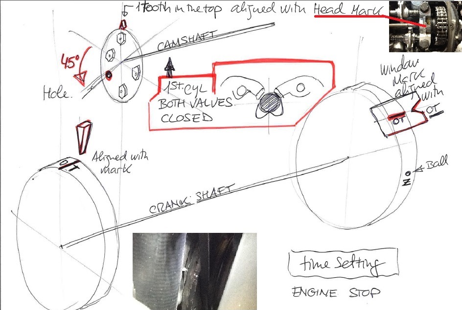

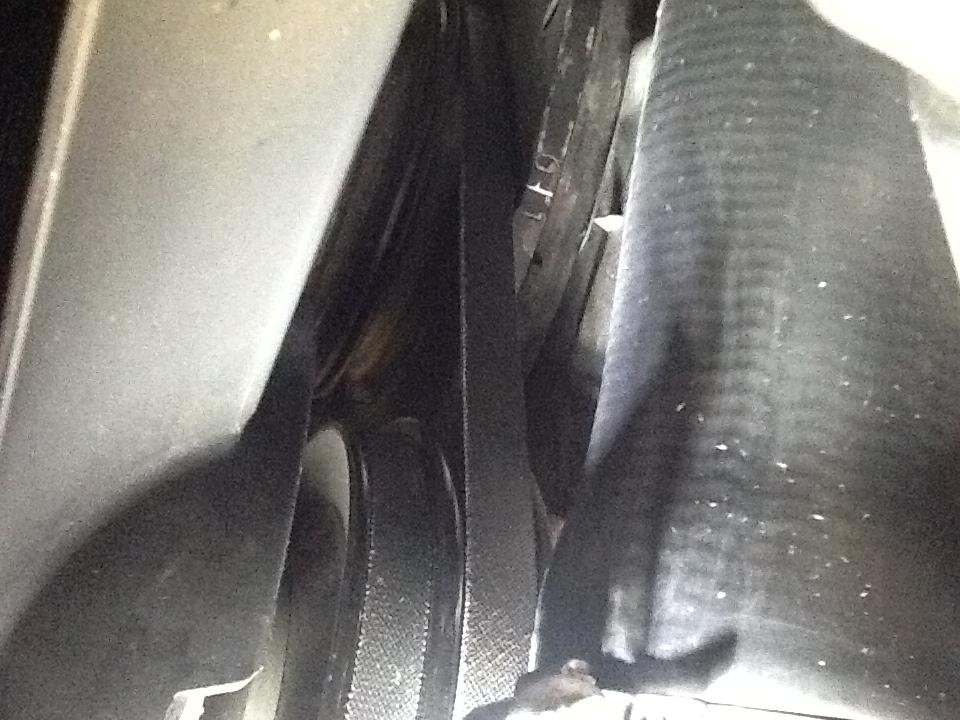

i find much more difficult to look at the front pulley mark than to use the flywheel
it is not that difficult to find the lina of sight, and using the ball is very straightforward
the front pulley area has a very clear mark, that has to be aligned with the mark in the engine front alu cover, bit there is not a ball in there
explanation of the geometry
