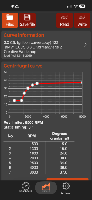

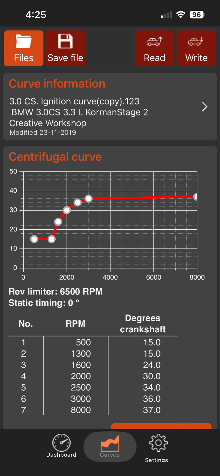

The latest--A leakdown test was performed on cylinder #6 and the valves are tight. All 6 new plug wires have the same voltage. The idle, main and accelerator pump jets were inspected and no debris was found. The top screens were cleaned on all 3 carbs. The 123 dizzy was set up with the correct advance curve. Pic shows the curve.
The engine still stumbles from idle to 2500 RPM. We need to sync the carbs again before bench testing the #3 carb. But I'm driving to events this weekend and the car is entered into a Concours next Sunday in Delray Beach. The engine runs fine at highway speeds.
