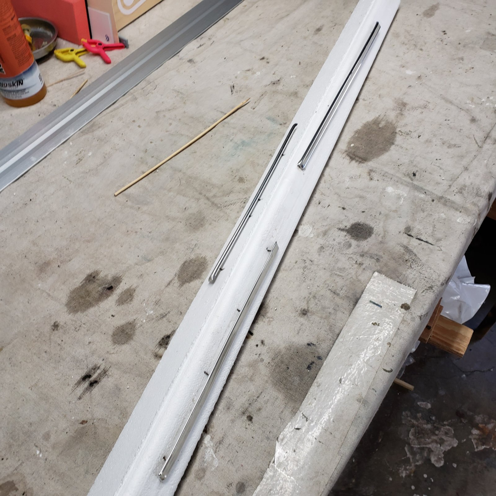

More polishing on some new/used door trim I got from a forum member. Definitely going to make the doors look complete.
A tip on polishing those awkward, fragile door pieces. I used the corner styrofoam pieces from a washer purchase a couple of years ago. Just straighten the hold downs and push them into the foam. Makes a great, straight, and stable base. A
LOT easier to do. Another interesting note. The door pieces are anodized while the center console trim is raw aluminum. Can't really do anything more than clean up the door pieces. No real buffing.

Thanks Gary-- Yea, I've removed the anodizing before with easy-off but the pvc pipe w that cleaner tip sounds super useful if I ever want to go that route. Cars going to get restored in the future so I just wanted to get the trim pieces on the doors for now. There's really only one piece that's banged up but that's in character with the car at this point.
