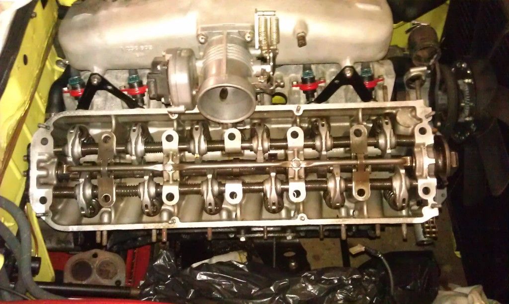

Well the head is finally back in its rightful place, i have only placed the bolts in the head and have yet to get the cam sporcket on but after a long time off the car it was satisfying to see it back in the engine bay!
It was hard work to lift it in with the intake on single handedly!
Very, very nice. Make certain your oiler bar is on correctly as they are sided.
