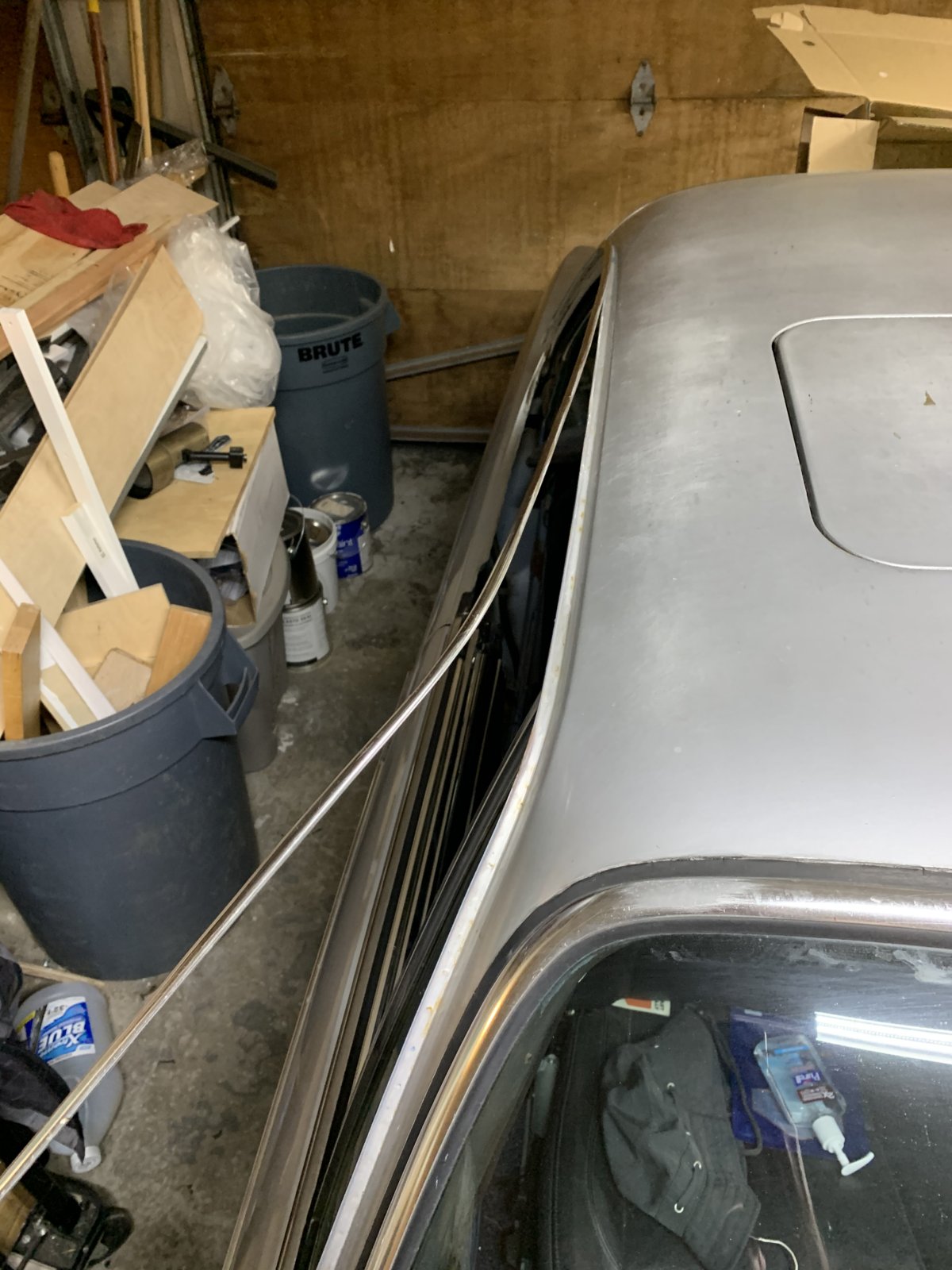

I am removing all my trim in preparation for repaint. I was able to pull about half of the drip rail trim but it gets stuck half way through. I am hesitant to pull too hard in fear that it might bend. Any tips on this one by any chance?

bending them.upwards a bit helps. Forcing something behind it to pry them off will limit the bend it makes (compared to just pulling), reducing the chance to destroy them.

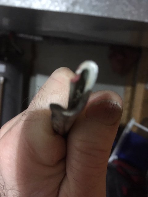

The top hooks on the drip edge and the bottom wraps around this. So pull from below and rotate. Spray WD 40 along the top first.
You wont cause a problem with light torquing...lube and rotate clockwise, rock gently up and down. This is where mine got stuck pulling it off and also putting it on. You may want to start at the C pillar and move forward. Iteration technique. I am glad to se someone else working in tight quarters like I do.

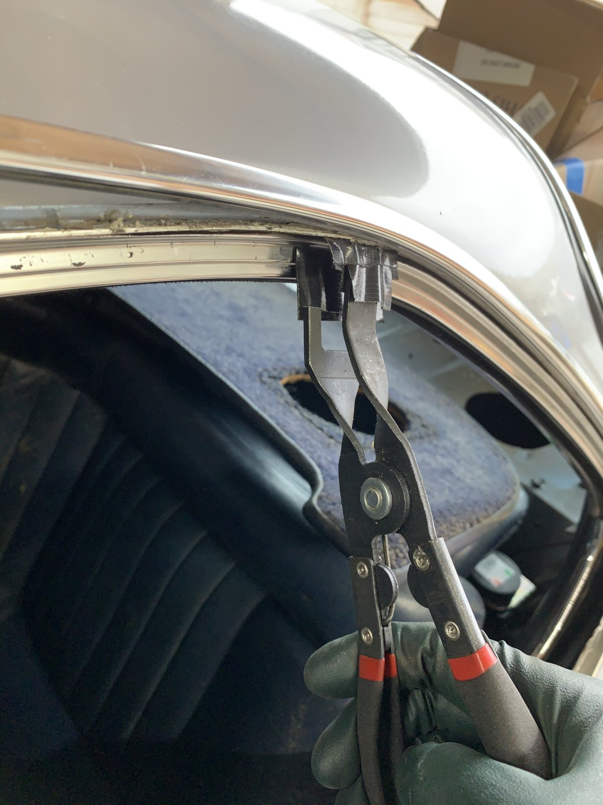

OK, after racking my brains trying to find some method of helping the process, I ended up using the tool you use to pull the door panels off. Wrapping duck tape on both sides to protect the chrome, it works reasonably well in helping to pull the bottom off of the rail. It’s not a miracle solution because you still need to use the above mentioned techniques of torquing and pulling gently. But it definitely helps around the tricky areas.

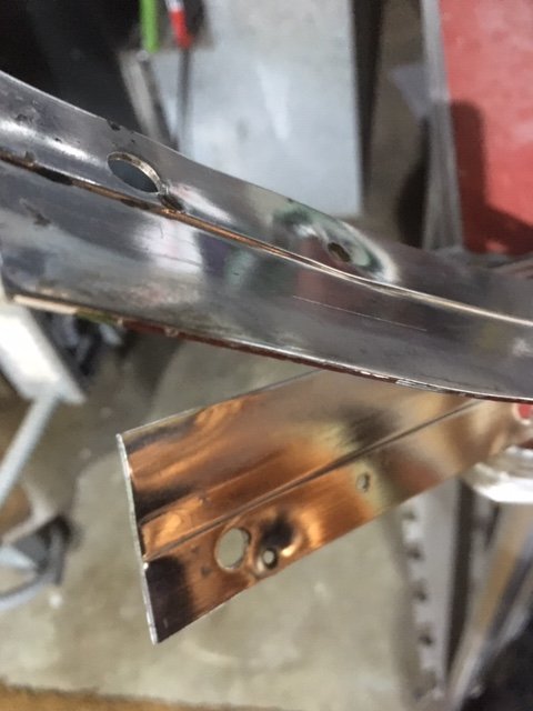

You need to make sure the drip edge is clean and the paint/primer is not too thick. Also the chrome piece I show in the post above has to be contoured to the inner part of the drip edge. The tool will help you get the trim around on the bottom and spare your fingers but if everything is not perfect, it will pop off from below.
