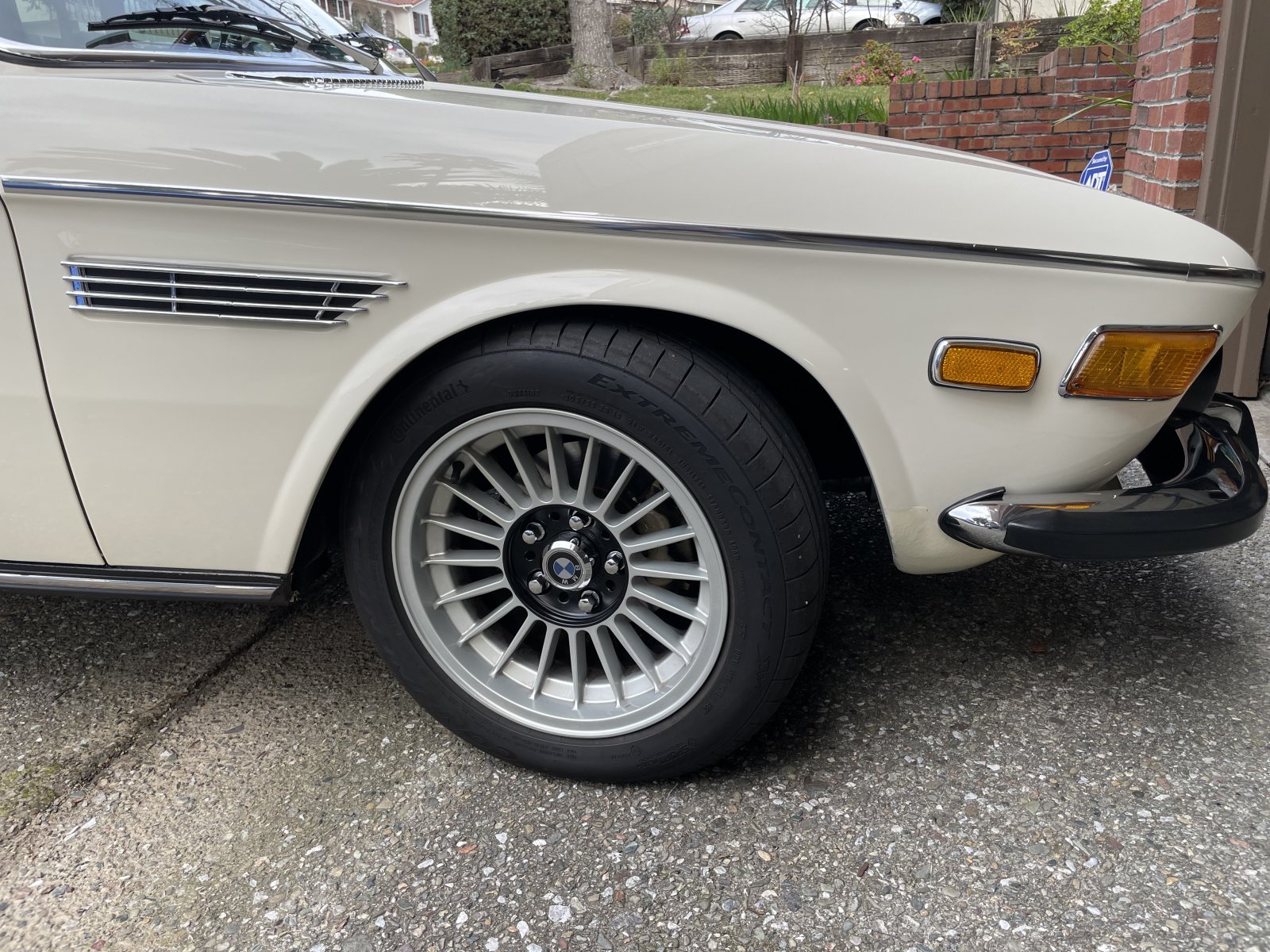

I second the Contis recommendation. The sidewall and tread edge shape is more rounded than the Michelin’s and looks a little more like a period tire.

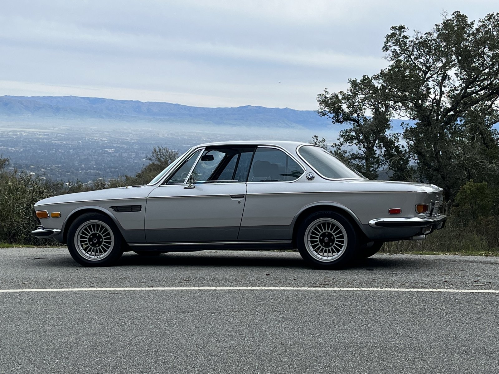

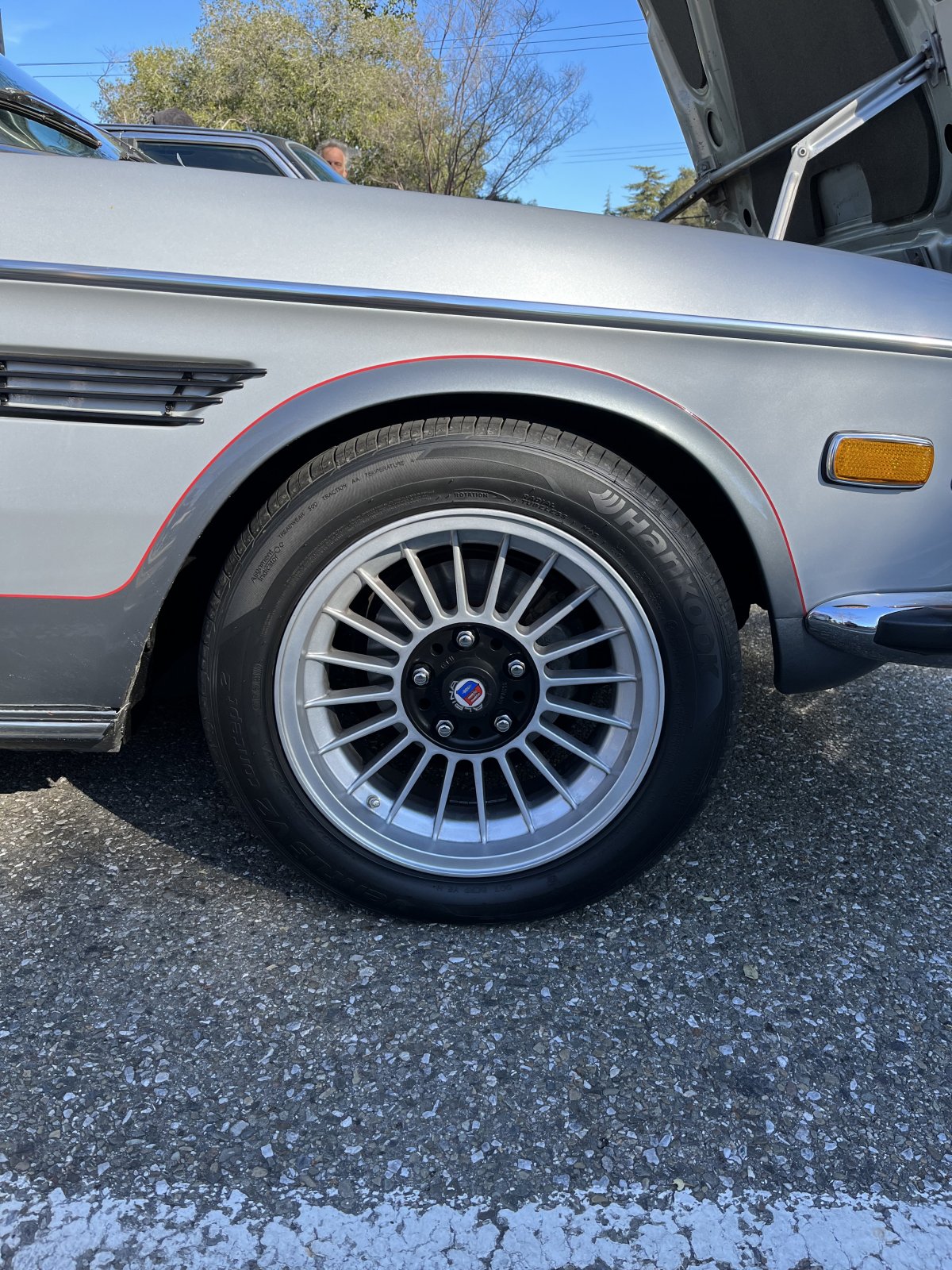

This may not be popular but I got the least expensive tires that looked good I could get. America tire company out the door $490! Hancock Ventus V2 concept 205/55 R16 and 225/50 R16. Some one on the forum gave me the adive: on a 50 year old car is tire performance that important? For me it was not and I am very happy with the tires and no one has ever said "oh those are cheap tires" I do get lots of comment on the Alpina wheels

I second the Contis recommendation. The sidewall and tread edge shape is more rounded than the Michelin’s and looks a little more like a period tire.View attachment 163262
