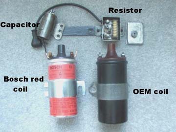

I am sure mine was original when I took it off - it was black but will verify tonight. I repaced with a higher output Bosch red one and kept the ballast resistor and added Pertronix, mounted a dummy condensor to keep it looking stock. Works well.

Original was black and used a 1 ohm resistor. The current replacement is red with silver label or sometimes silver with red label, they use a 1.9 ohm resistor available from AutohausAZ for $28. Later cars got the blue coil with internal resistance.

Chris, am I running the risk of frying my Pertronix and/or my coil by running the stock ballast resistor? It's been over a year and several long trips with no issues and starts right away on first crank.

After several years I have had no issues. But, my points would only last 7k miles so i went with the Pertronix and may switch the ballast to 1.9 which has a reddish bracket. However, on my 2002 I had the red coil and stock resistor and my ignition would cut out, sometimes after a long time. I switched to the 1.9 and have had no issues, it still has points. If you still have Black you should be good

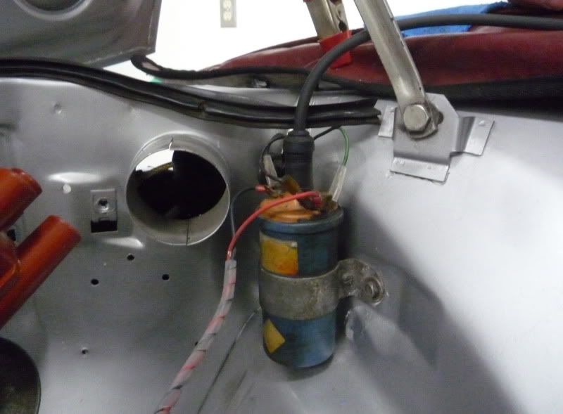

I didn't have the time to remove the coil, but wondering where the Blue/Orange top fits in? I also do not see any Ballast resistor under my hood. Could this one have the resistor built in and is there any advantage to this? BTW,( I have installed a Pertronix and the car was barely running when I started taking things apart in the fall)
Blue is all you need, it's internally resisted. Your coupe would have come with a black coil and resistor originally.
