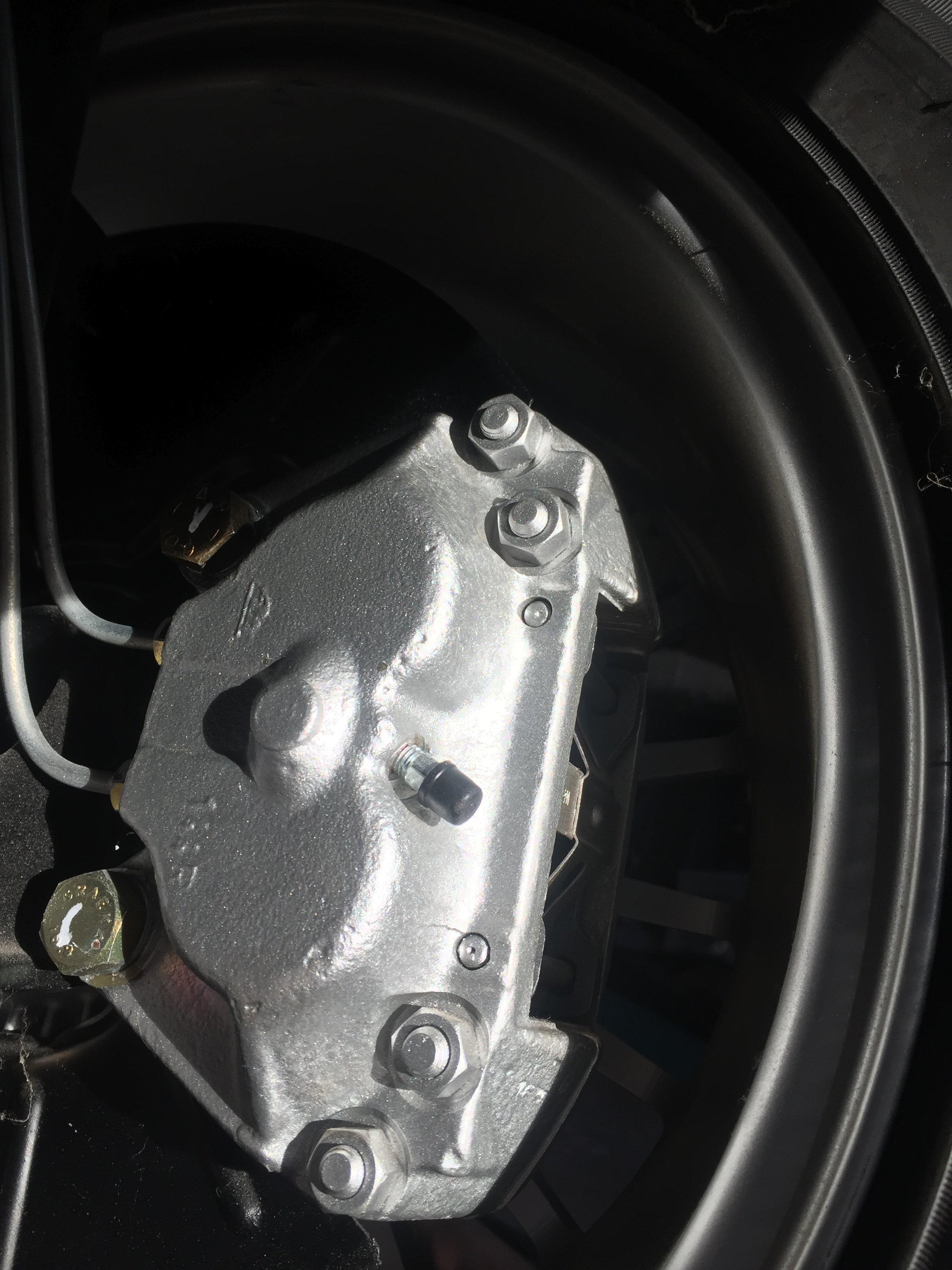

Inquiring minds will like this one...
Hint- the other two bleed screws are indeed pointing up.

The part belongs on the other side?

Off to the brake shop that did the rebuild- waiting to ask the question!
What's the problem Don, I just had my brakes done and now your making me nervous, I need to go and have a look and see what my brake shop did.....
Somebody took the calipers apart, then attached a left side back to a right side front, and vice versa.
Steve - only possible if you bust calipers in half while refurbishing.
Problem fixed. The brake shop that did the refurb' stamps the parts L with L and R with R and then puts them back together the way they found them, so they can't be blamed. Sometime, somewhere, somebody did the wrong thing.

I haven't sawed a caliper in half but remember clutch slave cylinders whose bleed screws pointed "the wrong way" until someone sawed one lengthwise and revealed that the bleed passage, in that position, went where it needed to and the orientation of the bleed screw was of no importance.
