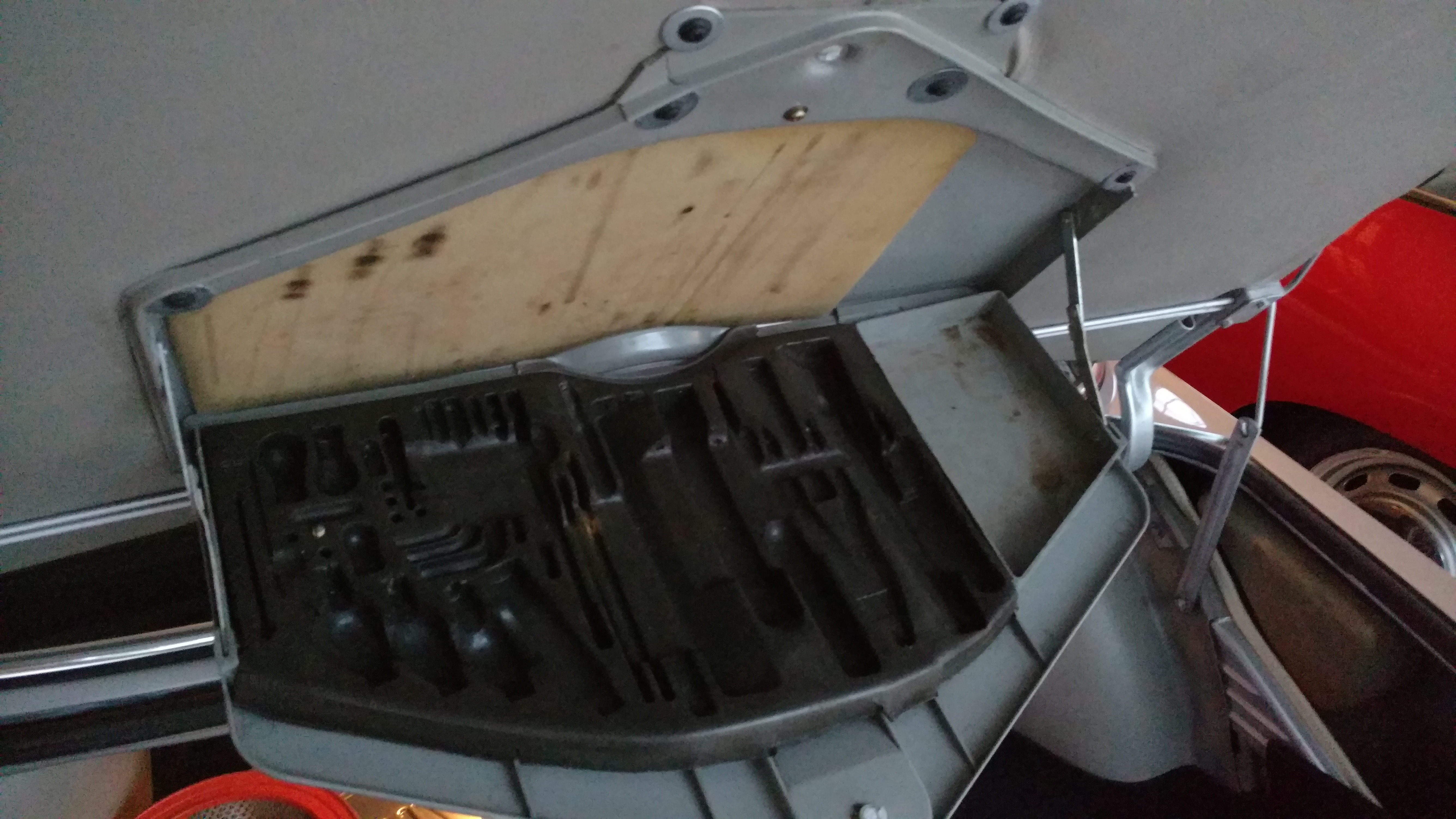

I am looking for a new tool box for the trunk of my 1974 coupe. On the W&N website they offer a new one for "up to '73" implying that '74 was different. Can someone confirm that '74 had a different box?
It's weird because BMW E3, E12, E21, E24 later style toolbox parts numbers 71111117105 (previous: 71111115327 / 71111113212) according to BMW catalogue can't be used in E9.In 1974 BMW changed the toolbox from a two piece part to a one piece part that has no lid. The construction material also changed to the thicker style used in e12/24/28 etc. They are different.
