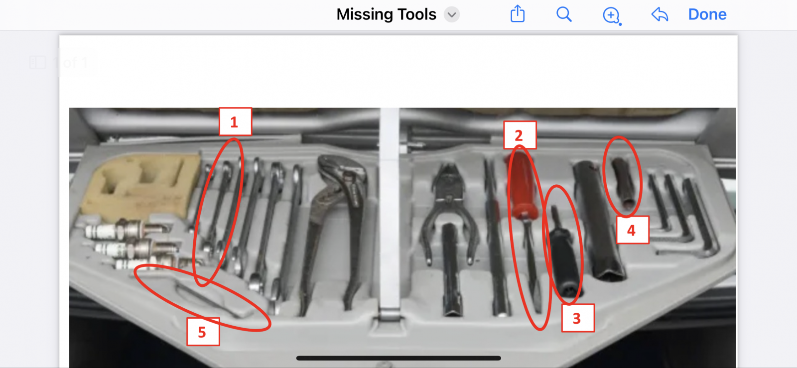

Is someone able to please identify tools #1 and #4 in the attached photo?
I am missing these 2 tools - so also interested in purchasing if anyone has them for sale!

1 is a 8-10 ring spanner. Original ones have 'No450' and 'W-Germany' on the handle and smooth chromed ends. No "BMW" on it, no Germany (did not exist yet) and not just "450" without the "No" prefix.
4 should be an spark plug holder.
