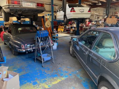

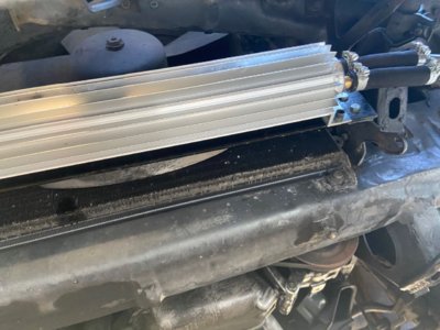

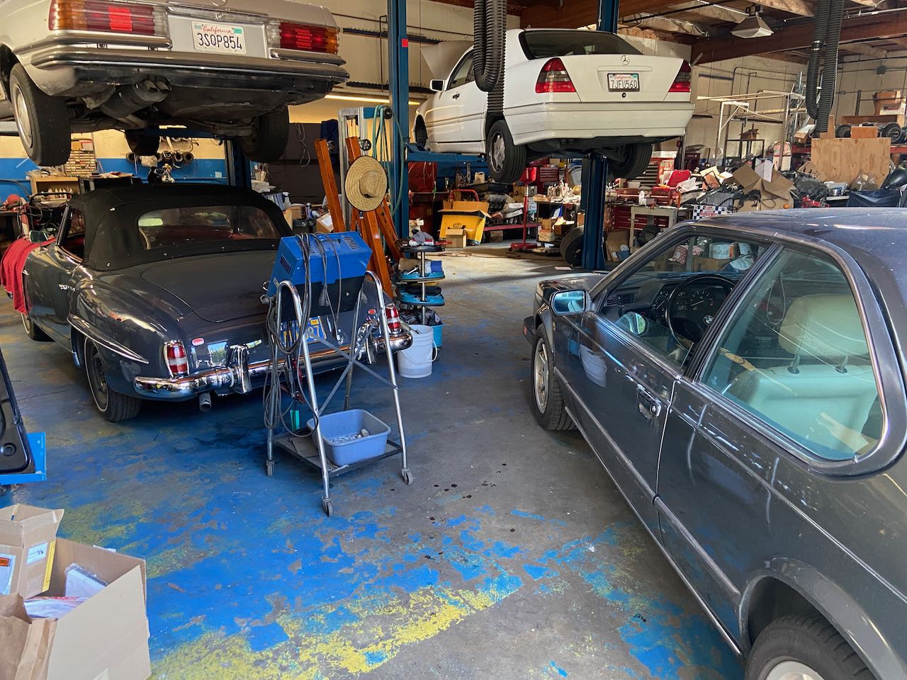

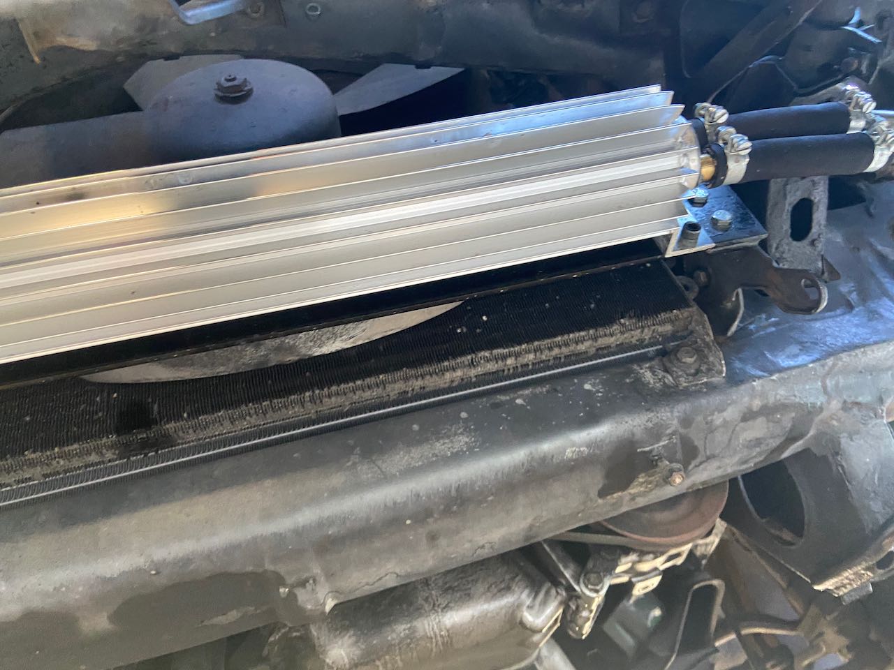

Car #7 is up! The E24 was in the shop to solve once and for all the vexing problem of poor Nissen radiator quality resulting in heat exchanger failure and coolant sucked into the automatic transmission. This time the shop (which does mostly Mercedes) installed a transmission fluid cooler ahead and below the radiator, I picked up the car and it is a blast to drive.
