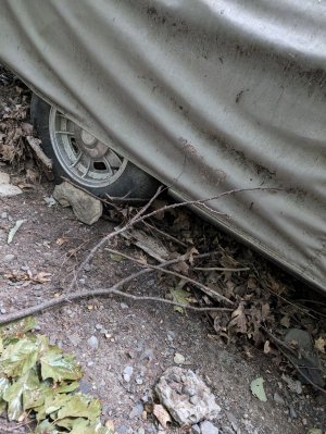

I experienced a minor disaster. We had a cloudburst with 3+ inches of rain in a short period of time. A torrent of water came down the hill and deposited sand and gravel under my 72 CS, which was parked with the rear end facing the driveway. The car is not damaged, but it would take forever to dig out all the debris before the car could be backed out.. The photo doesn't do the situation justice as the debris is packed right up to the frame. The car only has a front tow hook. Any thoughts on pulling it out?

Thanks for all the responses and PMs. I can't use the tow hook because I have no access to pull from the front. I think my only option is to dig, since the debris is packed right up to the frame. Is there a photo showing where to attach tow straps to the rear frame. Right now I can't see the underside of the car to get a good idea where to even start digging. I don't think that I could push it in it's present condition since the "upstream" tires are barely touching the ground. I'm not sure why the photo won't upload but it really doesn't show much.

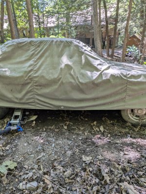

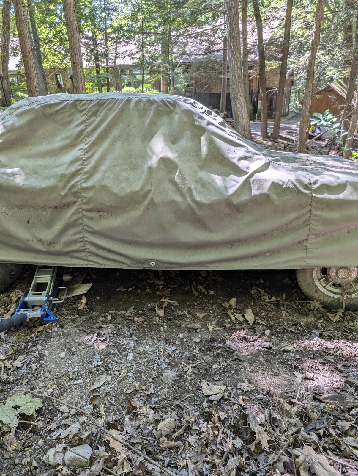

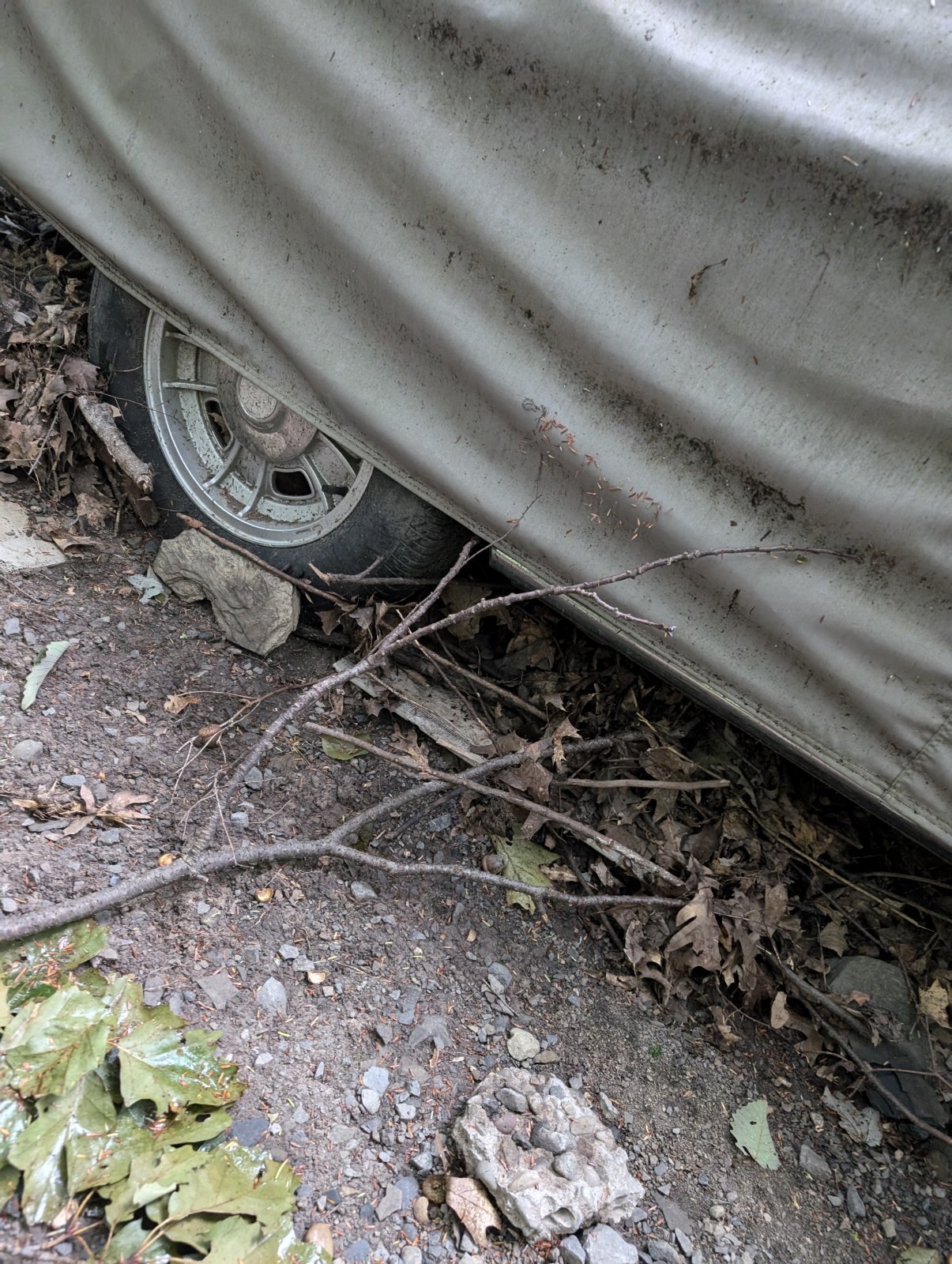

I agree that the posted picture doesn't show much. Any chance you could take a few more, all sides, from a little more distance so we could see the overall problem?
Success. Of course, now it just cranks and won't start. I need to investigate further to see if something got wet. I'm sure it's minor, because it started fine a few days before the storm hit. Thanks to those who suggested digging and everyone else too. It turned out to be not as bad as I thought, primarily because the debris consisted of twigs and leaves in addition to the gravel and rocks.
