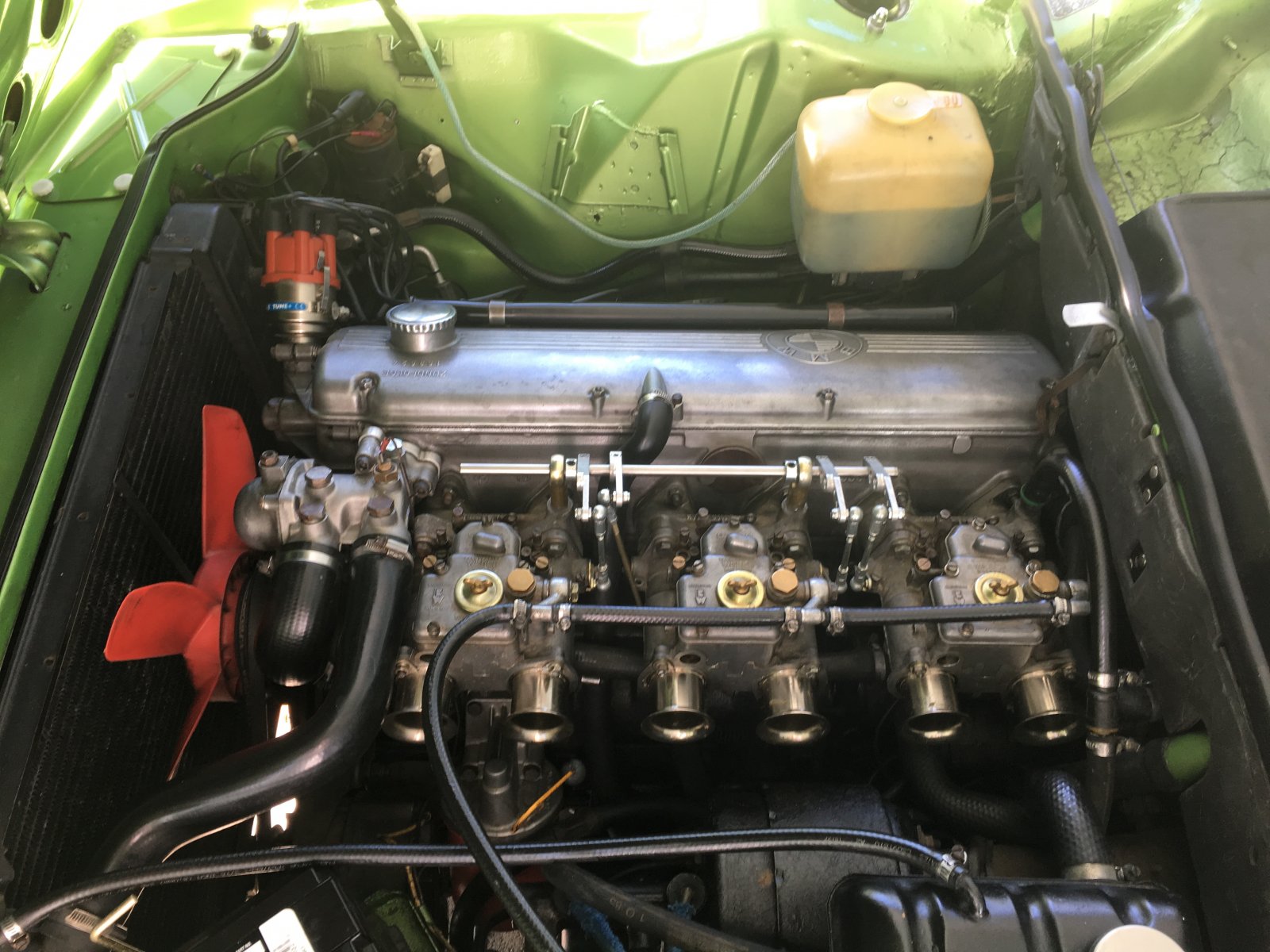

Using a stock E10 booster and the intakes are angled to clear the T-stat housing (can't remember the manufacturer of the intakes, british company).
3D printed stacks about 35 mm long.

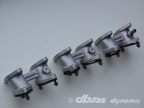

Myself have the Dbilas ones… had to change the thermo housing.

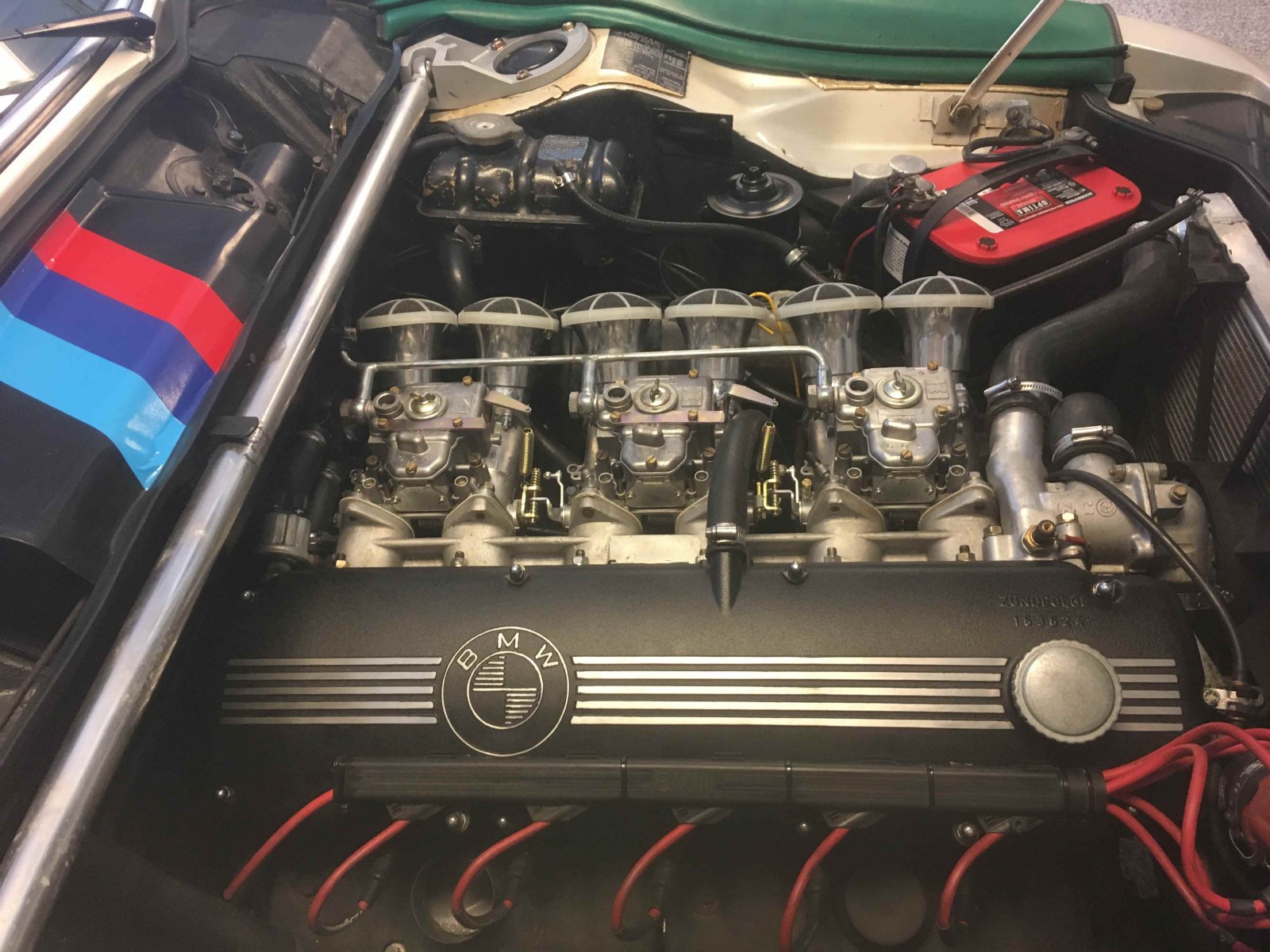

Karzunpartz intake manifold installed in the 80’s. It worked with the original thermostat housing but I had to add a spacer when I recently replaced it with a newer one. I cut a 45 degree angle off the bottom of one of the air horns to clear the original brake booster but eventually swapped it out with a tii booster,
