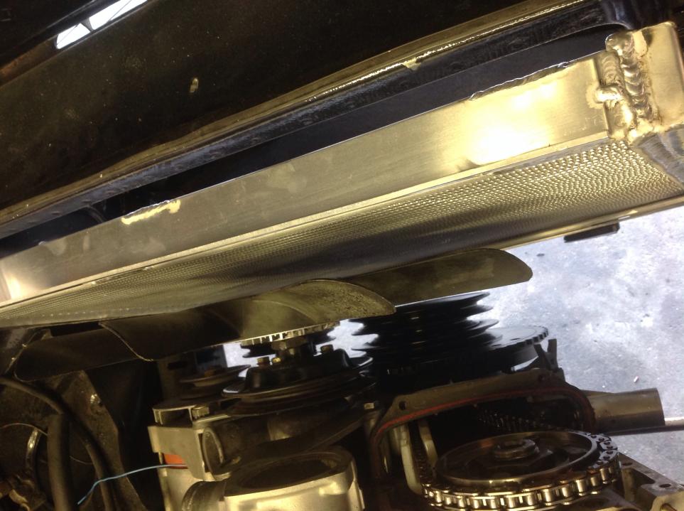

Small pulley from e34 to clock the pump (1 706 781) 5 inches instead of 6 inches
1 719 175 fan blade
And a new aluminum radiator.....
About 400 bucks
