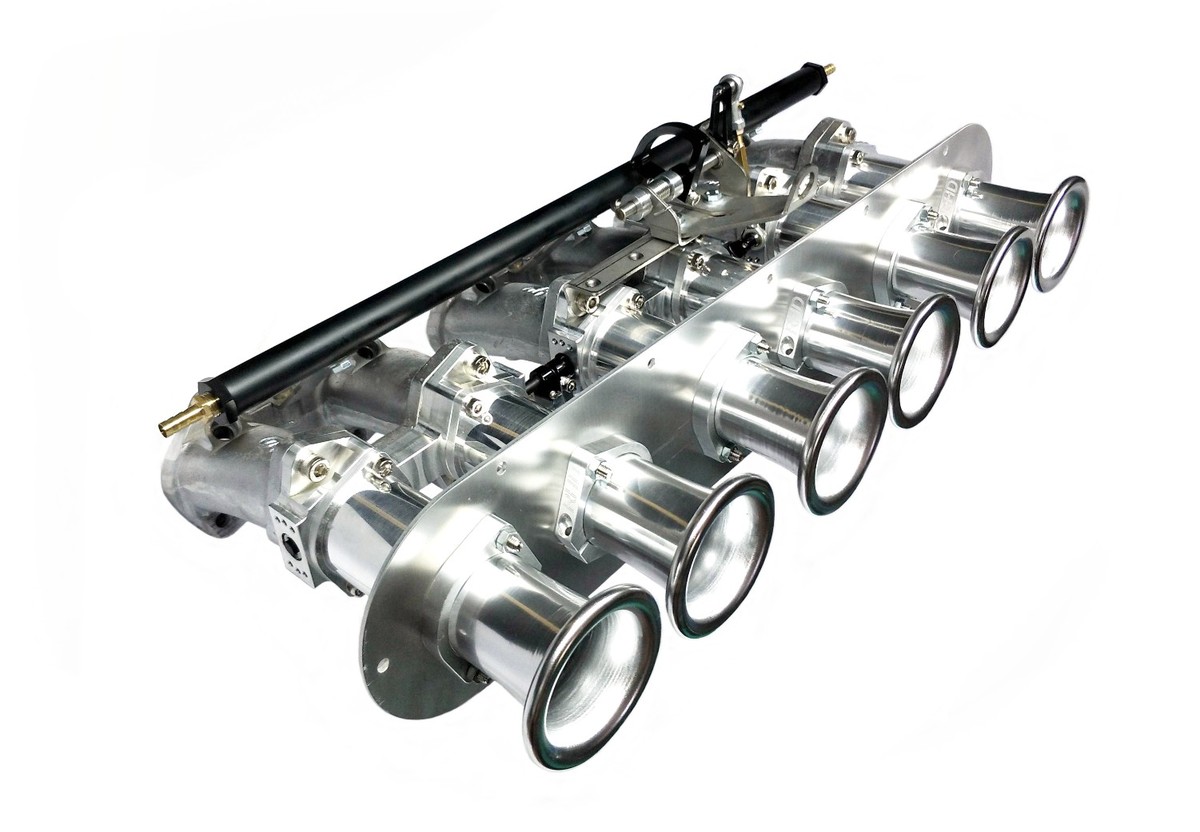

Has anyone attempted to install the DCOE Weber style fuel injection systems? One of my favorite memories is a friend’s 2800 CS with triple Webers. The sound and performance was incredible. So, I’m wondering what it would take to convert a intake system to one of the ITB fuel injection systems. Jenvey has a DCOE conversion in their Heritage line up. If I’m going to switch from twin carbs to FI why not one of these systems. If I need to use an independent ECU does it matter what the injection system is?
These systems are rumored to produce impressive performance. I’m very curious. Has someone already installed and configured one these systems?
First of all you should talk to your local dyno/tuning shops and see if you can find someone who is experienced with aftermarket ITBs, and they will tell you what ECUs and other stuff they're comfortable with.
Making a plan from the very beginning with the one who's going to tune it later is the easiest route and you'll avoid some unexpected problems.
Remember its more than an intake system - You need a different fuel pump, and a return fuel line. And if you want to go with one of the BMW in tank pumps, I think you need a different gas tank.
And an injected system designed to look like Webers won't produce the induction noise you get from carbs. You mention this is something you like; you should listen to a car with this type of fuel injection setup to see if it mimicks the sound of carbs (which I doubt).
I think it might make Weber noises to a degree. My GTV has MFI with individual throttle bodies, like the new Weber-look EFI systems. When I removed the stock intake and put on KN filters (called Quadraflow by Shankle)., it sure sounds to me like DCOE’s with stacks .

I need to go with some sort of FI. I travel from 5k ft to 7k and down to sea level for any of my scenic trips. Carburators are just not cut out for those large changes. So all of the gas tank/fuel pump and lines will need to be done anyway. The question is whether to try to convert to the 40 year old BMW system or something modern. I'll need an aftermarket ECU no matter also. But I hate being the guinea pig and trail blazer. That usually means wasted dollars trying to figure things out. I'll have to start a list of things required. I was hoping someone else has or had already gone down this path before. I could follow in their footsteps without making rookie mistakes.

Company in OZ makes these, and IIRC come complete with management system and harness. They look dead nuts on like Webers. IIRC they were in the neighborhood of $10K???? I wonder what the Jenvey prices out at for a complete system and if the OZ people are out in OZ
m5bb, that does not look simple. Youza!! That's way more involved than I care to dare. I can see $10k if not more in everything he did. Time alone looks crazy. Maybe dealing with my Webers at different elevations isn't so much of a chore!

Cheap: go with your desire and do DCOE’s. We’ve seen nice setups sell here for $1500 or less.
Best value: I would go with the proven, documented,and cost effective solution, BMW production EFI (Motronic).
befog, you're not being snarky - at all. I'm asking for opinions, so feel free to express them. Think of "if this was my car" what would I do. I've got a set of intake manifolds for a triple weber setup just in case I consider going down that road. I was just thinking if some of these new kits are as effective as they look.
