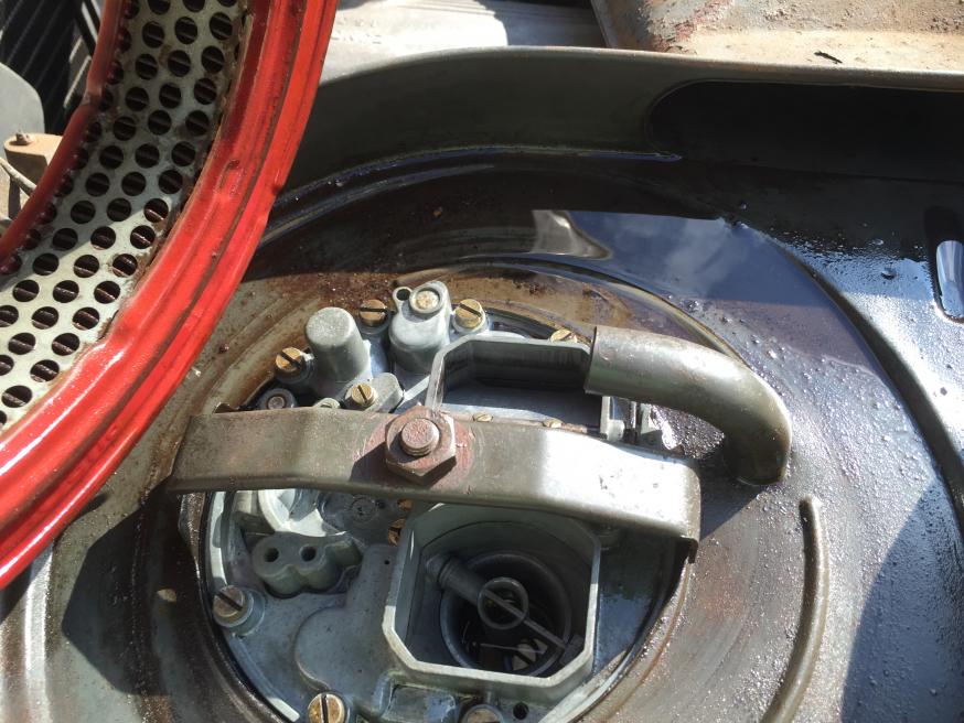

Then came the flood
My 2800 has been sitting for several months waiting for it's turn in the garage. I just got two new Pebra keys cut by keys4classics.com in OZ and wanted to try them out. I started up the car, which as is usual for it after sitting, took a fair amount of cranking to get fuel to the carbs. Usually it starts right up after the first cough, but this time it took several more tries. The idle was lower than I remember.
She smelled a bit gassy and I was thinking how much cleaner cars with catalytic converters are. I let it idle and opened the hood to survey the scenery. As I went around to the right side I was greeted by gas pouring out of the air cleaner intake at a steady rate. I raced to the open door and shut off the ignition. I'm thankful I put on new spark wires when I got the car, or things might have gotten quite hot.
Pulling the cover from the air cleaner, it's obvious the front carb was where the action was. Gas was pooled in the air cleaner, the new gaskets below keeping it from running down the outside of the carbs.
I had not read about the dangers of over tightening the nut on top of the carb until after I had reinstalled the carbs after cleaning them and putting in new gaskets. I suppose it's possible that the top as warped and thus the leak was from the float bowl. Odd that it wasn't flooding the engine since it was flowing freely.
I'm letting the gas evaporate and I'll investigate further in a bit.
Any other suggestions?
I'll have to look and see if the OEM nuts are still available too.
Ian
Video of the moment of realization.
https://youtu.be/ApjfLwwS1ls

Sounds like your float needle valve either is hanging up or has dirt in it preventing it from closing properly
Yes, maybe, perhaps.
I'm hoping it's the needle valve. I kept the originals installed when I opened and cleaned the carbs, the ones in the kit seemed inferior.

Well
you opened up the carb to clean and the gaskets were inferior .IIRC.
What that means is that the gasket over the float is probably slightly larger not letting the float come down. The tolerance is close even on a proper gasket.
Just pop the top and trim the gasket is my recommendation. Easy fix to prevent happening again.
You could take the vent off and force it gently down. But that's a temp fix.

i found this fault when this happened to me, i trimmed the gasket just like i do in this video.
http://youtu.be/EmGxdiCYYYI
this is a nine video collection of how to reassembly the carbs, number 2 and number 3 shows how to trim the gasket to avoid the floater get trapped
hope it helps
And there lies the answer, I hope
Excellent advice from the forum! Thanks to all for the input.
The leading suspect is a too large gasket hanging up the float. Spanish isn't one of the languages I even come close to fluency in, but DeQuincey's video made it quite clear where the issue might lie.
I'll get the top off the carbs in a bit to check it out but other projects have priority.
