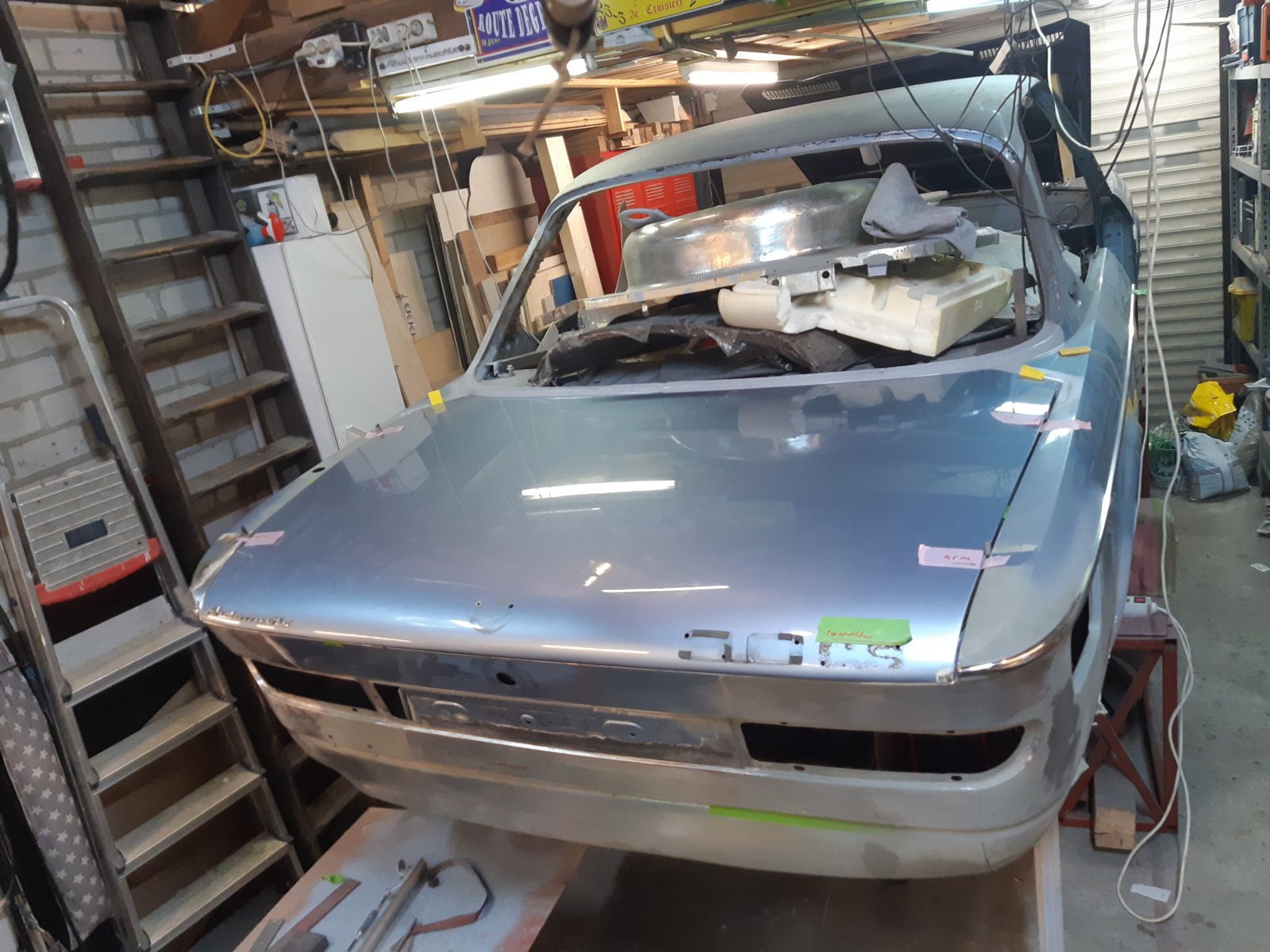

remove tank to get access from below. Lay down the lid, fit, but not fasten the 4 bolts and 4 nuts on the hinge inside the trunk compartment.
I then set the left right gap with small metal plates on 4 corners (the pink tape), and set the height correct with a helper (you need someone to tighten he screws, and someone to check outside if the height is correct or not. Then tighten the 4 nuts on the hinges + the 4 bolts to the lid.
The gap now was nicely between 4.5 and 4.7 mm on the four points.
I then had a lid with a fit near perfect, only the corners to the window were not nicely flush. In the end the only thing that remains is brute force; bending it by hand. I used a metal lever to bend the corner of the lid a bit upward. Mind you, I still need to paint the car, so i don't worry to much about scratches; but i think it can be done relatively scratch free.
After bending, the gap (up/down) at rear now good enough for me:
Also front of gap is now ok, though it could be a bit higher at the edge:
