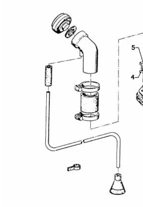

Check this venting from the filler neck, the hose shall have an outlet to the underside of the car (rear part of the tank) The hose may have popped of the rubber sleeve.
On USA models, the vent does not go thru the trunk floor, it goes to the expansion tank and has a blue hose that runs thru the car to the charcoal canister under the battery
Any reason not to place a new charcoal canister in the truck and use the blue line to run forward to the air filter or vacuum port? Seems cleaner than cluttering up the engine bay. I know Euro cars just dumped it out of the boot floor but the US way has to have less gas smell.

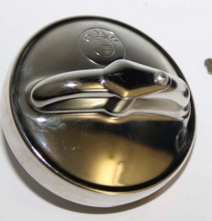

However, I've noticed that my (lockable) fuel filler cap has the marking "airtight" (luftdicht) on it.
This means there were also fuel filler caps marked "vented" (belüftet)
which vented into the rubber boot an so in the trunk to.
Please double-check this...
