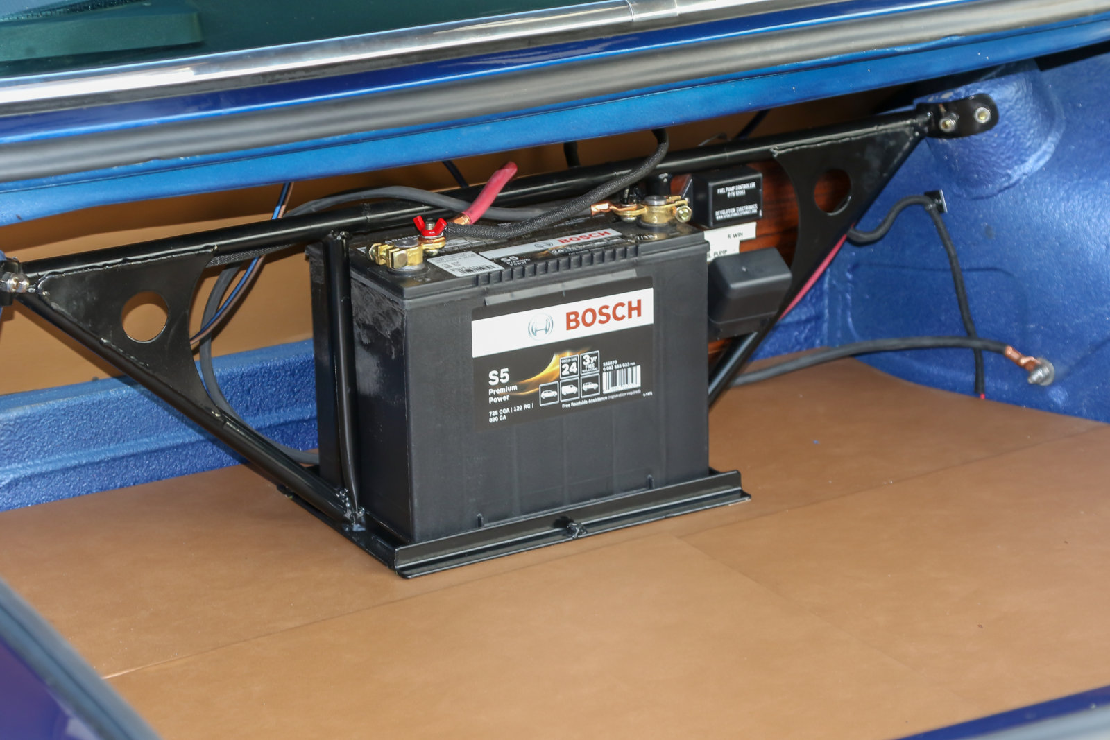

Moved my battery to trunk. Ran properly sized cable down passenger side and through firewall at cavity next to wiper motor (passenger) and installed an E46 connection box there that you can hook jumper cable to if necessary and have to go in trunk. + cable then goes along firewall down to terminal beneath power steering res. Then + power goes to starter etc. Ground cable in trunk connected to body with 8mm bolt and lock nut. Made sure it was a really good ground. So far ok.
Also have small fuse box in trunk for e28 window motors with 10ga wire and power for fuel pump (which is great as I can pull the fuse if I want key on). Power for amps under rear seat as well.

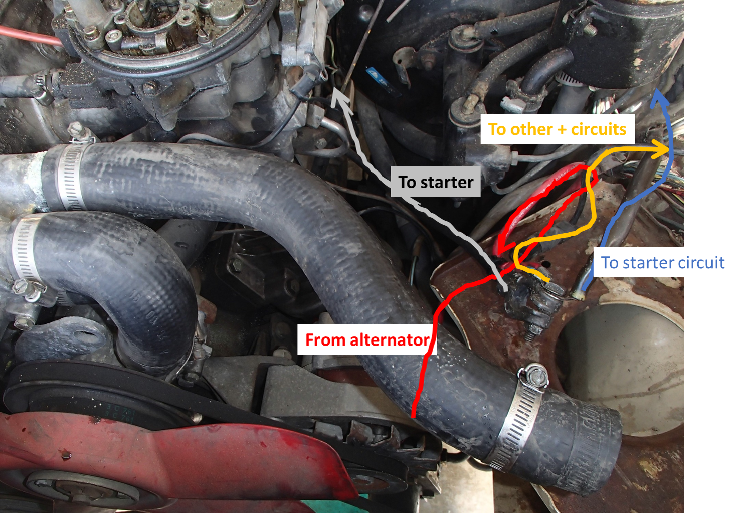

I pulled together this picture of the wiring at the + battery terminal from a photo I took when disassembling the bavaria. I drew lines and arrows on it that identify the connections at the positive battery terminal.

Bill -- I have some experience with electrical before I bought my coupe, and have done a lot of work on my coupe because of problems I found. Your labels are actually a good way to think about the connections to the battery.
1) The alternator to battery connection is used to charge the battery;
2) The battery to starter connection provides cranking power to start the car;
3) The "to other circuits" connection provides all of the unswitched power for the vehicle. A few of these connections are wired off of the battery to relays (headlights, horn, etc.), but most of these run through the fuse block; and
4) The "starter circuit" wiring you show is actually switched power, which runs through the ignition switch and then to the fuse block.

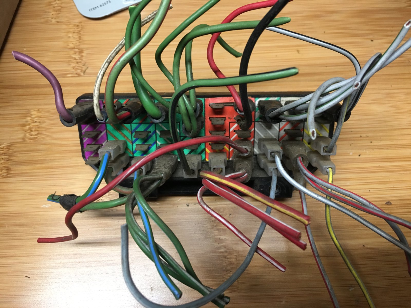

In general, switched power runs to the fuse block and is distributed on the back of the block across two fuse circuits. Unswitched power is also distributed like this. Here is a fuse block, I believe from a 1973 coupe (my 72 is somewhat different).
The large red wire connected here at the top of fuse 7 is unswitched power wired directly to the battery. The other spade connectors in the solid red area of this fuse block are also unswitched power, wired directly into whichever wire goes directly to the battery. In this picture, that black wire underneath the red wire is connected to unswitched power without a fuse. The area underneath the solid red area beneath fuse 7, here designated as red with white stripes, is unswitched power subject to fuse number 7. Note when troubleshooting, the wires subject to fuse 7 are connected. You can see on this block a connector with a single red/white stripe wire and a connector with three red/white stripe wires. Because these are both connected to lugs in the red with white stripe area, they are connected and form part of the circuit downstream from fuse 7.
Similarly, the area beneath fuse 6, designed as red with yellow stripes, is unswitched power subject to fuse number 6.
Switched power is also distributed before the fuses. The fat solid green wires at the top of fuses 4 and 5 are connected, as are the fat green wires on the spade lug beneath the fuse 5 wires. If you look closely, you will see a solid green background behind all three of these spade lugs. This connects these lugs electrically. The green with white stripes area underneath fuse 4 is switched power subject to fuse 4, and the green with black stripes area underneath the fuse 5 connections are fused switched power subject to fuse 5. In both cases, on this particular fuse block, there is only one switched, fused connection for each fuse.
