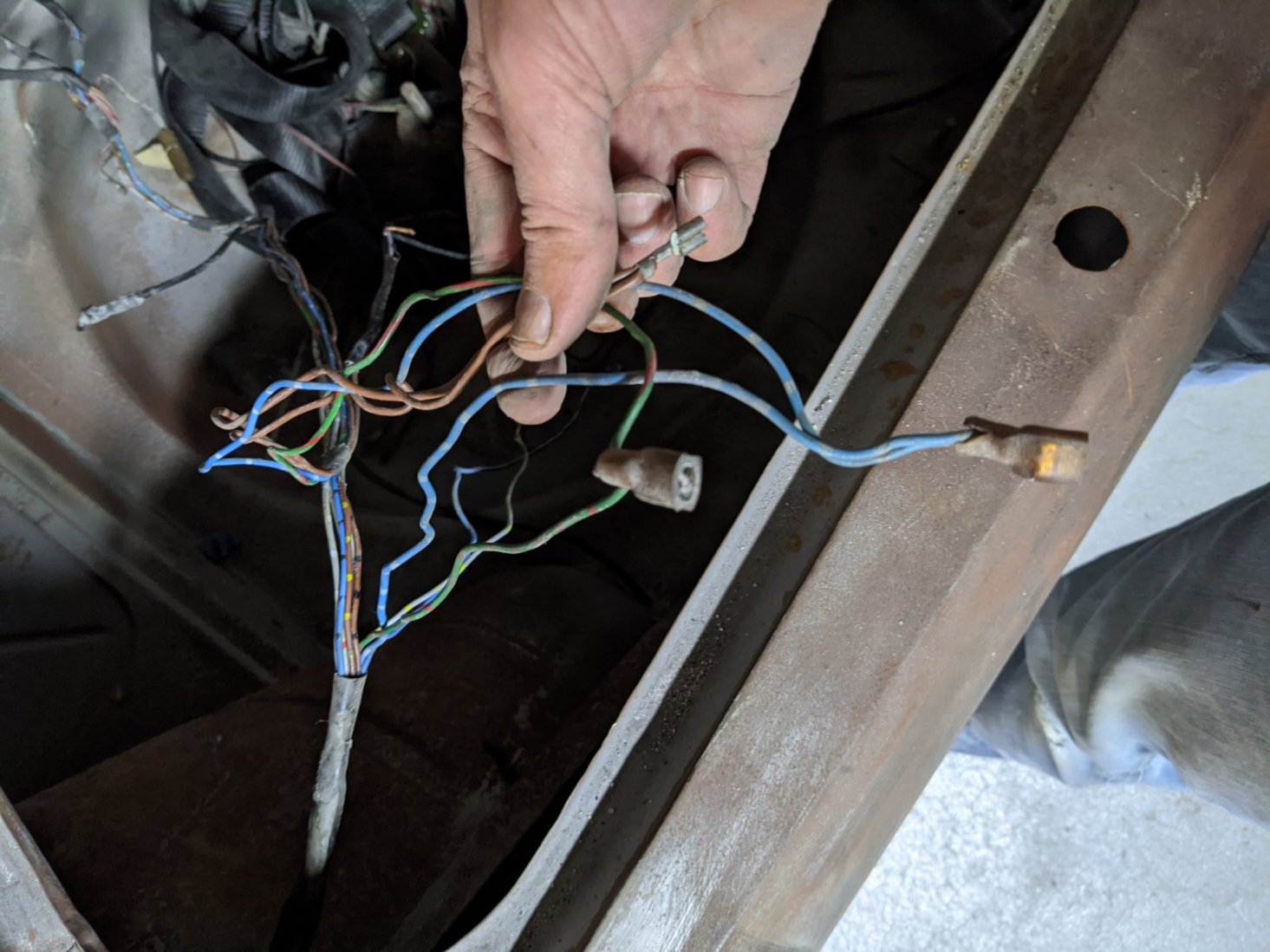

Problem 1: My main obstacle is a bracket between the wheel well and frame next to the driver side rear window (very small). I get I will need to unravel the fabric wrap (whatchamacallit), but with so much wiring going to the taillights, I’m guessing I’ll have to separate wires at the connectors?

A pic to the trunk wiring

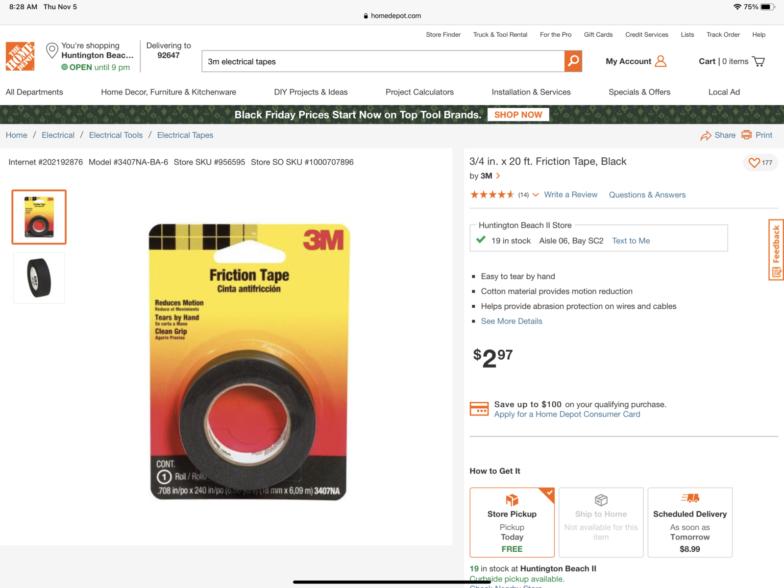

It should fit in that opening, just go slow. Home Depot has 3M electrical tape which is a cloth tape which works well, other tapes are a bit wide.

It all fits. The only thing I couldn’t fit through that hole was the d-jet fuel pump plug. Your car doesn’t have that plug. You shouldn’t need to unravel the looms but any bundles of looms will need to be separated.
