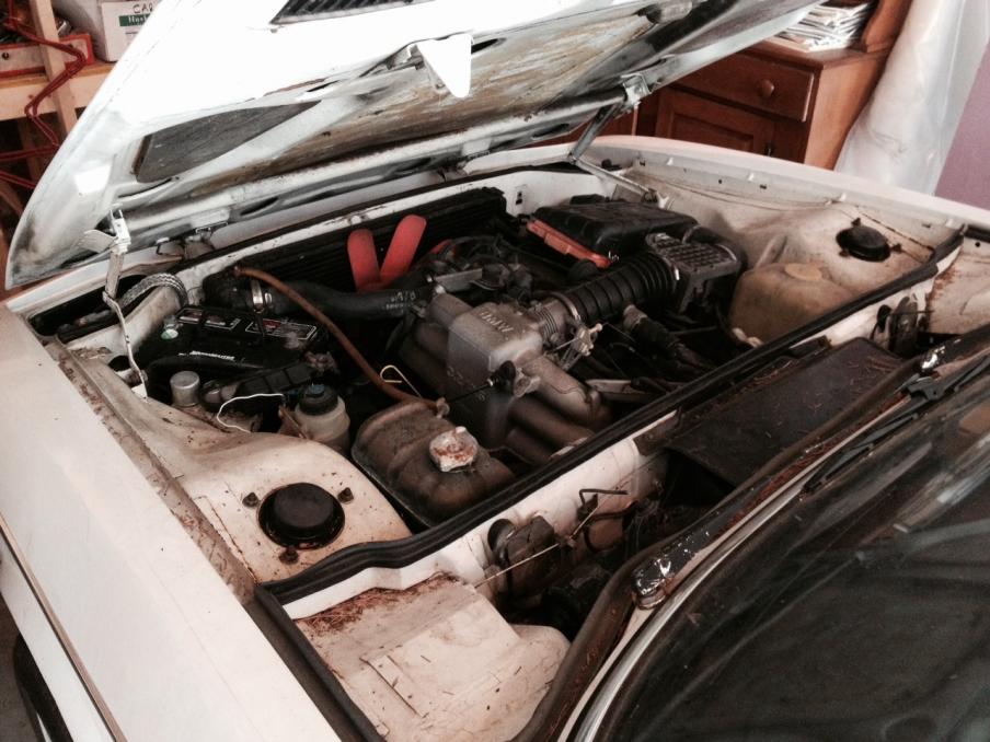

The coupe has a newer motor and 5 speed transmission in it. Not sure what year or car the motor came from. See attached photo. It has the following numbers on the intake 3.2/3.5 and 1270676 and the head has this number on it 1277358.
Can somebody tell me what these numbers mean. And with this new motor will the wiring be a nightmare to figure out?
And car has not run for a few years. Looks to have had some mice in it. Could have damaged some wires.
Thanks.

Those are casting numbers and not much use. Is there a vin on the side of the head (a tag) or on block above starter? You can plug that into RealOEM. Looks a 635/735 intake manifold.
Assuming that motor was transplanted complete from the donor car, that looks like a B34 setup, which would be from an '85-'88 E28 535i/is, or '85-'87 E23 735i or E24 635CSi.
Fairly simple setup, if it was done properly there shouldn't be much in the way of nightmares.
US m30 b34 intake with US Motronic ICV with m30b34 intake struts.
Run a compression test to see which pistons you have.
What computer?
Which AFM ?
