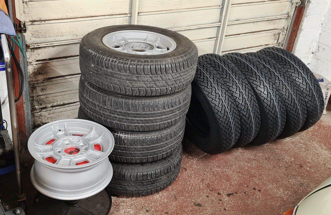

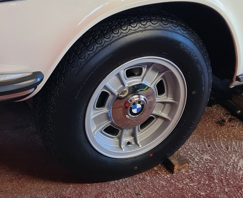

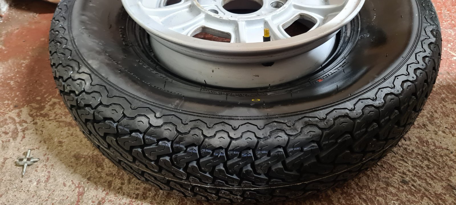

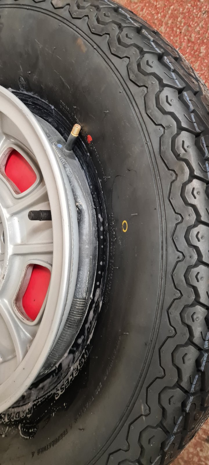

I've had a bit of a saga with fitting new tyres on the 6J alloys. I purchased a set of 185 HR14 Blockleys (equates to 185/80 R14 according to them), their spec' states a maximum 6" rim width and specifically say these are ideal for E3/E9. So I had a mobile fitter come around in December and he couldn't achieve a seal as the tyre beads are so far collapsed to the centre that they won't push out onto the rim to effect a seal. He tried the usual methods, bead blaster and igniting ether but nothing worked. So I bought a cheap set of inner tubes purely to expand the beads out and allow them to sit for a couple of weeks to hopefully "relax" the walls making it easier for them to be aired out onto the rims. So the fitter came back today and they were exactly the same as before. So I gave in and just had him fit them with the tubes. My question is, these are tubeless tyres on tubeless rims, is it unsafe using them with tubes fitted ?.

Thanks. I do currently have tubes fitted on my Mini (10" x 5" rims) but only because the wheels are period items from the 60's and were designed to be used with tubes. The tubes I bought are definitely not bias-ply but neither are they particularly great quality as I never intended them to be fitted, only used to expand the tyres. They were however bought from a reputable source who generally sell tubes to the classic car market so I think they will be ok. I am annoyed however at the difficulty in getting the tyres to seat on rims that the manufacturer actually states they are suitable for. Having contacted them they just say that they can be a difficult fit but if I'm not happy I can return them, which is a great help when they're already fitted.

Did all four wheels fail to seal? It just seems surprising that your 185/80 R14 Blockeys would be too wide (*) for stock e9 wheels, since that is the original size tire for these cars
*) I presume that "the tyre beads are so far collapsed" means that your tires need a wider rim to address the rim edge properly.

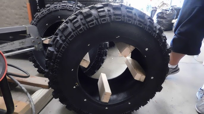

Sidestepping your tire tube question, your problem is not that uncommon on farm/tractor equipment. Have you tried one or more strap wrenches (or similar) around the circumference of the tire - to force the sidewalls outward? Here is a video that may illustrate the concept.
It's the opposite. The beads are so far inboard of the sealing surface that it is impossible to achieve any seal to enable them to move up onto the rims.
I tried a ratchet strap on the spare and it made no difference. For this to work the bead needs to at least be in contact with the sealing surface. On these there is at least an inch clearance so it's impossible to achieve a seal. I am experimenting with a method I saw using a bicycle inner tube to bridge the gap and this worked, unfortunately the tube became trapped when the bead popped onto the rim so I had to deflate the tyre to remove it and it dropped back off the rim. I'll keep trying with this and if successful will have the tubes removed and repeat on the rest of the wheels.
OK, now I understand your situation (the photos helped), but I certainly don't have the answer. It seems that your Blockey tires are just shaped improperly when not pressurized.
Has anyone else besides your mobile fitter attempted to get them to seal? I wonder if he knows all the tricks, has all the equipment for situations like this.
