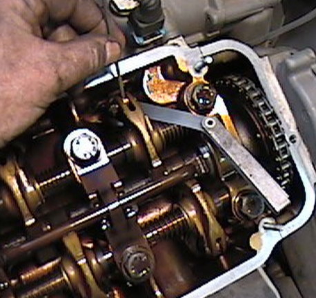

I agree with the others. Given your description, it is unlikely your valve lash is causing cold run issues. However, if you are driving the car and especially, if you are pushing the revs, you should not ignore the valves. If for no other reason than peace of mind, you should check them.
There are many "how tos" just fingertips away. Checking and adjusting valve lash is considered "routine maintenance" and covered not just in the shop manual but also in the "owners manual."Same with ignition timing. The manual even recommends an interval for checking the lash. A copy of the owners manual is available on this site (p71?) http://www.e9-driven.com/Public/Library/Documentation/Owners Manual/3.0 CS-CSI Owners Manual.pdf
So is the more comprehensive repair manual: http://www.e9-driven.com/Public/Library/BMW-E9-Manual/pages/en/index.html
And while your exploring your carburetors, you might want to look here: http://www.e9-driven.com/Public/Library/BMW-E9-Manual/pages/en/13.html#refertoc
Naturally, there are other variations on the same theme: Autobooks, Haynes and Chilton, to name but a few.
Here's even more: http://www.nmia.com/~dgnrg/page_5.htm
http://www.bmwe34.net/E34main/Maintenance/Engine/valve_adjust.htm
http://www.youtube.com/watch?v=_ubwFXgU_nM&feature=related (Note: This method is a little unorthodox as adjusting valve by measuring between rocker and cam is not depicted in most repair manuals. Perhaps because inserting feeler gauge on the cam may tend to introduce grit and/or scratch the cam surface.):?:
