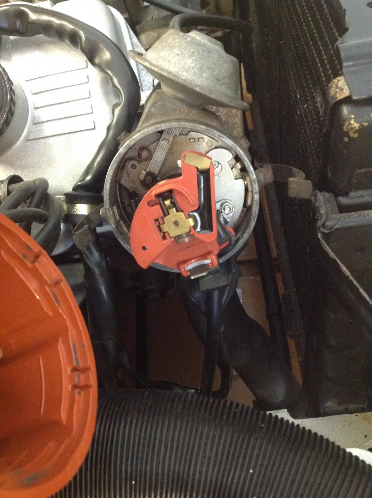

Are you running the original distributor with trigger points? If so, the curve may be off after 45+ years of use, mine was. Replaced with a 123 distributor, yet keep the original as a back ip with points & condenser. Can tell the difference between the two. 123 is smooth, original pulses slightly.
good question, I'm not 100% sure what my ignition is. I'll stick a photo up. It defo doesn't have any points however, so it's not original.
I can't feel any play in the dizzy shaft however, and the timing gun shows a steady and clear mark on the vibration damper.
