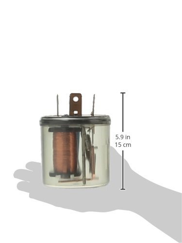

I forgot to mention the flasher I ended up with ... NAPA EL-13 Electronic flasher, easy to acquire.

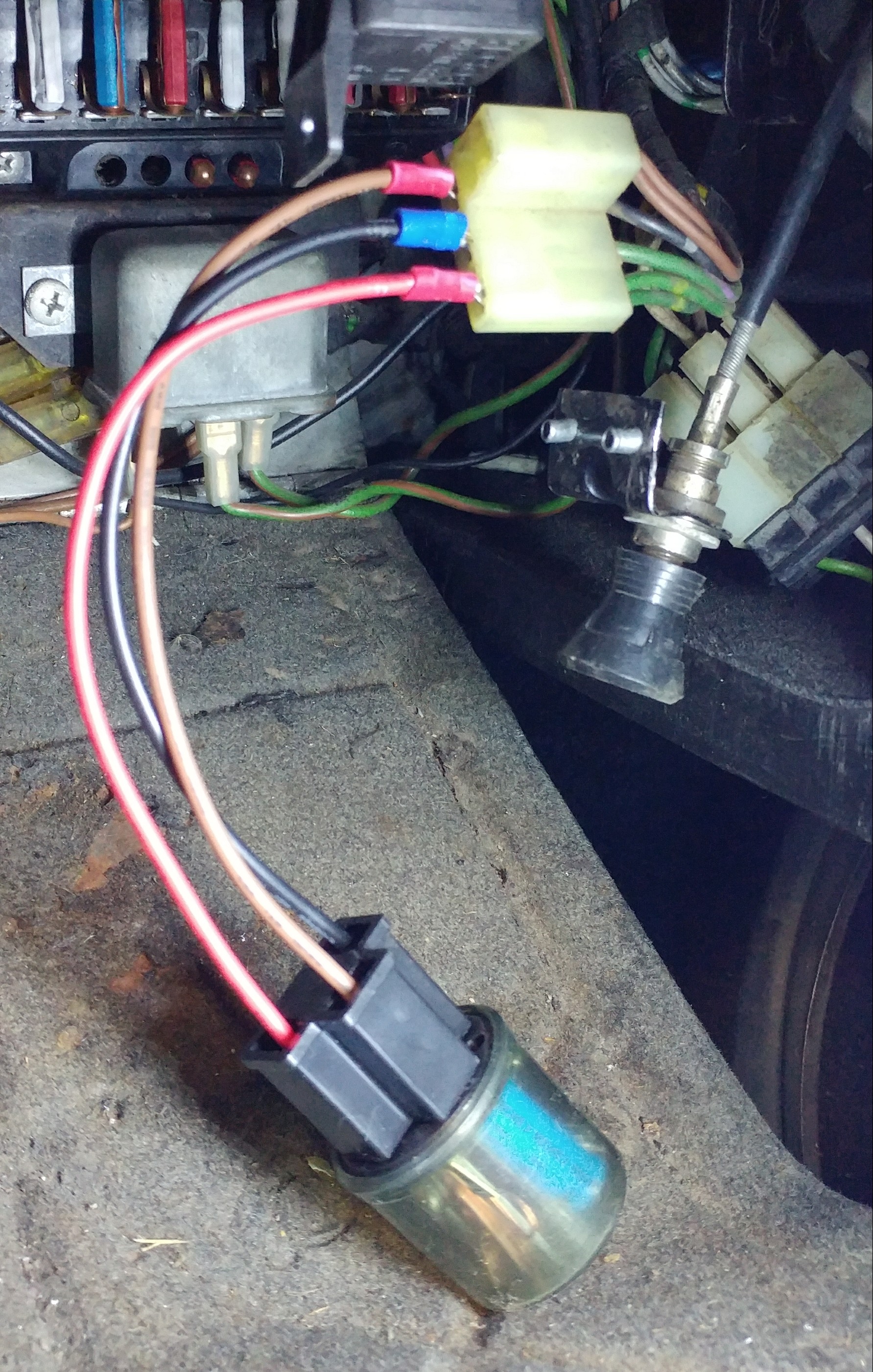

OK, I got my electronic flasher conversion done, using the EL-13 part that Rusty mentions. My local Carquest store cross-referenced that NAPA EL-13 number to their own 7312. The flasher I got says "Carquest 7312" on the box, but the part inside is marked "cec EF-33", which makes sense - that's the CEC number shown in the left column of the table I referenced in post #9 above (I have no idea what "CEC" stands for). My cost after tax was $12.95
The Littlefuse EFL300 number referenced in the BMW2002faq (see post #6 above) seems to be obsolete - I tried O'Reilly and NAPA, as well as Carquest, and none could find any reference to that number, or to the different manufacturers' cross-references on the table I referenced in post #9 above.
Only quirk (trivial) is on turn signal cancellation, there is a half "pulse".
Yea, mine does that too. Sometimes 1-1/2 extra pulses. So with my old flasher, the indicator bulb would quit early - now it puts in overtime!
Worked great! Now consistently blinks including on the dash.
Bought the flash unit on Amazon
NOVITA EL13 Flasher https://www.amazon.com/dp/B001I1QPNG/ref=cm_sw_r_cp_apa_50IgAbFGJ3Y82
And the plug on eBay
https://rover.ebay.com/rover/0/0/0?mpre=https://www.ebay.com/ulk/itm/400667177039
