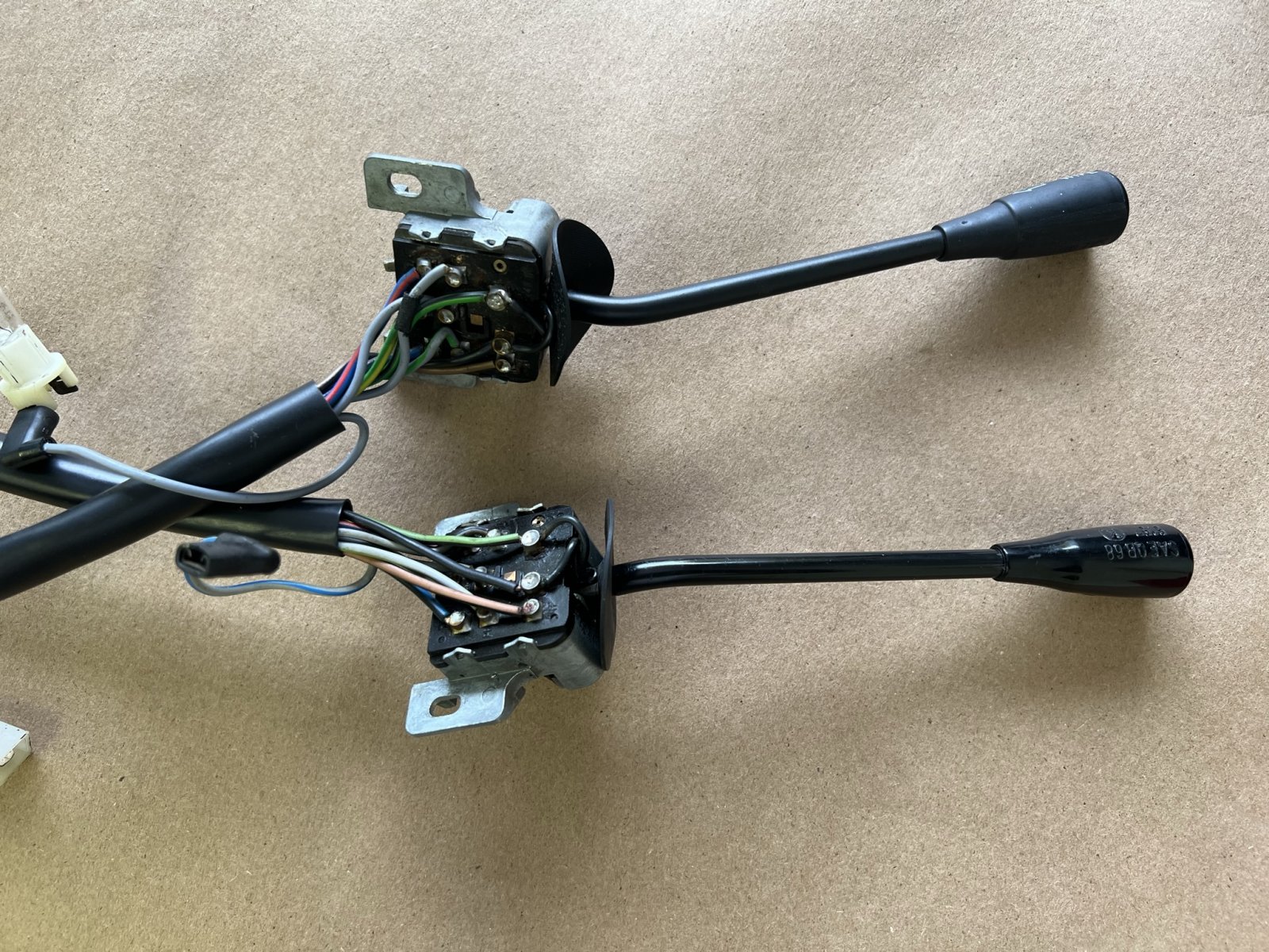

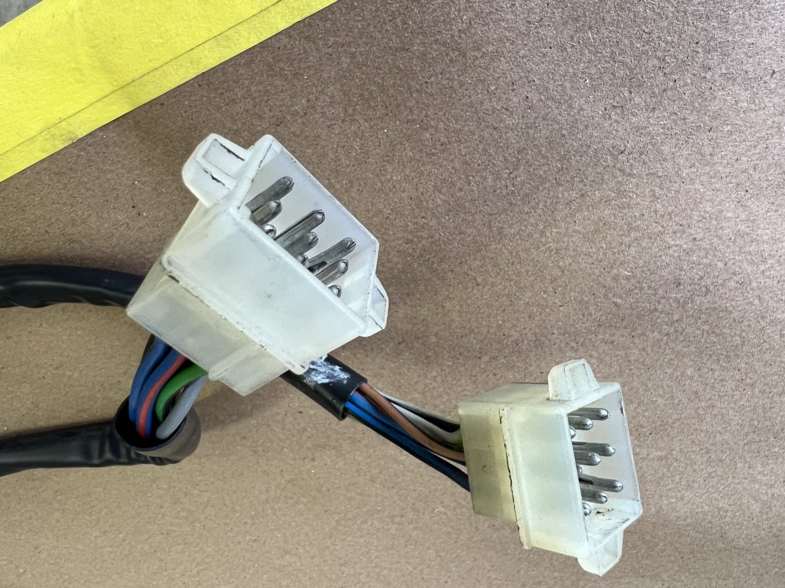

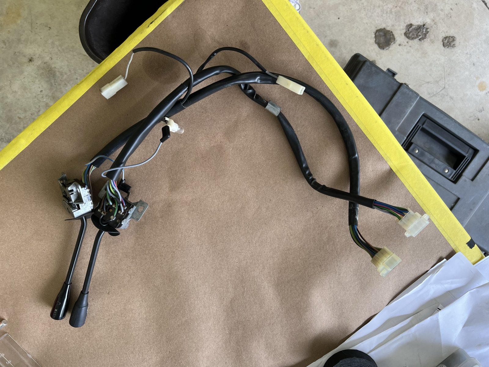

I was able to buy a NOS turn signal stalk on EBay. My original stalk only worked sporadically. After 3 different blinker relays, I knew the stalk had to be replaced. The mechanical parts worked,but the electrical circuits/contacts needed work.
Here are pics of the old and new stalks.
The turn signal switch can be easily moved to the left by buying a later model BMW---:)
