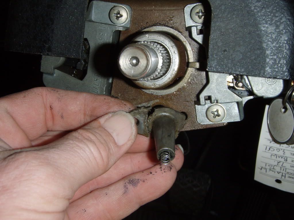

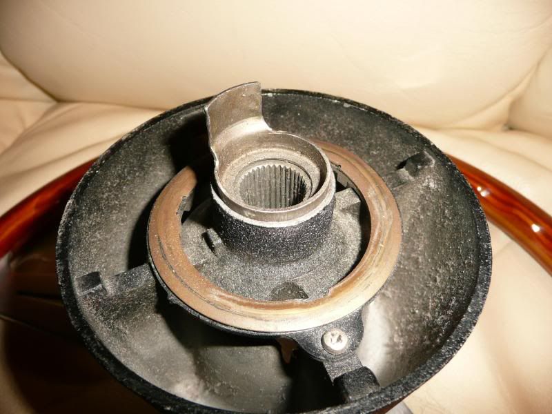

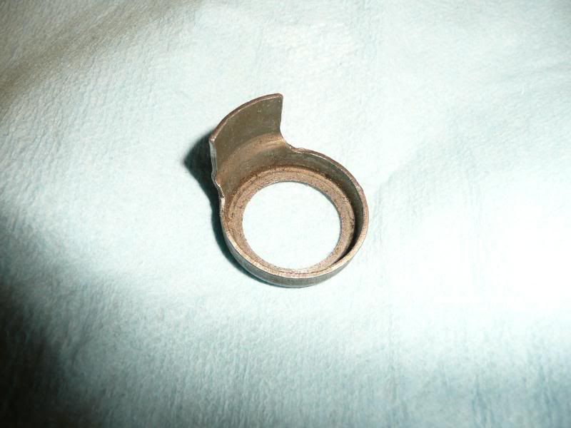

Per the pictures, the switch is activated by a cam that is a separate part of most steering wheels. It is bendable and thus adjustable. It can also be repositioned by the use of a washer and, if memory serves me, the switch itself has a tiny bit of wiggle room. As has already been suggested, your cam may be barely functioning/connecting with the cam so that a tiny bit of body flex with the front suspension at full extension makes a difference. This can occur both laterally and longitudinally - especially if washers, spacers or shims are used in the case of an aftermarket steering wheel or hub. Look carefully at the last picture and you may note the protruding turn signal triggering mechanism on the right hand side of the steering shaft. Do NOT attempt to bend that part of the switch - or you will likely regret it.
