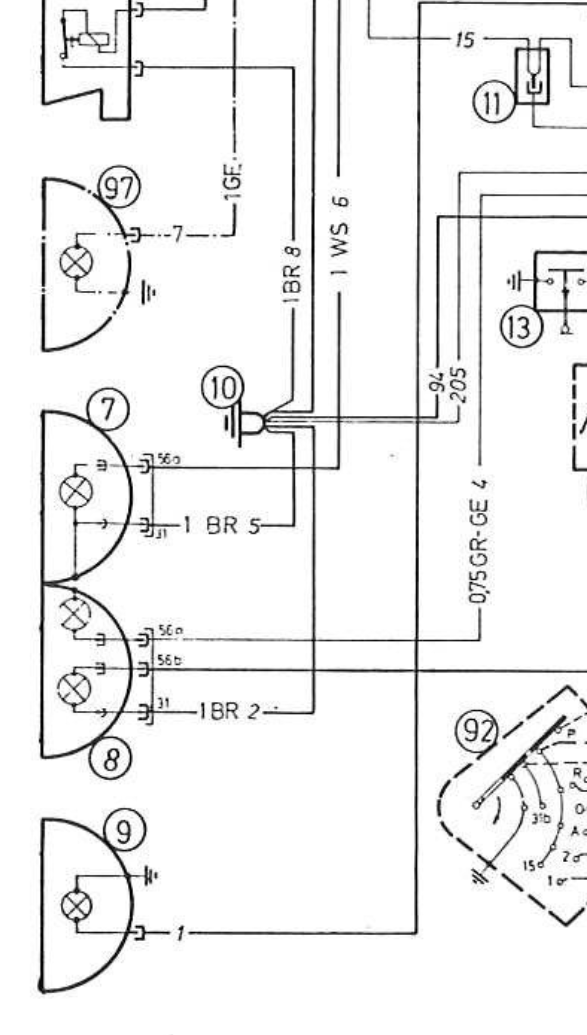

Search on the forum seem to bring up the issue of the 2 wires (in addition to the ground) that go into the front turn signal assembly but without definitive conclusion on how it might affect this issue. My wiring diagram shows only one wire (blue-red on LF, blue-black on RT) going to the turn signals. On top of that, the bulb itself only has one contact at the bottom and it seems to bridge the 2 pins of the bulb holder. So it should not matter which wire goes to which spade.

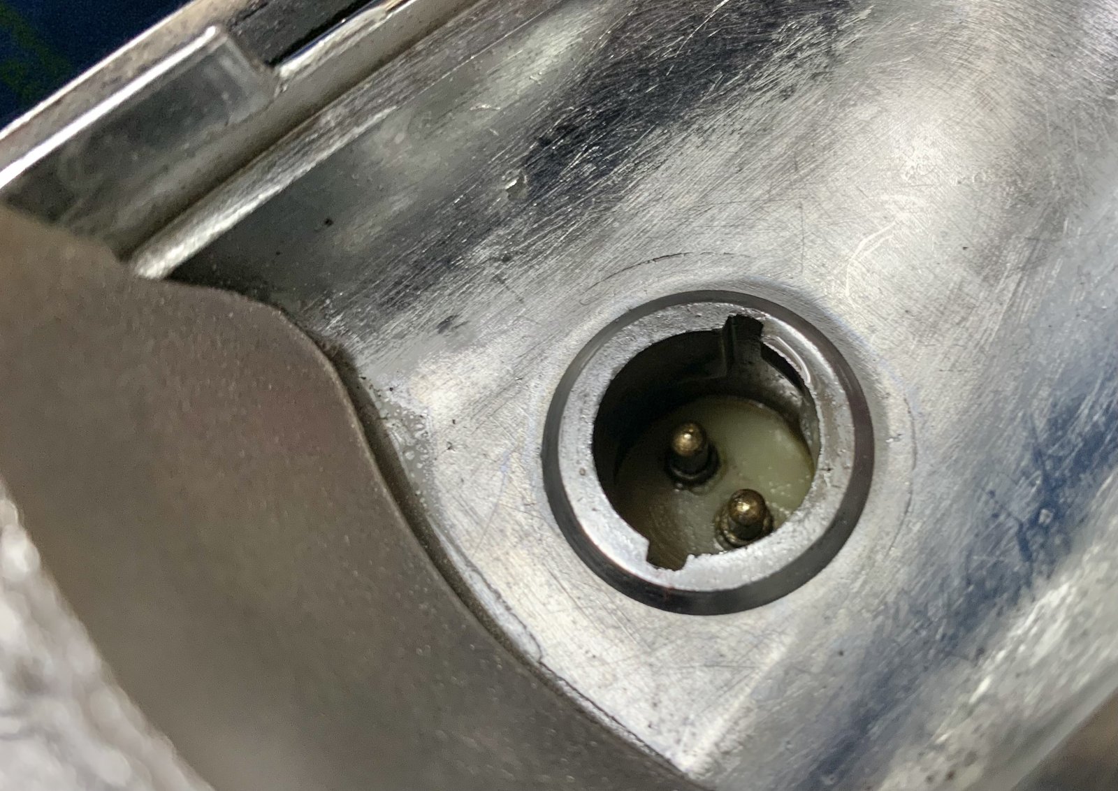

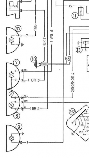

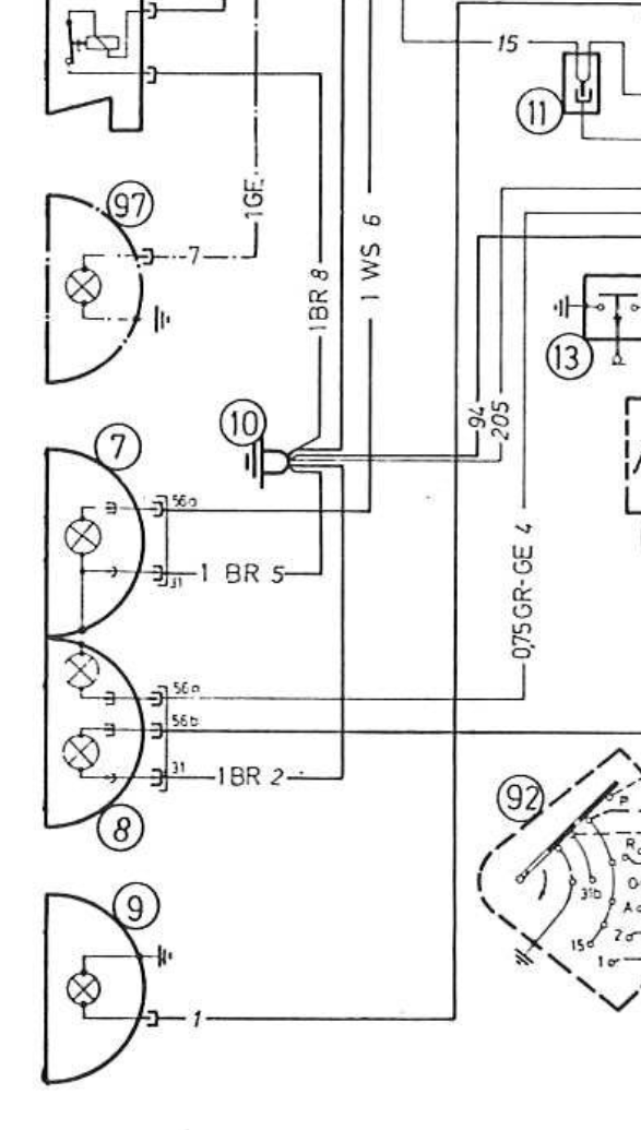

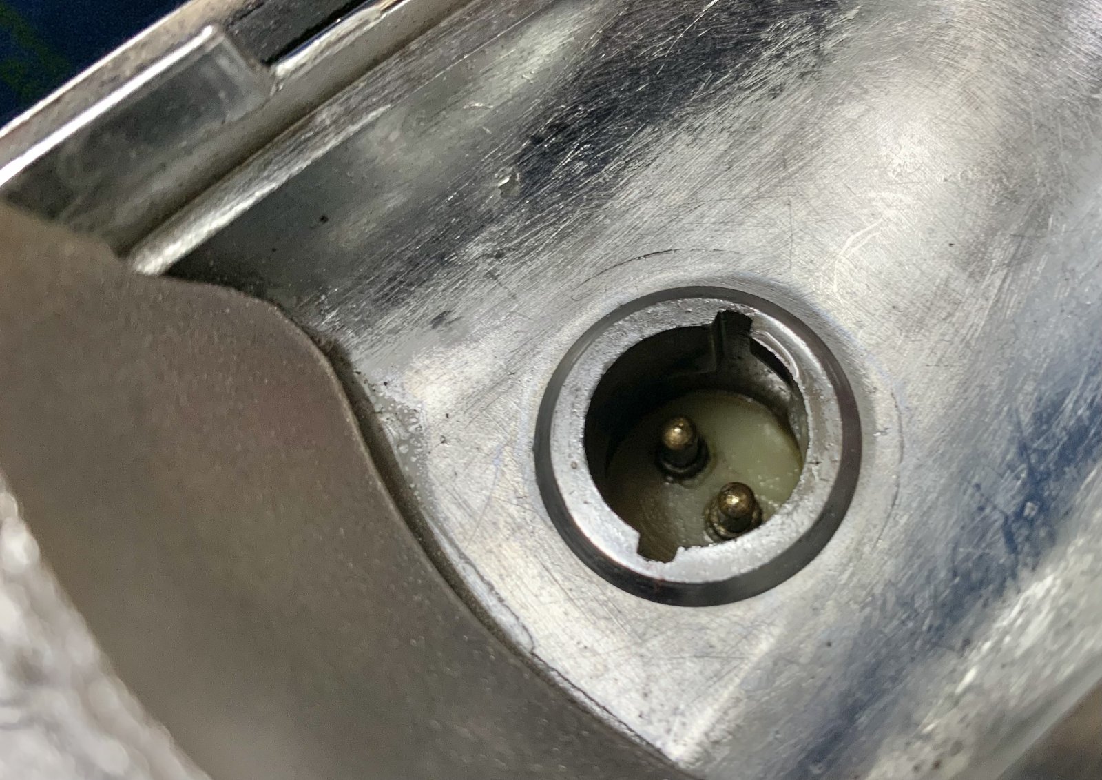

I had always been puzzled by the fact that the front turn signal housing has 2 wires coming in. Blue-red and grey-yellow on the LF side. My schematic only shows one wire coming in. There is however a grey-yellow (GR-GE) going into the low beam light. So it seems to continue onto the turn signal for some reason.

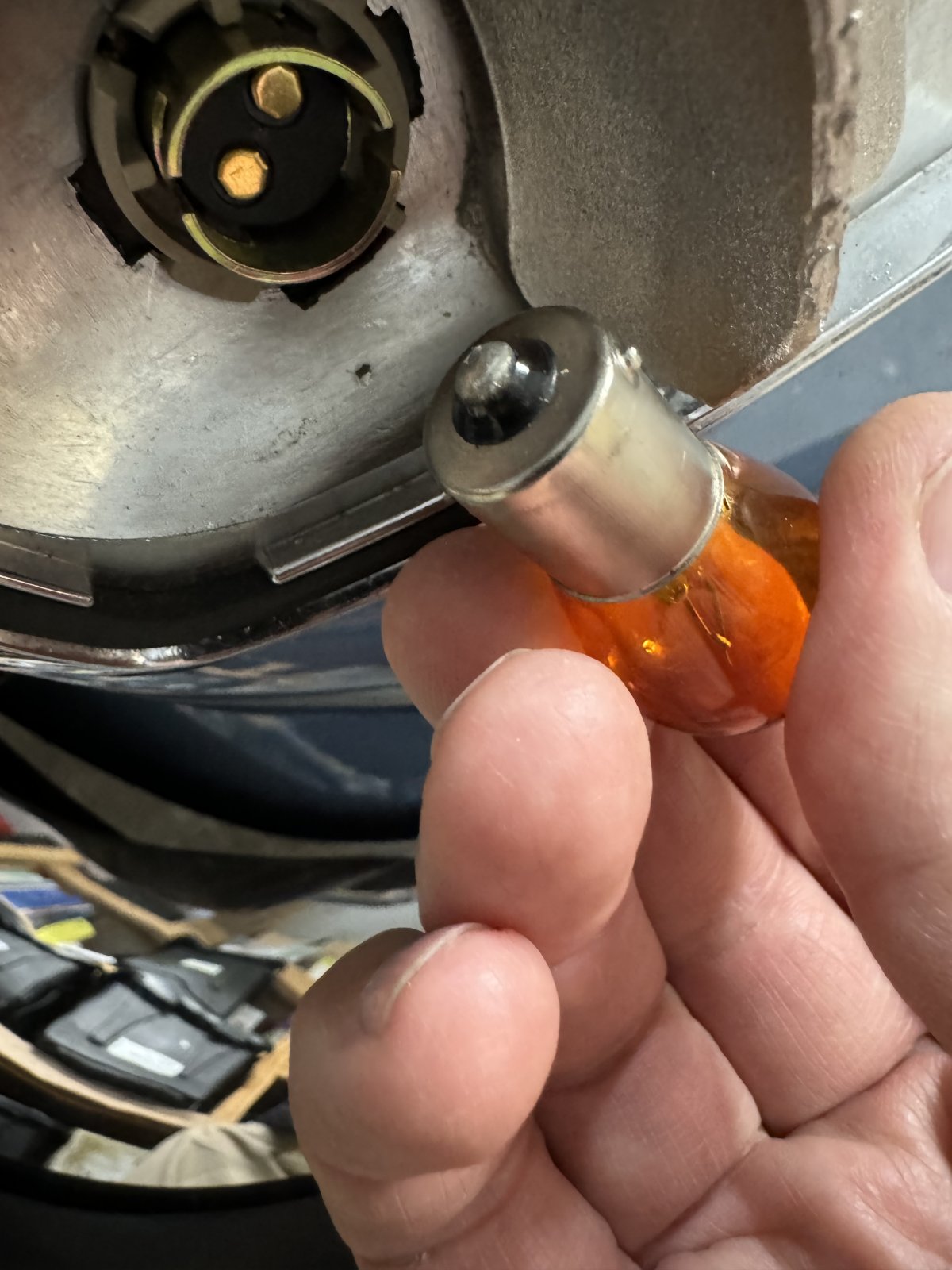

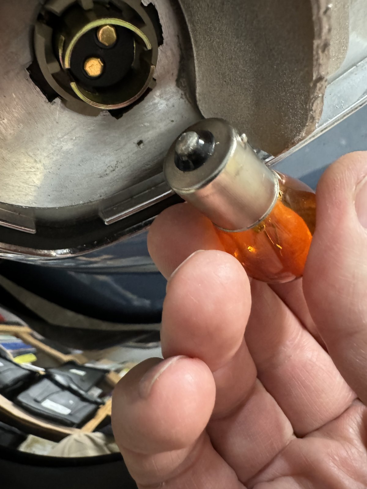

The bulb I have (which came from Walloth Nesch) only has one contact at the bottom and it seems to short the 2 connectors when it is installed
Note that my original bulb holder broke so I had to replace it with this newer version. But the original had similar 2 pins:
So I decided to remove the bulb to see if that made any difference. And sure enough that made the blinker work correctly, at least on that one side. Since the front bulb was out, that meant that the rear now worked as it was supposed to.

Since that grey-yellow wire has constant 12v as soon as the lights are turned on and since the bulb shorts out these 2 contacts, it's no wonder the turn signals stay on.
So:
- Why is grey-yellow headlight wire also coming into the turn signal? I am guessing it is for the parking light option. (Does anyone ever use that?)
- Is the bulb supposed to short both of these wires, therefore rendering the blinking part inoperable? That doesn't make sense. I am guessing that this is where the problem is. The turn signal bulb should have 2 independent contacts going to 2 different filaments which can be activated individually. One for the blinking, one for the parking light.
Does that make sense?

Yes, that makes perfect sense. You have 1156 bulbs in the two front sockets (single filament) and should have 1157 (two filaments). Install 1157's (available for a few bucks at your local AutoZone) and you should be good.
The 1157’s arrived yesterday (thank you Amazon one day delivery) and sure enough, they solved the issue. One has to be careful to wire them correctly as one filament is brighter than the other.

Happy to help. I enjoy solving these puzzles, though I have to admit that I never would have guessed that there was an 1156 bulb in a socket designed for 1157's.
The two studs coming out of the sides of the bulbs' brass bases differ between the two types: they are at different heights on the 1157 to ensure that you get the bulb oriented properly (i.e., with the brighter filament connected to the turn signal circuit). See the photo below - 1157 on left, 1156 on right. So how a 1156 would have even fit into a 1157 socket is still a mystery.

Mystery indeed. I checked the old bulbs that were there when I first got the car and they were the 1156 also
BTW, on the Philips ones I got, the “shorter” filament on the left pic in your post is the brighter one. That one should be connected to the flashing signal
