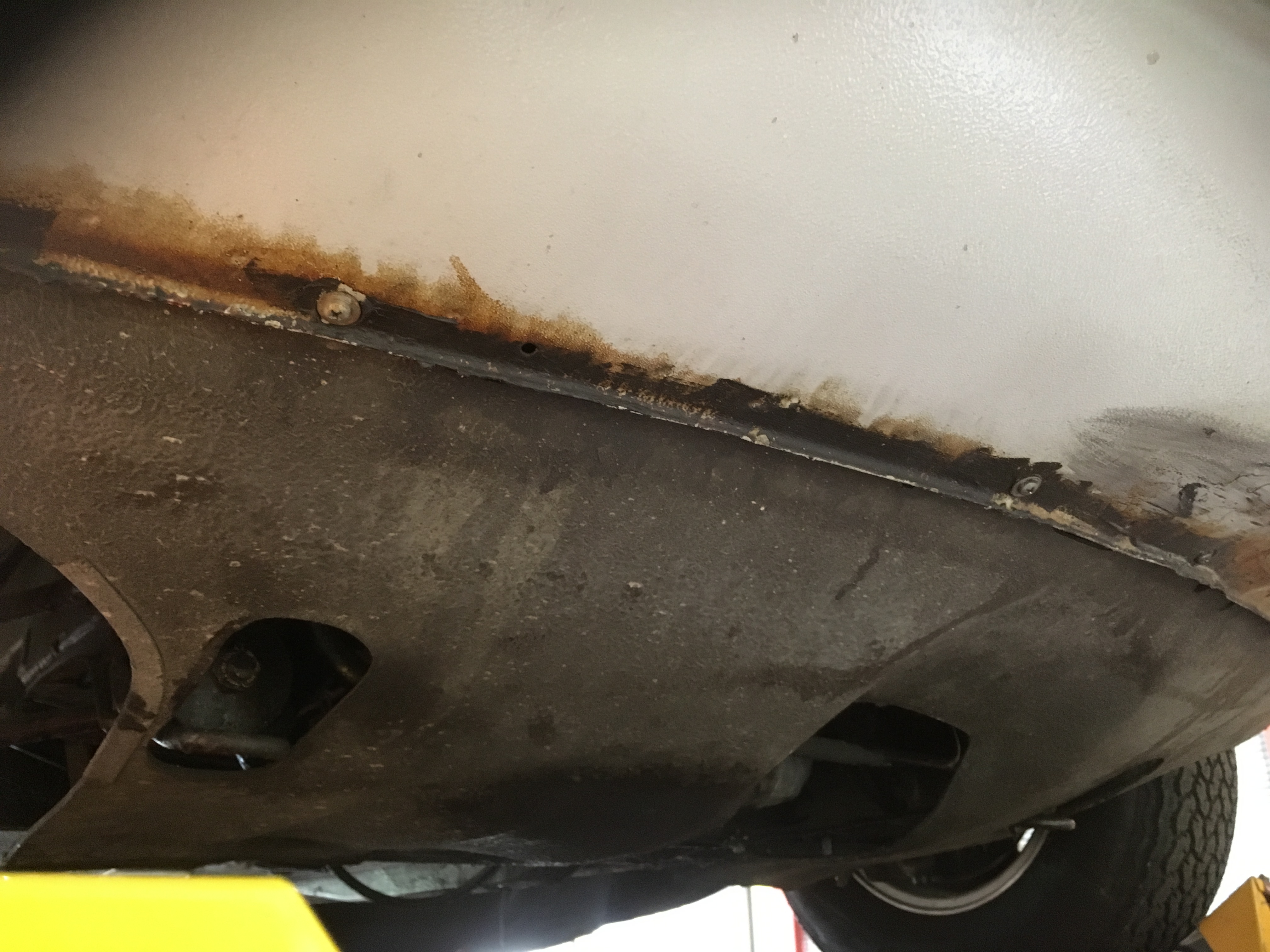

Anyway, I had some work done to my '71 E9 which required removal and replacement of the splash shield under the front. I think it looks different now and was wondering if it's supposed to be outside the metal lip under the front or inside. It's inside now.

Undertray is in the correct position. IIRC there are a couple of locating tabs which are on the bottom (outside) of the metal scuttle.
Looks like it may have been previously incorrectly mounted.
There are a number of threads on air cleaner color depending if you have the green or grey color.
As far as I remember, there is clear photo of the correct positionning in the blue binders .
