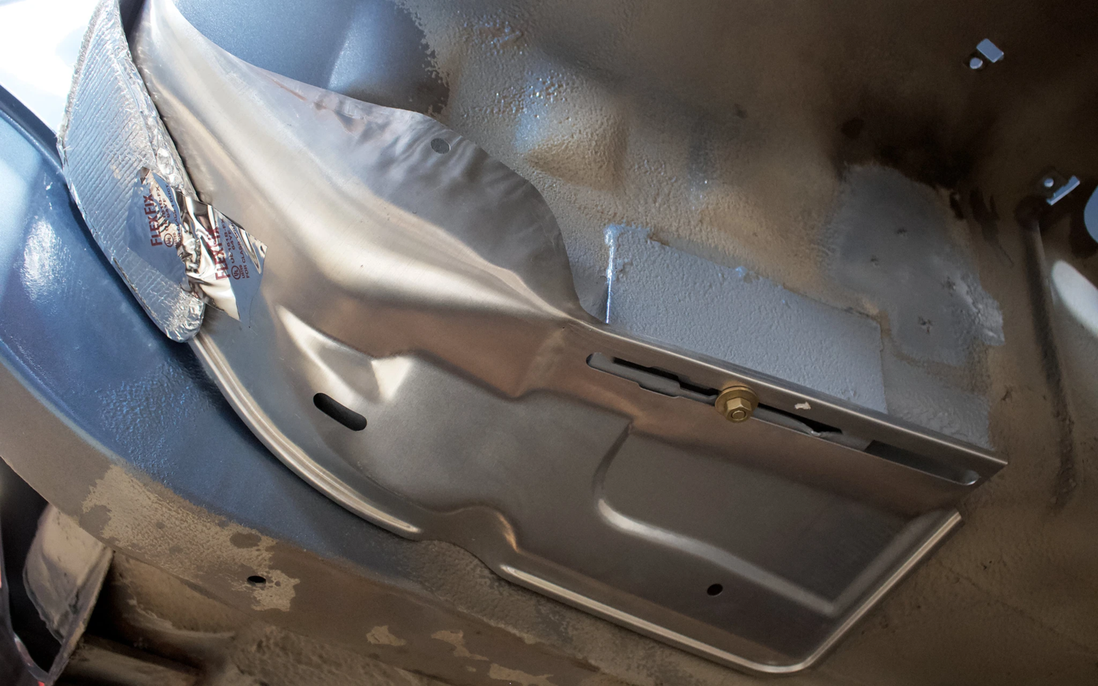

sound insulation is different than heat insulation. probably best to stop heat soak by insulating the tranny tunnel (inside and out) to shield the temp from the exhaust. the first thing to consider is this heat shield where the exhaust goes under the firewall. this is a pic from Coupeking's website. this is a BMW part that is not expensive and is used in conjunction with the firewall insulation ... which is NLA from BMW. you can buy an aftermarket piece from Coupeking or CS Werk. what i like about the Coupeking piece is that it extends down to give better heat protection where the exhaust goes down.

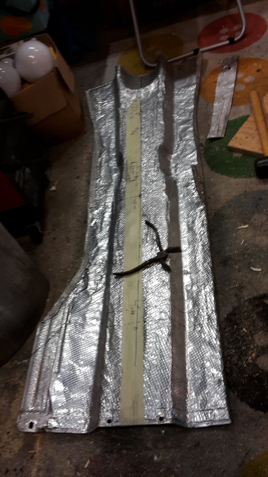

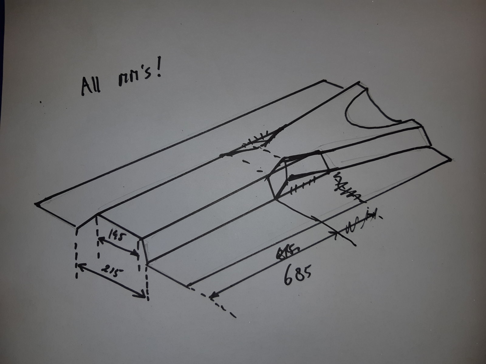

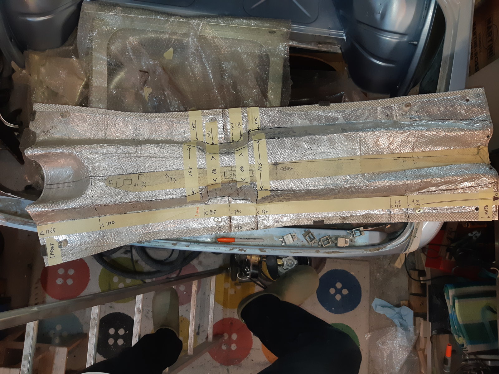

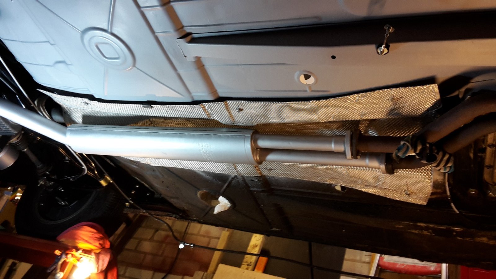

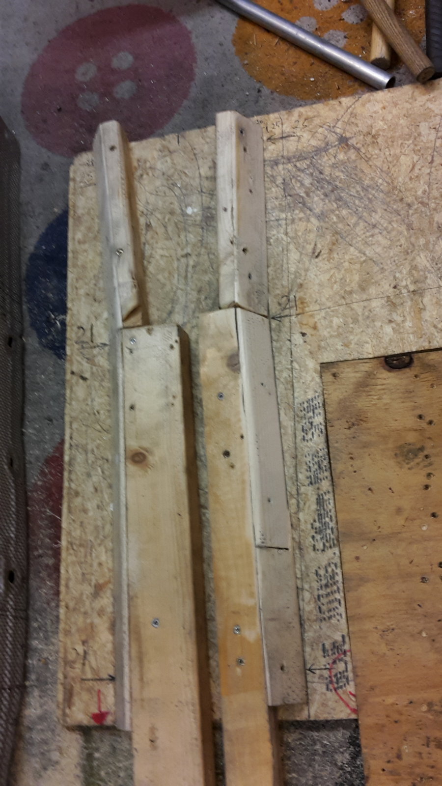

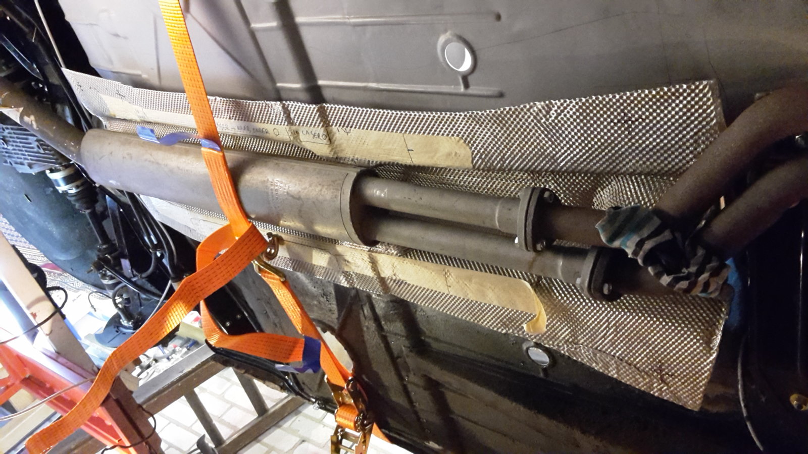

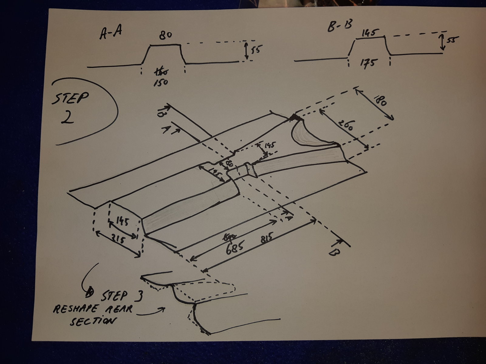

We'll you may be referencing to my attempt at solving the heat soak. I made this heatshield out of an E60 part. As i haven't driven my car yet, i can't say how much difference it makes. I als have the part that RSPorsche mentions; I'm sure that will also make a tremendous difference; perhaps even the same amount as the large shield I've added additionally.

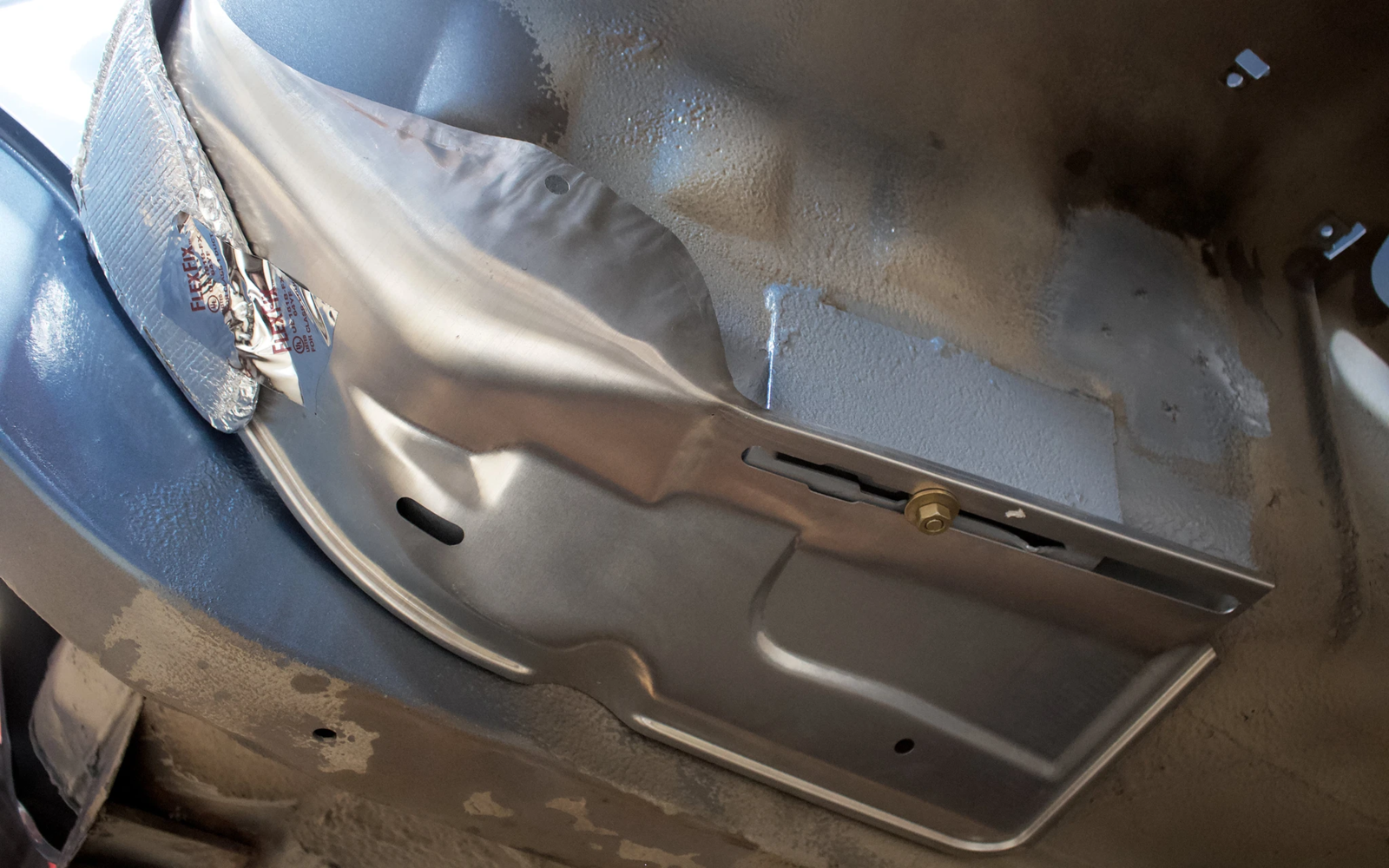

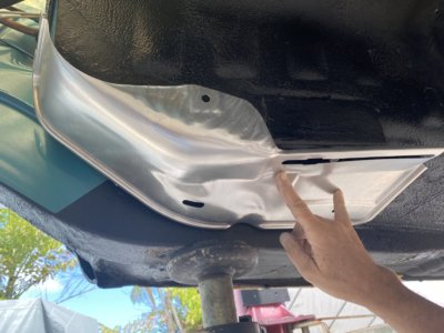

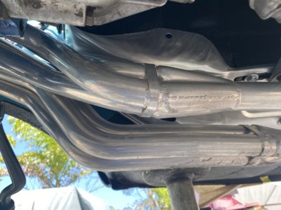

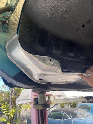

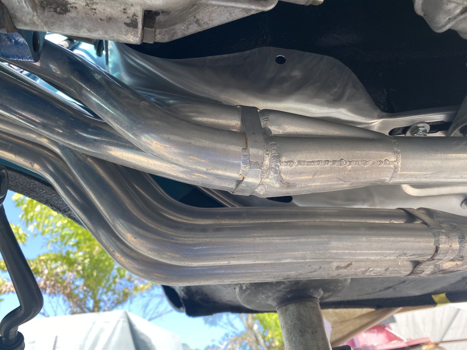

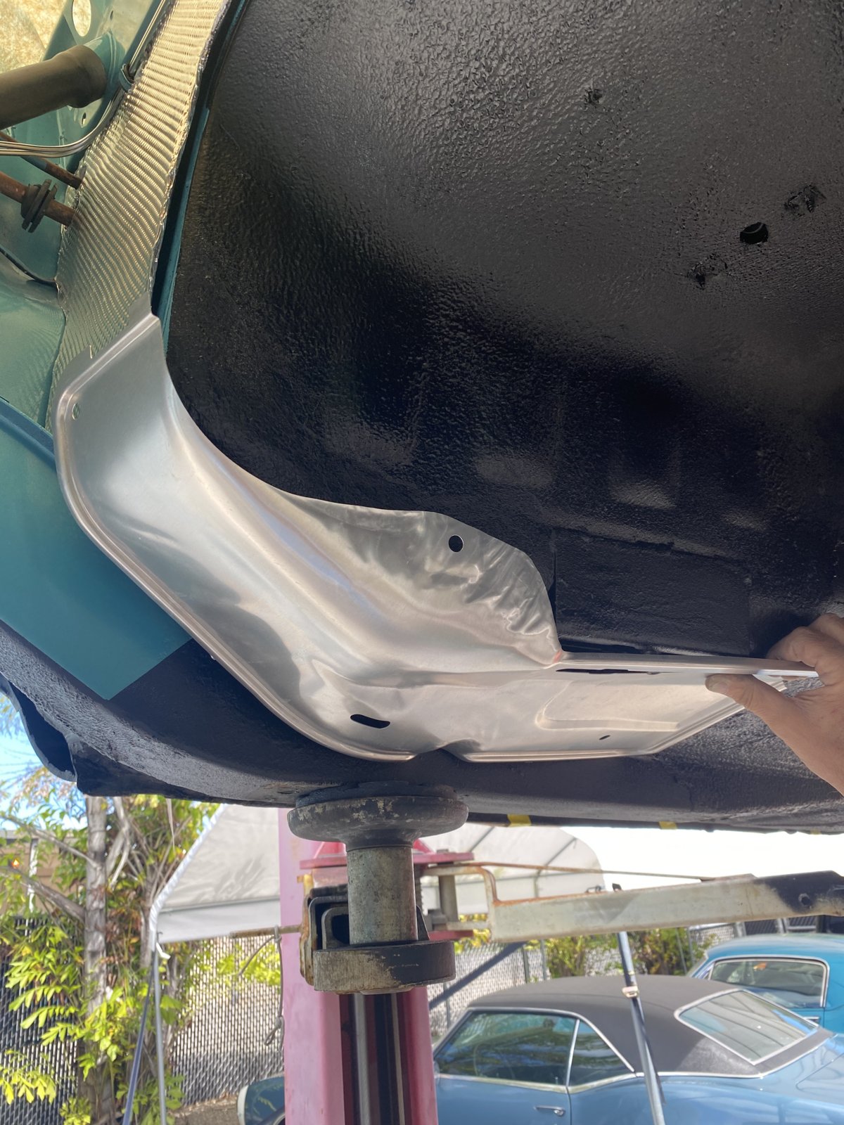

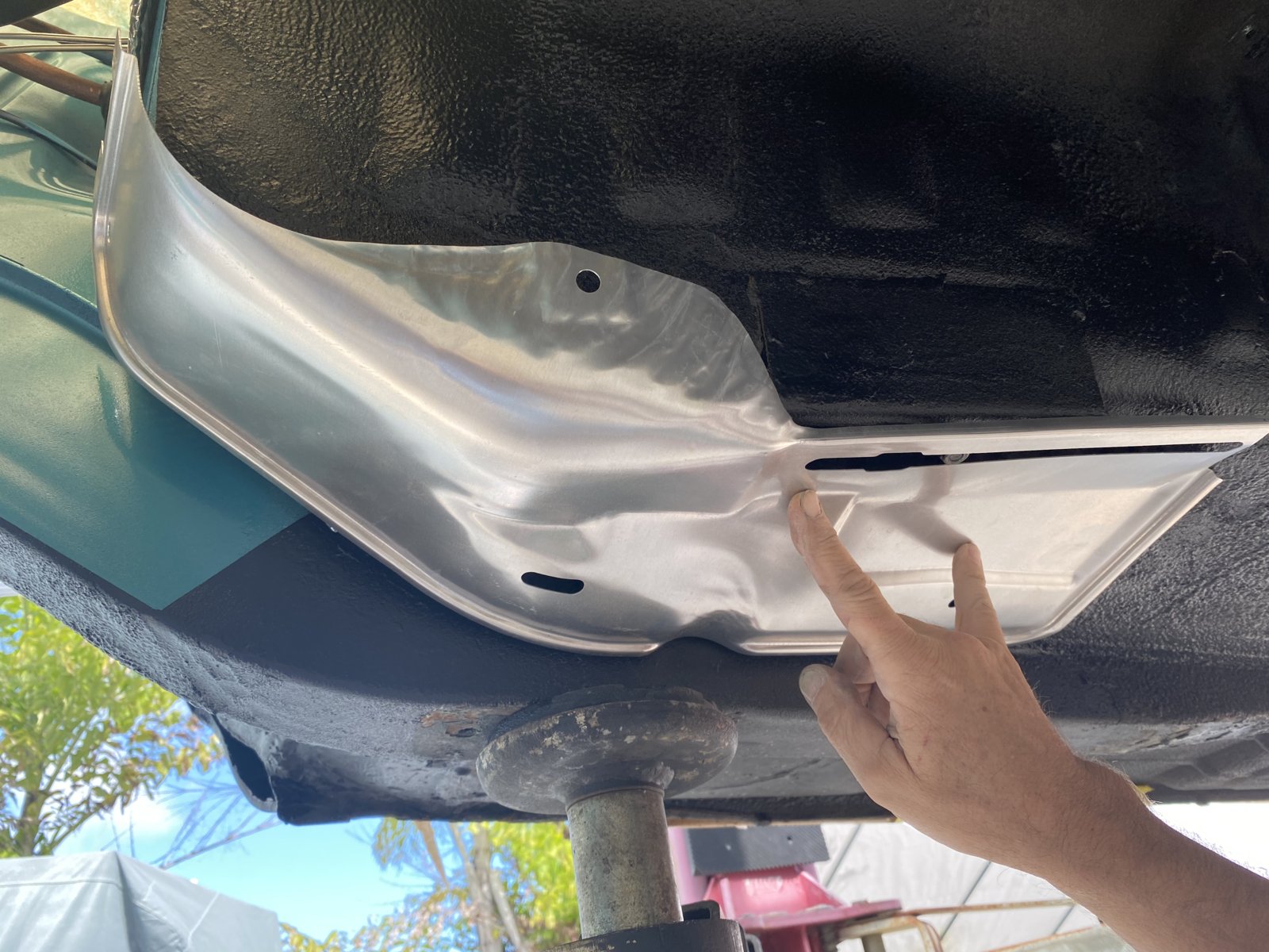

I have the Coupe King firewall insulation and the tunnel Header metal piece installed. They seem to keep the heat out from below. The metal plate needs to be secured with weld nuts. I have extras if anyone needs them.
