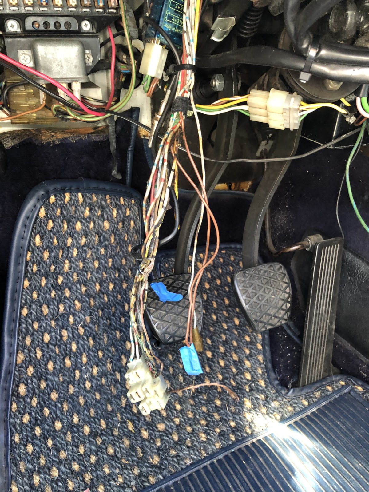

John - When I found the melted portion of my fuse block, and the melted wiring behind it, I thought I had found the bulk of my problem. However, I also discovered melted wiring at the ends of each of the side light circuits. So, my recommendation would be to check the other end of each of your melted wires.

Yeah..good advice. I will do this! Daniel Stern. Good guy. Thanks for the link.
