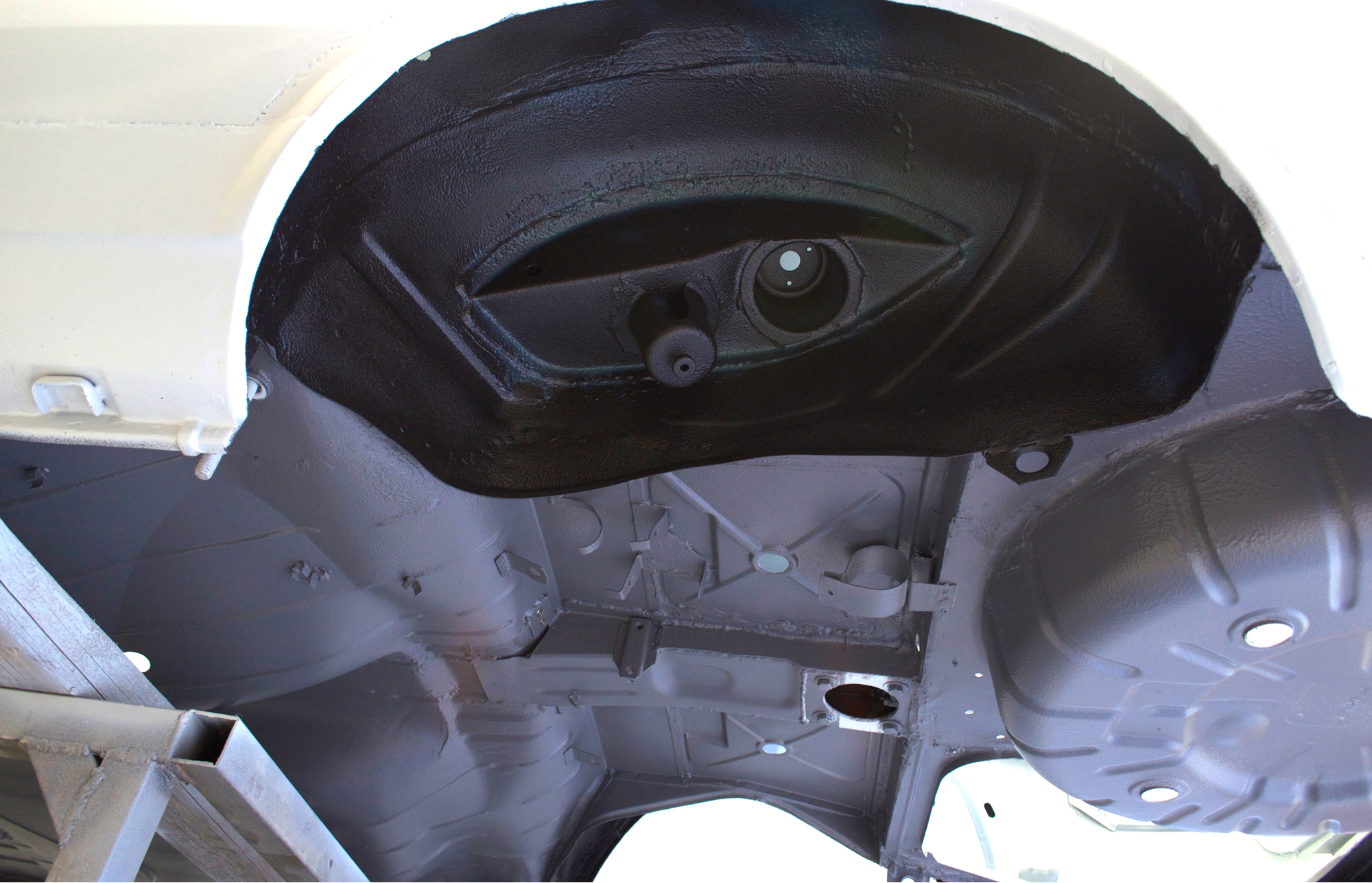

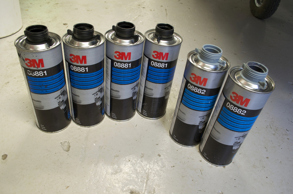

I used this water-based 3M product and I'm happy with the result, I used gray on the floors and black in the wheel wells.
